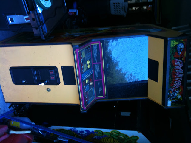

As if I don't have enough projects, I grabbed this POS yesterday.
Notice the buzzer button on the front. =)
I'm just not one to walk away from a color vector, no matter what the condition.
Testing the board in my Space Duel provided a quick glimpse of the Gravitar Logo before going black. So the board has problems, naturally.
The monitor is a mess, and the power brick and AR need rebuilding.
The best thing this has going for it is the cab, except for being painted orange, and missing a chunk here and there, it's in decent shape. =)

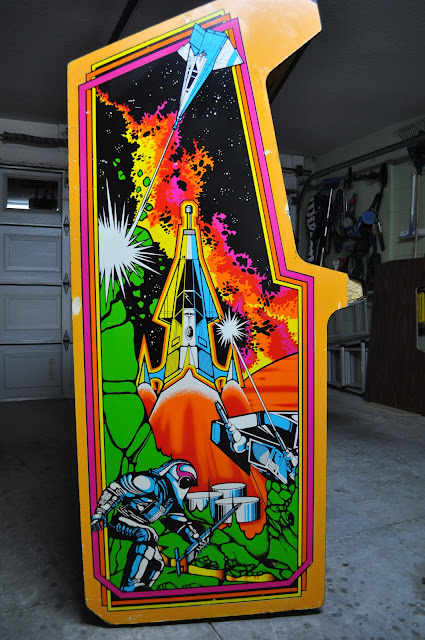

So I finally get to look at the Gravitar tonight after work. I busted out the Simple Green and the Magic Eraser. Im happy to say that most of the crud that was on the artwork came off and it's in nice shape.
Also the door bell had to go. Sorry.

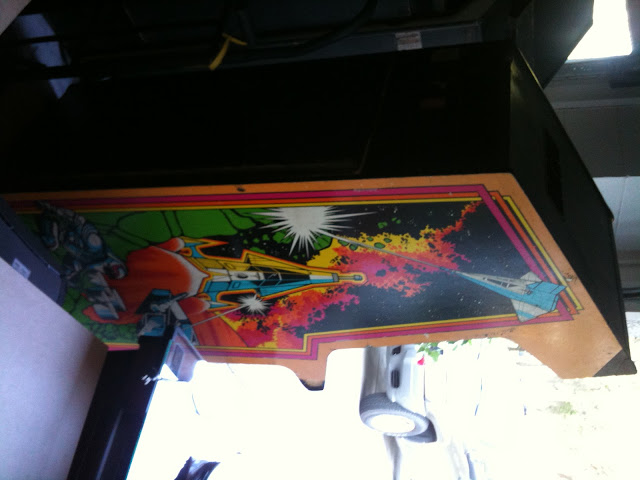

Here I go again. I have this Gravitar, and the artwork looks good, but parts of the cab are nasty. After seeing some of the work Phet did replacing corners I decided to give it a try.
I used a tracing bit on my router and made two copies of the front control panel portions of the cabinet. One side had a large chunk missing and the other was cracked and bent outwards. I did the same for the top two corners near the marquee. One side had been patched with some kind of putty and it flaked right off, and the other was splintered and smashed. This photo doesn't really show the damage very well.
I used a circular saw and just hacked the damaged corners off. It wasn't a very elegant way of doing the job, and the cuts were a bit mangled. I then matched the two pieces up and used the biscuit joiner to attach the new corners.
Sorry for the poor photo quality, I was using an iphone. Anyway they all turned out quite well, I think with a little bondo and a good deal of sanding they should be looking fresh again.
