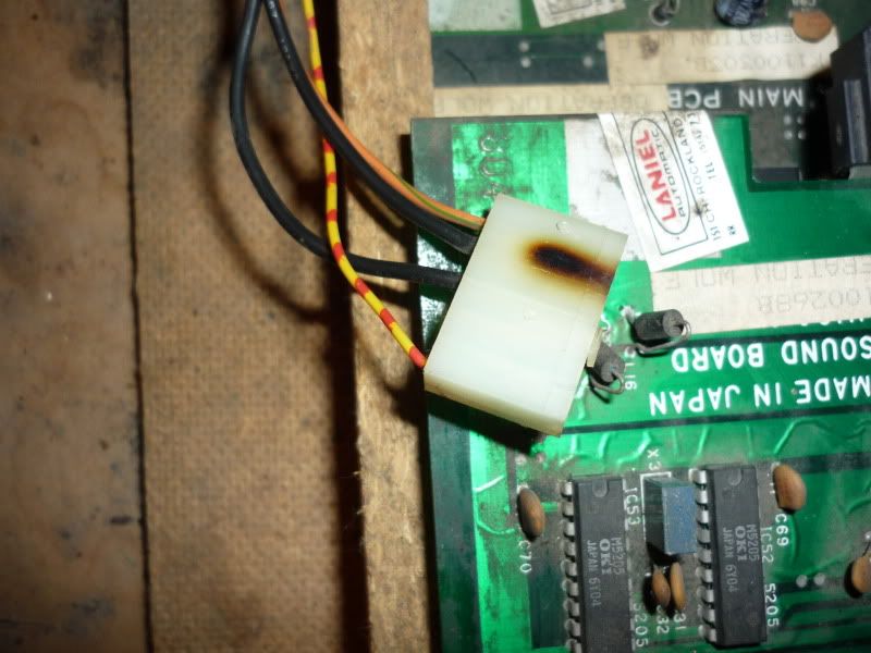

Upon further inspection tonight, I found the following connector that seems to be burnt in one spot, it's the one that plugs into the Auxilary PCB. Should I look to replace it or leave it? I believe the harness from Chase HQ and Continental Circuit should be the same but I'll have to see if I even have a spare.
you can get that connector from many places. Also check for burned or corroded connectors to the plug to the maim pcb. When i had an Operation Wolf that would not turn on sometimes it was the main plug to the pcb burned that way. luis
