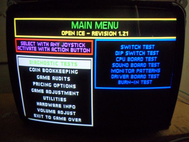

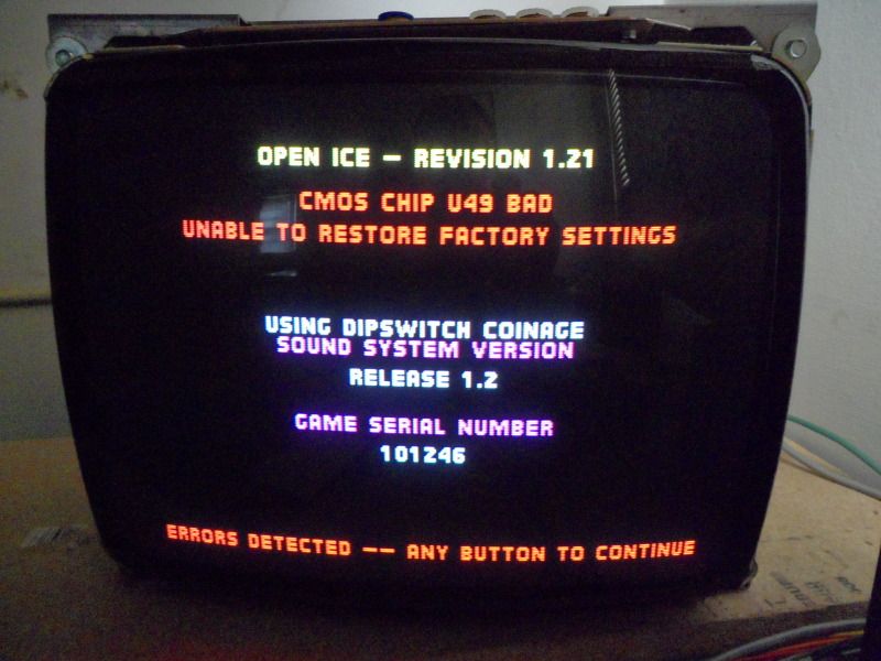

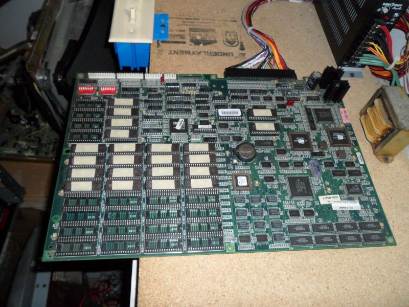

Greetings. Ok, long story. I got this Open Ice PCB a while back because it had a bad CMOS chip. I removed everything from the board and installed it all in another board. SAME PROBLEM! So I removed everything again and put it all back in the original board (the one in the pics).
Now that I know it's not the CMOS chip, it stands to reason that it's something else not associated with the board itself. Don't know what would cause it, but I am thinking it's something to do with the revision roms or the security chip. Whatever it is, it causes the board to register as having a bad "U33 Custom Chip" and "Bad U49 Unable To Restore Factory Settings."

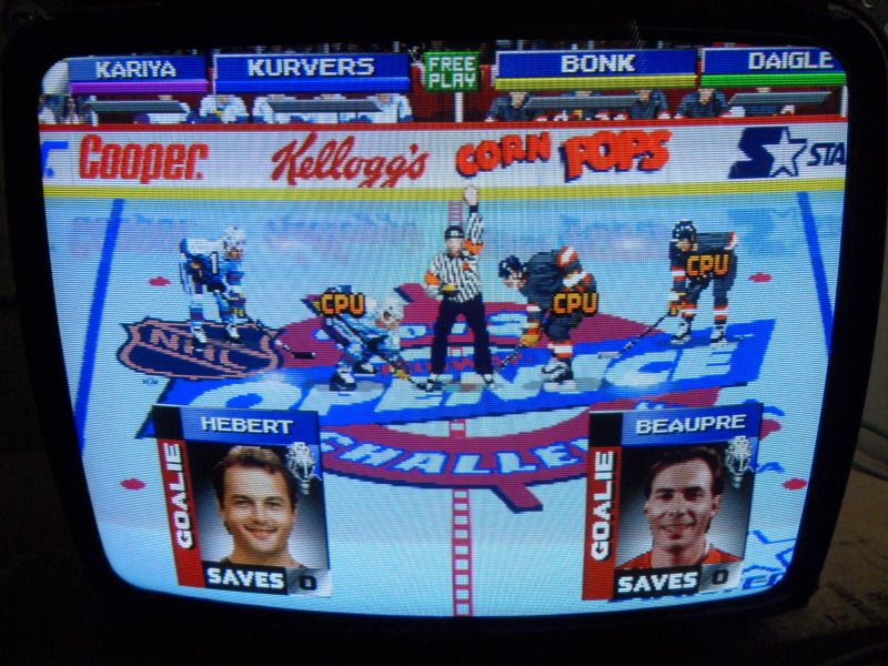

The game is on Free Play via the dip switches and GAME PLAY IS 100% GOOD! I played it for 30 minutes and didn't notice a single thing wrong with it. There's something in the chips that's making the game register a bad U33 and bad U49 because like I said, it's the same issue when I install all the chips in another good, tested board. To go the full route, I installed all the chips from my Rampage World Tour in this board and it was all good with NO errors.
