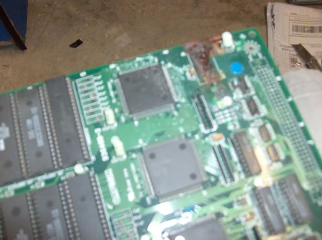

got her home new installed new power cord fired it up and lights are on but shes brain dead just got a green screen
soo upon removing the cart i noticed that it sounded like a skittle was rattling around inside hmmmm
opened her up and found this
2 weeks and 80$ later i recive my burner and eprom eraser
so today i clean all the old bat acid of the mobo
replace 2 caps that were pretty much turned to go by the acid
fire up my pc open mame and locate the phoenix files (ps i have heard people say that the mame files are not correct well for xm vs sf they are )

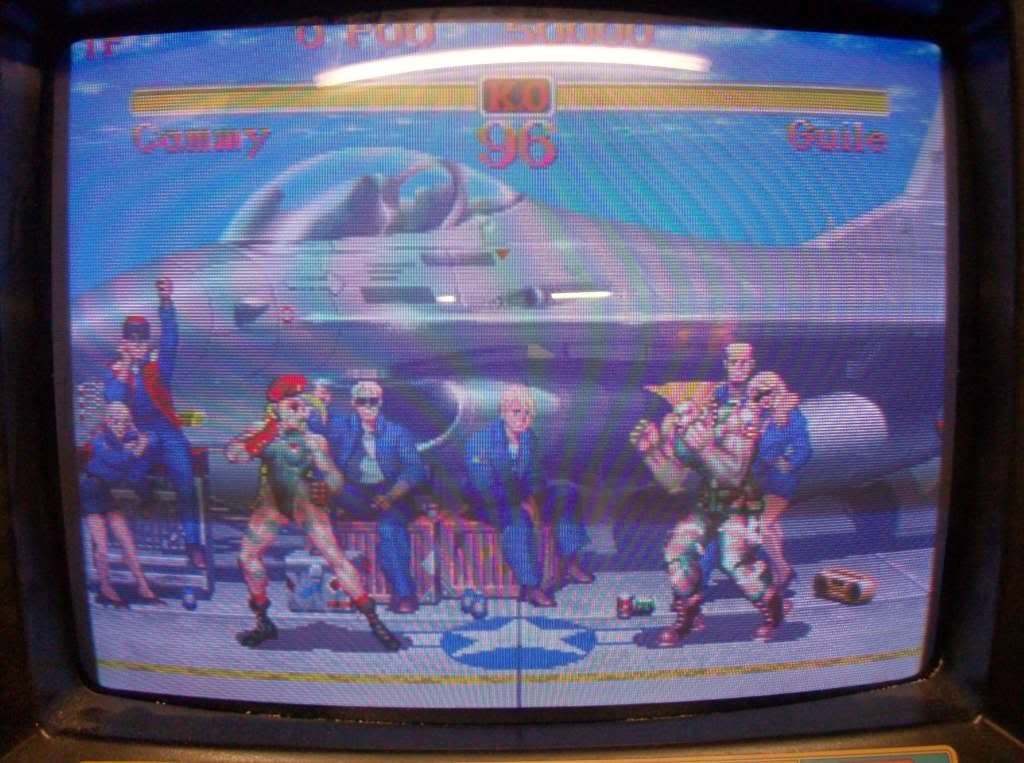

and bam after 2 week's of being stuck with crappy xmen cota and simi ok darkstalkers i finaly have a fun cps2 game to play in my dedicated cps2 big blue

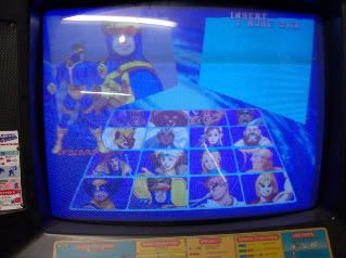

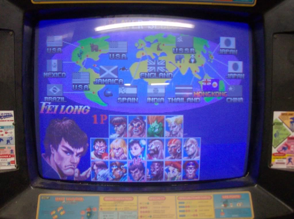

and yet another cps2 board lives
scored this for 10$ (+10$ shipping) on feepay
listed as non working
just arived today
5 mins of burning new chips and bam
