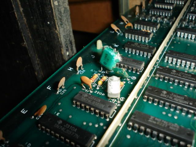

ok my mario wide body i just bought has a problem with the screen rolling up and down (vert)
after digging into the game i have found i can get the monitor to steady but the picture is off center
(bottom of the screen is in the middle of the tube)
my monitor pot seems to be fine i have tested it and again like i said i can get the screen to steady but have the above mentioned problem with screen pos
the horz pos pot on the boardset does function but my vert pot is totaly unrespoonsive
after inspecting the board set i found this cap at location c3 on the vid board
the manual lists it as a 0.1 uf 50v film cap

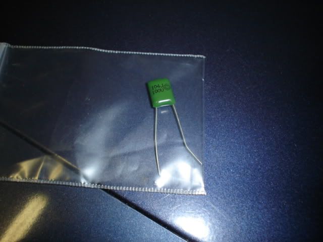

i wne to the local elect supply and they said they did not know what a film cap was but they gave me this 100v mylar cap and said it would work
it has the numbers 104j on it but does not list the uf can someone confirm that this cap will work and that is the correct uf
and also do these caps matter on the poliarty and if so how do i tell wich leg is what

That cap is non polarized which means it doesn't matter which way it goes in. As for Bob

thanks dokert and gregatron it seems it was that cap used my new desoldering iron removed the old cap installed the new one and bam my vert pos pot now works and im able to get a non rolling screen pots all seem to be nice and responsive
