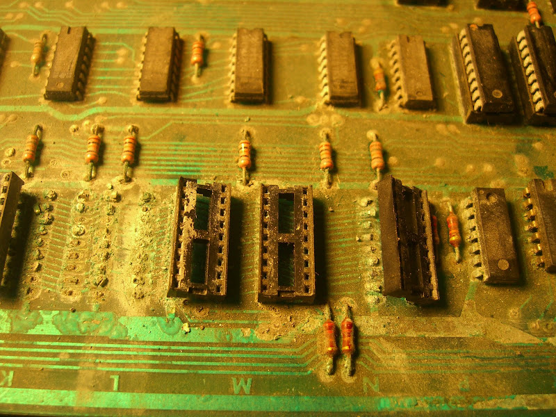

So I picked up an Omega Race in November and have been slowly coaxing it back to life. I knew this would be a huge project, but that's kind of what I was looking for... something to tinker with and learn how to troubleshoot. Plus it's a great game that I played a lot when I was a kid.
The motherboard had the typical acid damage:
I cleaned the board up as best as I could. The worst portion of acid damage had destroyed several circuit board traces:
I installed new sockets for the RAM chips and added jumpers to fix the circuit board traces. This is kind of ugly; it was my first time doing something like this.
After doing all of this, the board was still completely dead. At that point I noticed that the crystal was missing from the board. After replacing the crystal the board came back to life. I replaced a few more acid-damaged chips, added some more jumpers, and got the board to the point where I could coin it up and play it blind. This was huge for me; I think I probably picked one of the most troublesome games on which to learn PCB repair.
Unfortunately the self test is reporting RAMs 10 and 12 as bad, and I can't figure out why. I've checked all the address and data lines for continuity and I can see them pulsing with a logic probe. So I'm currently stuck on that problem.

I feel like I need to figure out why I'm getting RAM errors before I do anything else. I should clarify that when I said the self test was reporting RAMs 10 and 12 were bad, what I actually meant was that I'm getting 10 beeps, and then 12 beeps. According to the manual this corresponds with video RAMs 2 and 4, which are chips J-1 and/or L/M-1, and J/K-1 and/or N/P-1.
When I remove RAMs J-1 and J/K-1 I get the same error... this leads me to believe the problem is with those chips. Not sure if that logic is valid.
I've double and triple checked the continuity across the address and data pins on all the RAM chips, and I've checked for shorts. I'm having a hard time finding the problem. How likely is it that the problem is with a chip downstream from these chips?
I had same beeps...
First, switch the RAM around with ones not showing up in the error codes. If the codes change then you know the RAM's were bad.
Next notice that although the leads from RAM to RAM on the board look exactly the same the pattern actually changes slightly. That's where my 10/12 error was. My acid damage was so bad that some traces were totally gone. Attached is a photo I took from one of Omegaman's posts. You will notice the pattern changes slightly between the RAM's. Use this to make sure you didn't jumper some pins that should actually not be connected.

Scott, thanks for the help. I went back and checked my jumpers again and you were right, there were a couple of mistakes. I fixed those and had it down to just 10 beeps (video RAM 2). Then I continued to mess with it, and of course I made it worse. Now I'm getting 10, 13 and 14 beeps (video RAM 2 and video ROMs 1 and 2). It's kind of driving me crazy.

your last photos
On a quick glance at your last photos here is a couple of spots I'd check. They look like they could be touching the traces under the jumpers.
Not only that but it looks like you bridged the solder pad to the trace next to it on the red wire in the upper right corner of that picture.
Wow dude, good eye! The third connection that you circled was shorted. I had just re-done those around 1am last night. I fixed the short and BOOM, it now passes the self test! Thanks so much for taking the time to look at my stuff.
