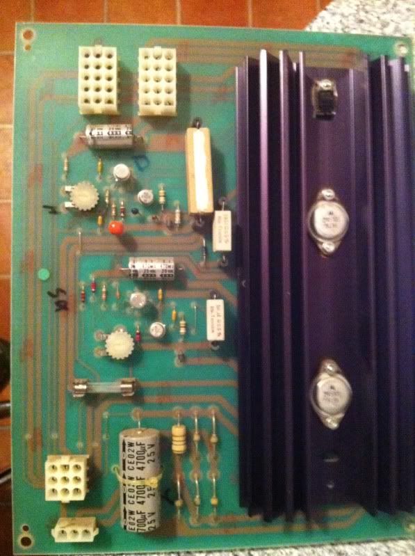

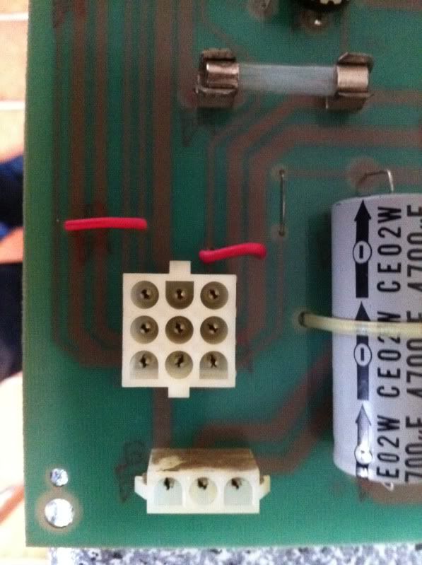

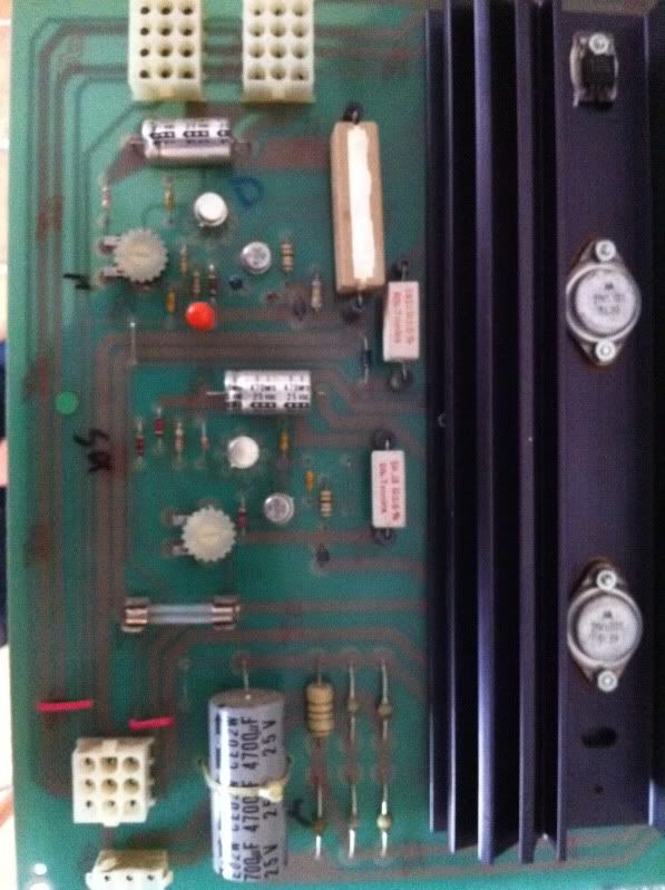

Right this set is all done now, The boards have been running fine for hours. I checked the power PCB over and modified the sense lines. See below for before and after. It's very easy to do, only 2 links to install....the holes are there already.
Once you have the links installed you can test the +5v and +12v with the game boards unplugged. If you set the 5v line to 5v then reconnect the game board and measure the voltage level at one of the IC's on the board, adjust the 5v until you have 5.1v or thereabouts.
sense line mod
Granted I didn't take the time to look at the schematics closely after your post so please forgive a possibly dumb question...
Instead of installing solid wire jumpers, could you install resistors, say 100 to 220 ohms or so, and achieve the same goal of being able to measure the outputs without the boards connected? If yes, then the sense lines would still work as originally intended and the boards would still get exactly the same voltage that you set before they were connected. This would eliminate the need to measure voltage levels at the boards and re-adjust.
Bill B.
Hi Bill
I don't see why not. I used zero ohm links as I didn't see the need for any adjustment of load once the correct voltage has been set. I doubt there would be same issue as the Atari games as Midway fitted better connectors at the board, it's more of a "better safe than sorry" approach :)

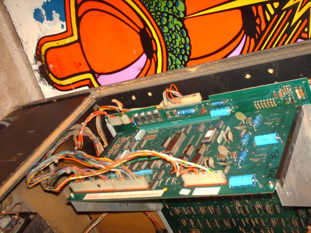

Got the boards back in the mail today. They look great. Thank You!
Minor issue though.. In my haste to remove the boards and cut off the
battery I neglected to take pictures of how everything was hooked up.
It appears most of the connectors are not keyed that plug into the
boards.
Anyone have a set of pics of the boards hooked up so I can see the wire colors?
Thanks,
Mike
Here is mine, I hope you have better luck than what I just had happen with my set :(
That's my original board there before I started. It ran for years; I gave it new caps and sorted out the other problems with my game before I wanted a backup set. I posted a bit on my backup set, what rotten luck I had.
