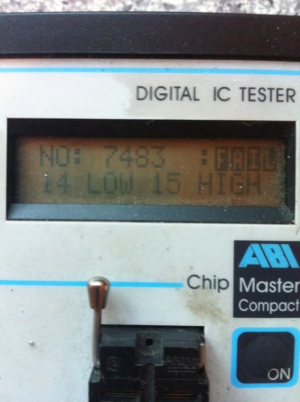

More progress on this today. I had fitted some nice Texas instruments sockets for the Ram, I kept getting random Ram errors. I checked out the continuity between the ram and the data/address lines, the sockets were good but for some reason the IC's weren't making good contact in the sockets. I ended up pulling them all out and fitting a different type.

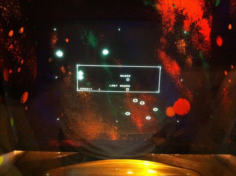

Still no change to the graphics problem.

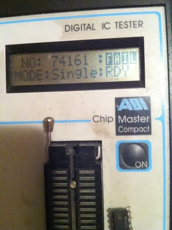

I removed 2 74161's from the Vector timer section @L2 and M2, they were both dead
The graphics problem is getting better!
I'm going to pull the 3rd 161 now and see if that sorts the problem.
