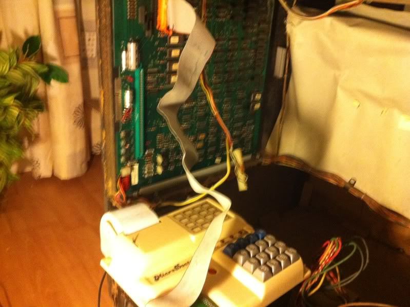

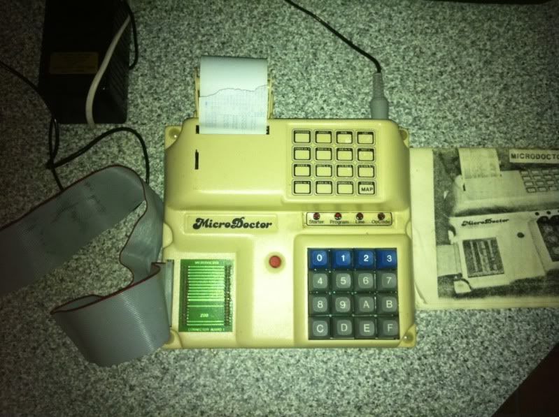

Microdoctor? Got a link? How is it better then a fluke? I'm thinking about picking up a fluke.
Better than a fluke? No it's not as flexible. It's designed around z80 based systems. There was meant to be other Roms released for different CPU's but I have never seen one. Where would you get one? I've never seen or found any info on one, probably only a couple in existence.
Very easy to use, you remove the z80, plug in
The pod then choose a pre programmed test...ram/rom/address-data line check/disassemble/checksum/ io read/ io write/ auto memory map/ plus more. You enter a start address and finish address on
Most tests unless you ask it to auto map the board.
You can print memory contents in hex/bin/ASCII or assembly language .
Sorry for the poor layout....bloody iPhone :)

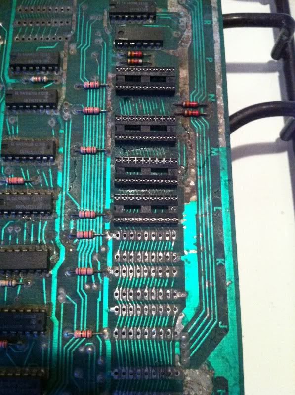

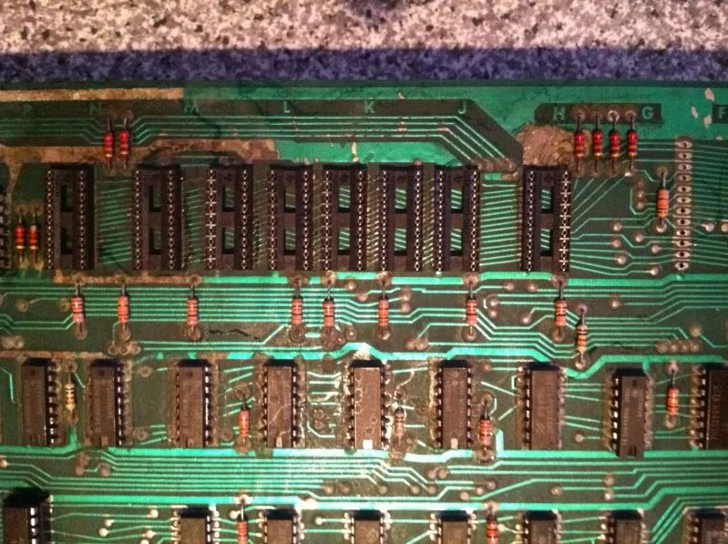

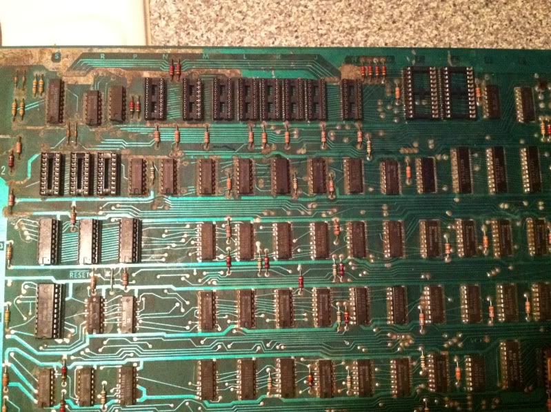

Another thing to remember is not to try and scratch the crud off the board, the traces are very thin at points between the solder pads and easily damaged. Use a toothbrush and chemical cleaner, .
What type of chemical cleaner do you use?
I use a mixture of lime scale remover / strong surface cleaner and a toothbrush.....just make sure you keep an eye on it and give it a good wash afterwards, If you stick it in the dishwasher remove the IC in sockets and de-solder the X and Y pots, or add switch cleaner to them afterwards.
You really need to remove any areas of the green mask that has lifted.

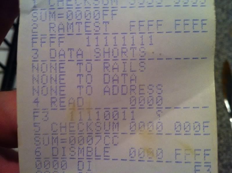

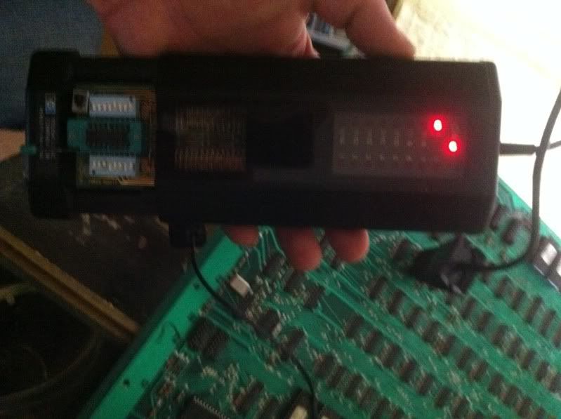

Right, time to run a few tests.
I should see this when running a shorts test

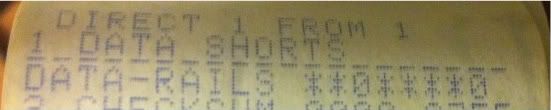

Unfortunately I get this
This means data line 0 and data line 5 are shorted to ground, if it had shown a "1" that would mean shorted to Vcc.
I took a look at the schematics, the program rom's and rams are tested good so the only thing left on the data bus was the 74245 at S1....this is the buffer for the video ram and rom. I removed the chip and the game now boots but obviously reporting bad video ram and rom.

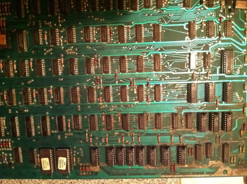

Just one trace so far, on row 2 right between 2 legs of an IC where the trace goes very slim. I noticed it when I was inspecting the board over a bright light.
Yes the bubbles were just the mask lifting.

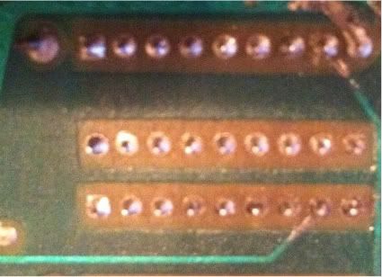

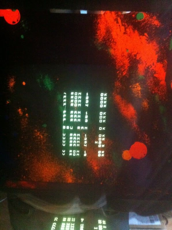

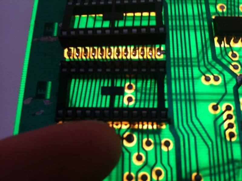

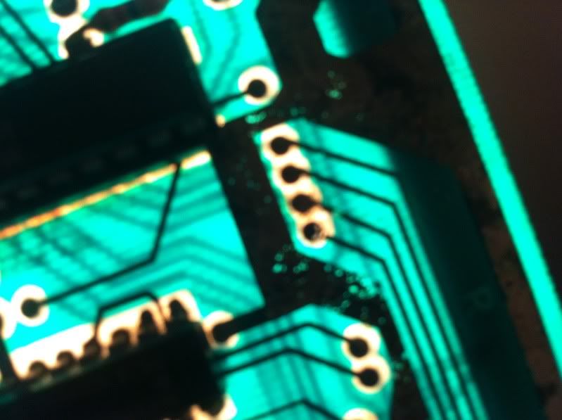

Update for today. It's nearly there now. I had a problem with an address line on the video Ram/Rom being shorted to +5. from looking at the board I could tell it wasn't any of the Ram sockets as the trace from that pin didn't run past the +5v line. It did run past pin 21 of the Rom socket though. I lifted one side and held it up to the light...Bingo!!!
if you look at the 4th pin back from the right you can see a bridge to the address line.
The next problem was a missing data line to the Ram, again holding the board to the light showed me where the problem was.
not a very good photo but you can see the break on the 3rd trace down on the right of the photo.
Now I get video!!!
I just need to figure out the Ram issue now, the chip is good so I guess there maybe an issue with the solder on that socket.

I knew the address line was stuck high by using a logic probe, there should have been activity on all the lines but 1 was static. I checked with a multi meter and sure enough it was shorted to Vcc. The video address lines emanate from a few 74157's so I removed the chip in question and tested it....it was fine so I knew it had to be a problem with one of the sockets as the video address lines only run to the Ram and Rom.
I guess it was a bit of solder or corrosion I missed on the clean up.

Dental tools (picks) are great for clearing bridges on traces like the one in the photo.
