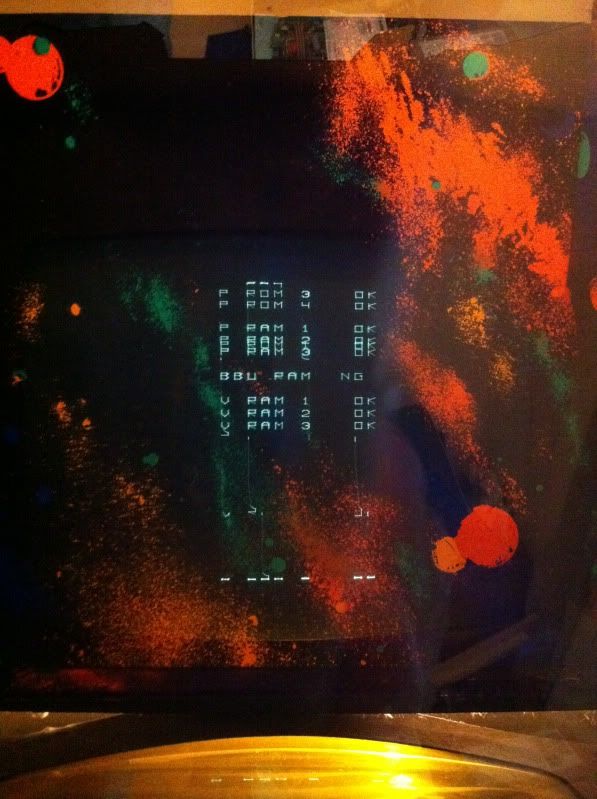

Back on the OR PCB.
I found a bad transistor in the Z output section.....getting closer!

Sorry for not updating on this sooner, crazy work hours at the moment.
There is a problem in the vector timer section or associated circuits.....nearly there though. Hopefully will have time this Sunday to take another look.
