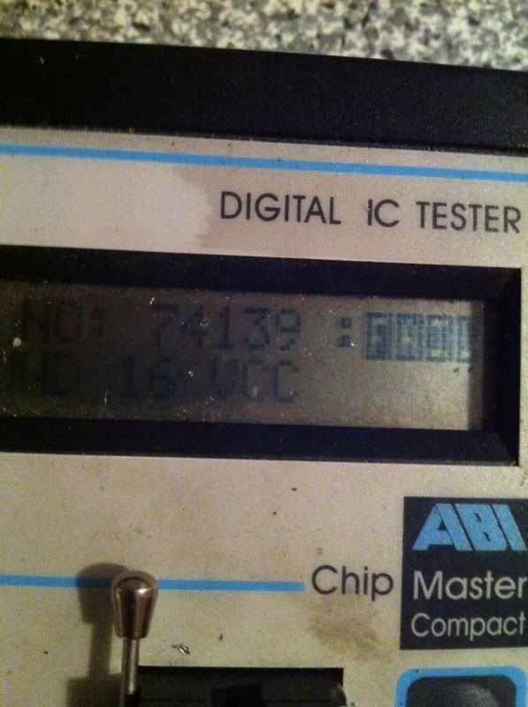

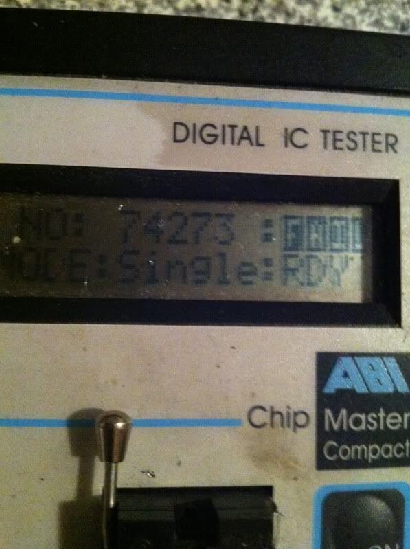

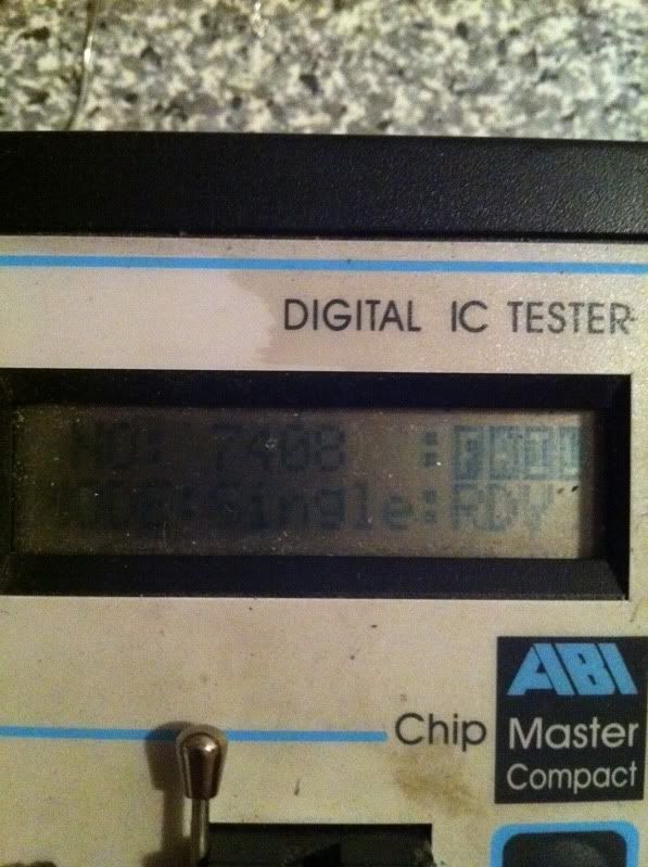

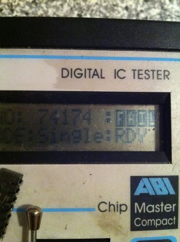

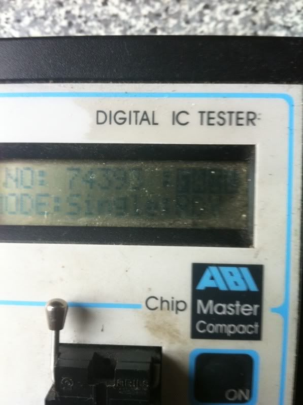

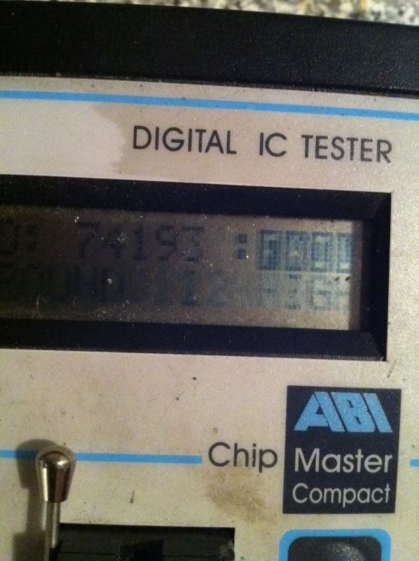

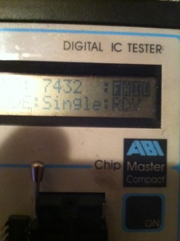

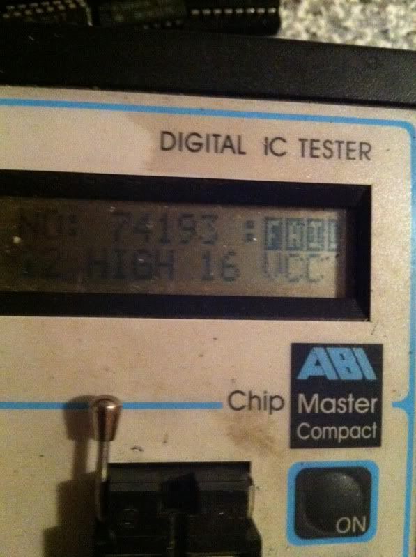

How do I find the bad chips? Again like CM said. For example, the X and Y channels are pretty much identical . If you have 4 missing inputs to a chip then either that chip is dragging them down or the one that is sending those signals has failed. A lot of the time you will see activity with a logic probe so you need a comparator to check the logic is correct (or the timing)
The state machine is the hard part because an area may look dead but really it's just waiting for a go signal. For that area I keep a section of good IC's on some anti static foam...I can quickly run through each chip with the comparator if something looks odd.
Omegaman, I replaced all the RAM myself, I got the thing to test and it told me they were bad so I changed them, hoping the game would spring to life for my trouble. After I did the test gave me the same results and I knew I was out of my league, so I sat on it hoping I could find someone a hell of a lot smarter than me that was willing to give it a go...

Yes, I changed another 6 or so chips last night......If I hadn't replaced half the board already I would have given up :)

Yes If I had to buy Chips at a normal price I would probably have to think about it. Luckily for me and for the person that owns this board...I have 3000 or so NOS logic IC's that will keep me going for years. I charge for them but nothing near the price they would be to buy online now.

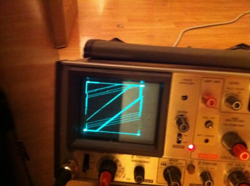

I may as well just pull the remaining chips, it's so hard to fix a board like this as everything is dead...apart from the processor side of things.
