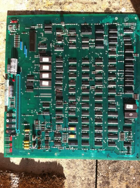

I have another set for repair, from Member GoldenAge. This one looks very clean.....but don't let looks deceive you!! :)

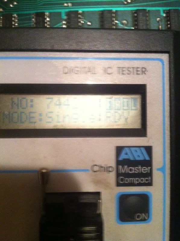

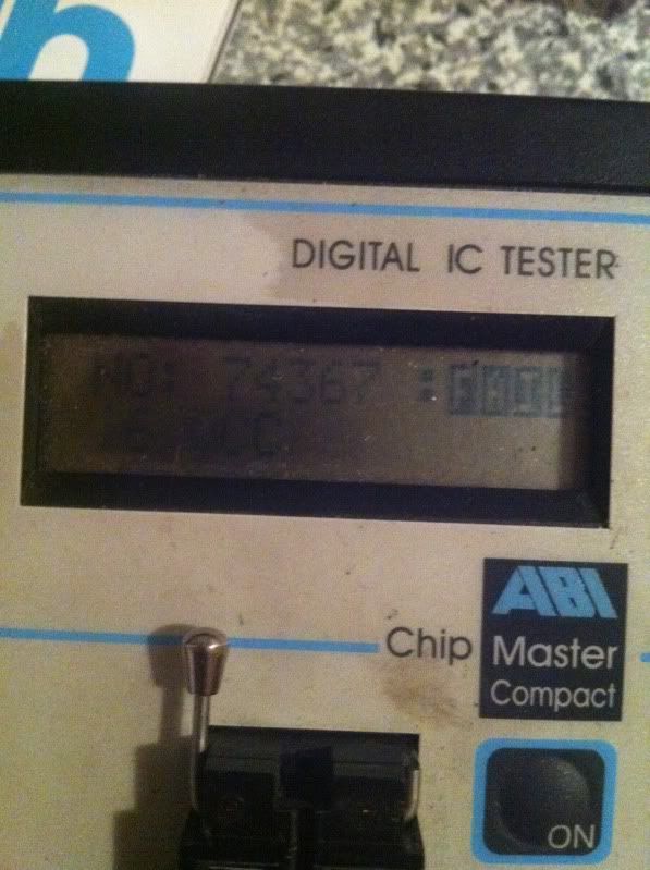

I pulled all the chips, all the Ram checked out good, apart from the BBU ram. The Roms and CPU were also fine. I could see by looking inside the sockets quite a few needed replacing. In the end i replaced 6 program Ram sockets, 1 Video Ram socket and 2 Video Rom sockets.
The board was now in a state to test
I powered the board up and it reported all Ram were bad :( I checked the program Ram, selector IC at PN2 with the comparator.
sure enough it was bad!

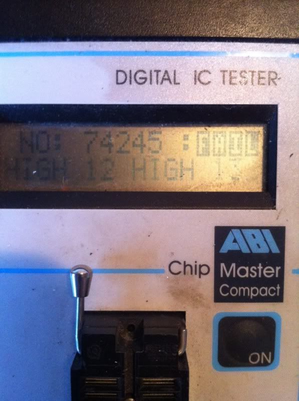

Self test then passed the program Ram but failed the video Ram and Rom. I checked the 74245 at S1 (Video buffer) and that was bad as well.

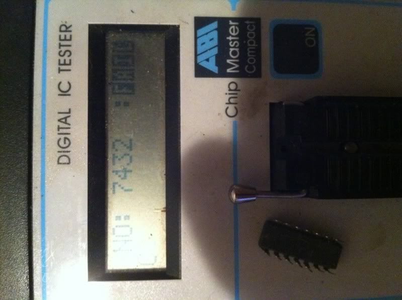

I now had the Roms passing but all the video Ram were still showing bad. I checked the 7432 at R1, this is the selector chip for the video Ram. Again it was bad.
I now had all Ram and Rom passing self test.

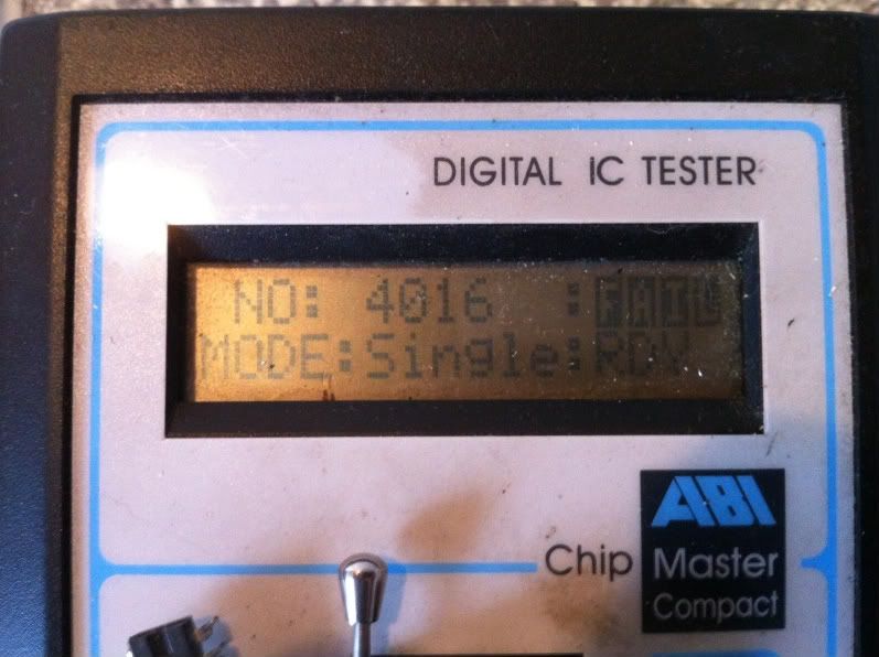

I looked at the area post DAC and found no activity on pin 3 of Op amp A8 (TLO81). I pulled the 4016 at A6 and it tested bad.
I replaced the op amps at the same time.

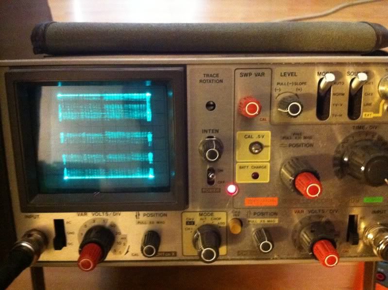

I now have activity on both channels.

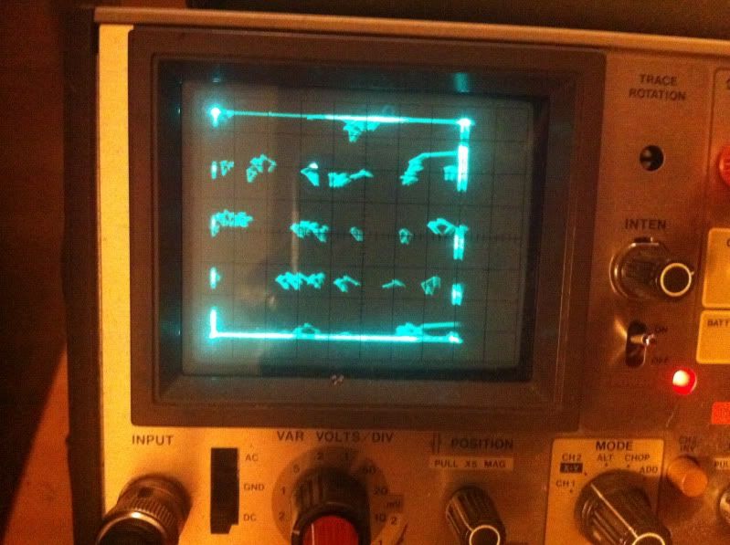

This is an image of the test screen, obviously something else is wrong....getting close though.
Man this board has a lot of problems!

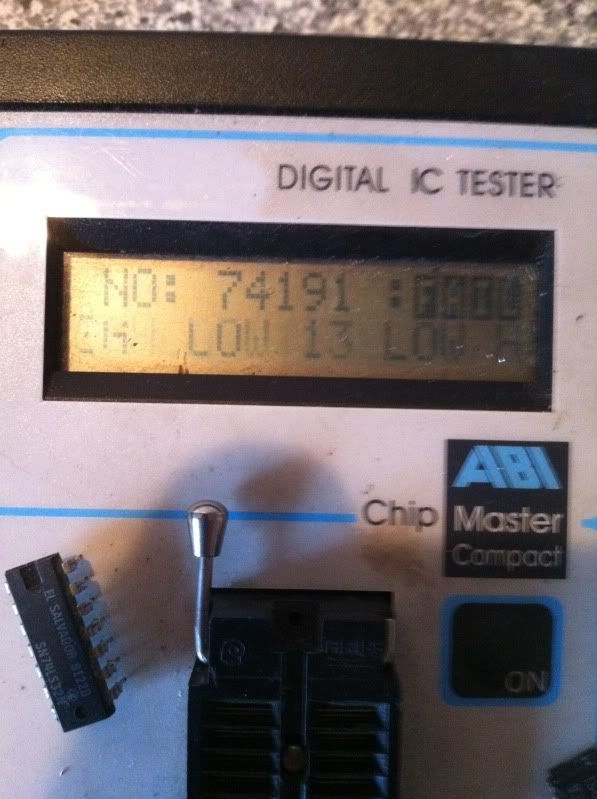

All 3 74191 counters in the X section were bad.

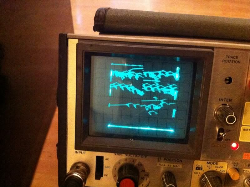

Now I get this
Another bad 74161 in the timer section was bad at M2

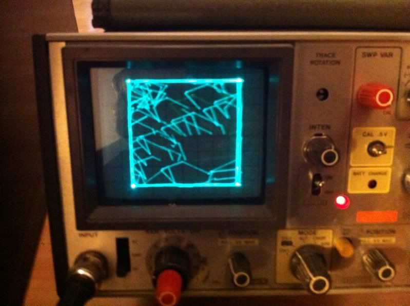

Now the picture looks like this .
That's enough for one Eve, more tomorrow.

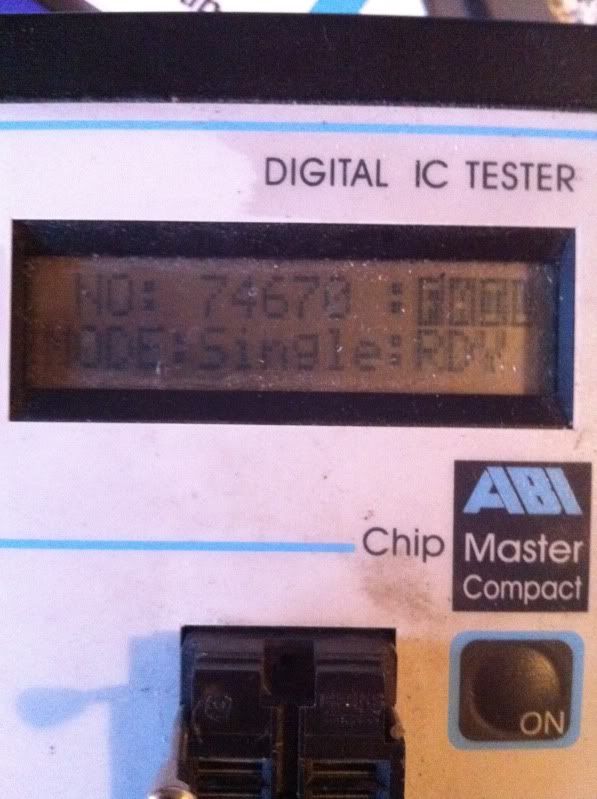

How do I find the bad chips? Again like CM said. For example, the X and Y channels are pretty much identical . If you have 4 missing inputs to a chip then either that chip is dragging them down or the one that is sending those signals has failed. A lot of the time you will see activity with a logic probe so you need a comparator to check the logic is correct (or the timing)
The state machine is the hard part because an area may look dead but really it's just waiting for a go signal. For that area I keep a section of good IC's on some anti static foam...I can quickly run through each chip with the comparator if something looks odd.
