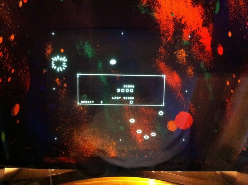

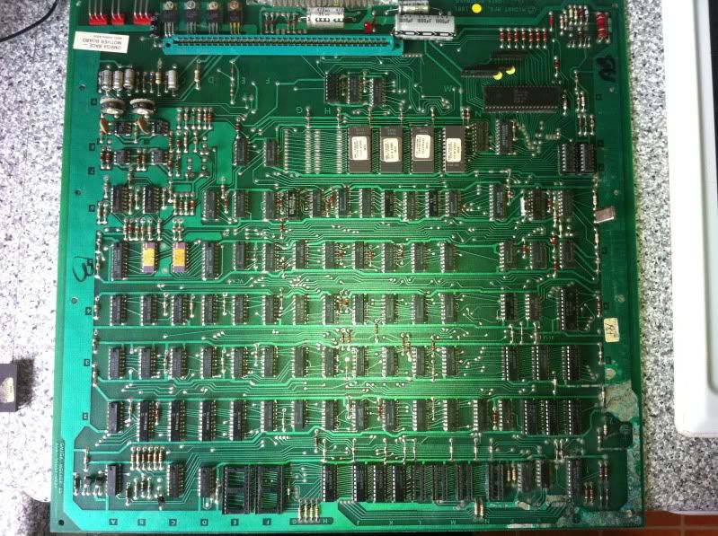

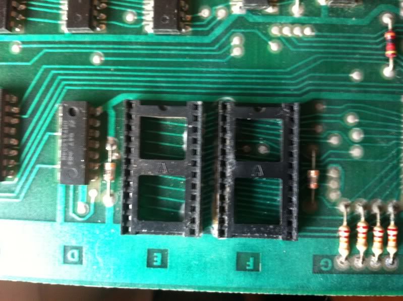

Another set turned up this weekend. The main board looks very clean but has damage to the first 3 video Ram sockets and the 2 video Rom sockets.
I will fit some new sockets and fire it up this evening.
Update on this board.
I replaced the bad sockets, you can see how bad the corrosion was under the Rom sockets.
New sockets fitted.
I then checked all the Ram, 5 were bad. Plugged it in!!

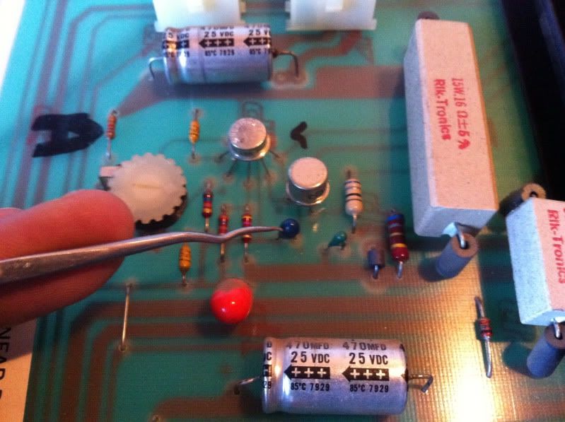

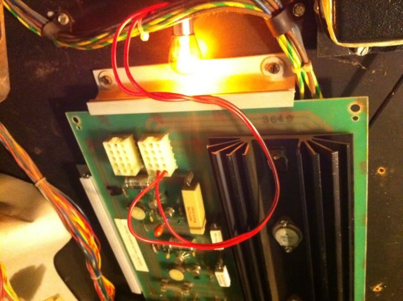

Thought I'd check the power supply PCB over tonight. After linking the sense lines I hooked it up (no game boards and monitor unplugged) The main fuse for the +5v supply blew.
I checked the PCB over and found a suspect capacitor
After removing it and testing it, I found it to be short circuit.
Everything else checks out OK so it should be fine once a new one is installed.

You reading those right? I thought they were .1uf
Try these:
Mouser Part #: 594-A104M15X7RF5TAA
Yes they are 0.01mf ceramic 50v...I take it you are talking about CP360 near the battery? I have some in my stock of components. I've not bought any recently. You should be able to find some on Ebay or Google.

The Mouser part # I supplied is a good part # for a replacement. It's probably not clear like the OEM part, but it's a proper replacement.
