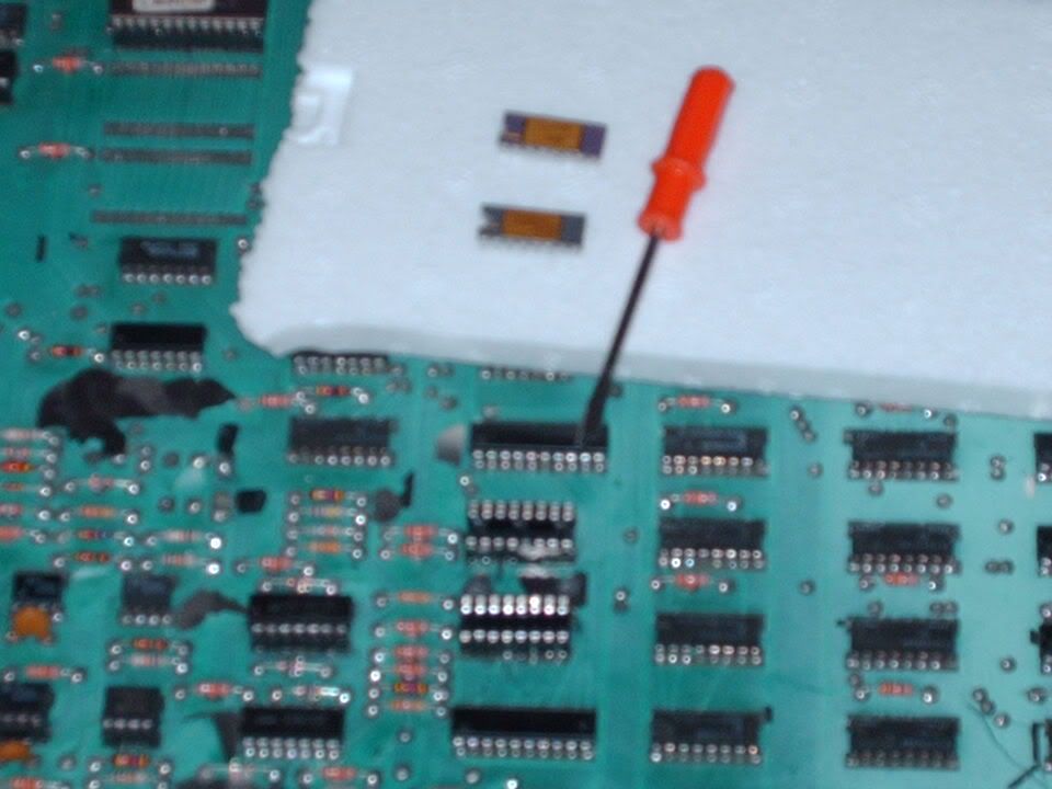

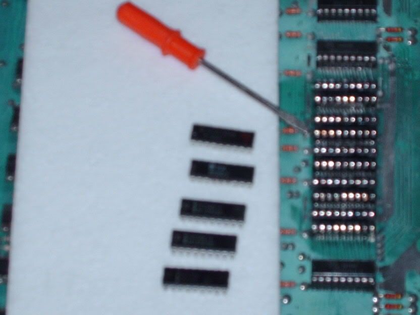

Next up, I think these are the DACS. Humm, these have short legs just like the ones on my good set. I guess they came like that. Anyhow, check!
Next, two EPROMS and a memory chip, check!

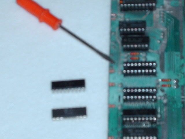

Next, a large bank of expensive RAM chips. I think these are $10 a piece. check!

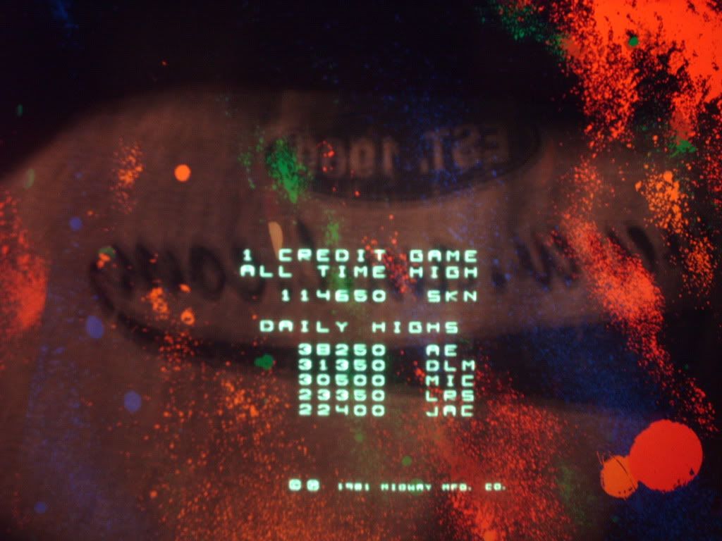

Next, my first okay game, I must be feeling better....check!

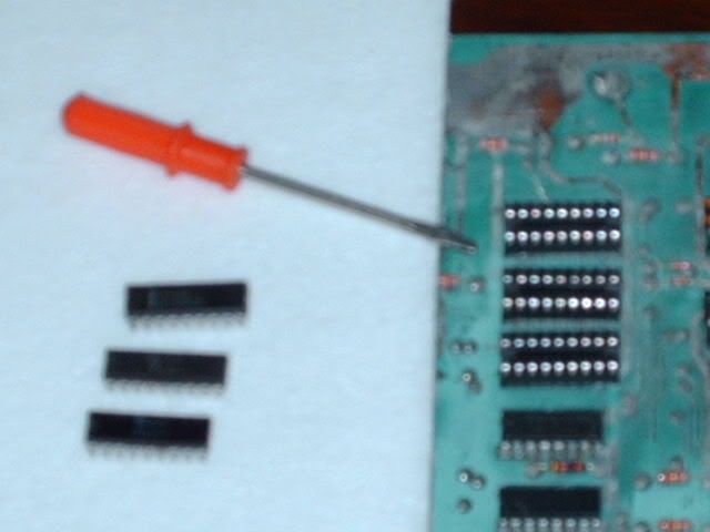

More RAM, check!
More RAM in column 2, check!
RAM and RAM control chips? in colum 3, check!

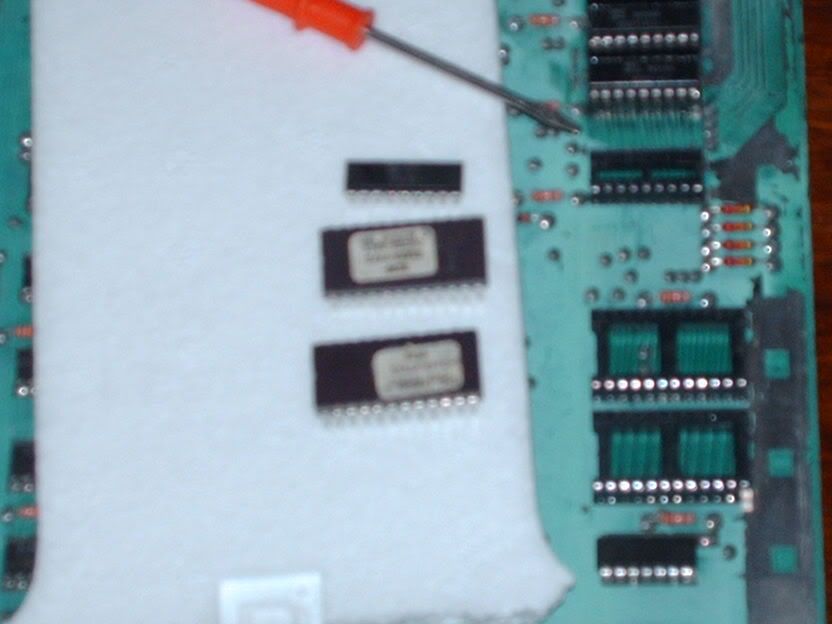

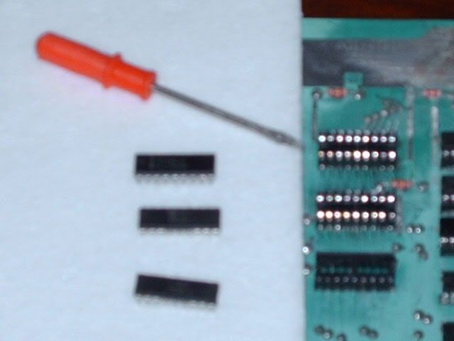

Almost done with the chips that are socketed and shared between the two boards. I'm feeling better, a surge did not kill it. Is it going to be the other EPROMs, or the Z80, or something else????

I got down the the CPUs on both the sound and main board and replaced them with other Z80s. I get full error tones in self test now. Sometimes it is only the battery backup ram, which is eight beeps in a row. Other times I got 8, 9, 10, and 11.
Zippo on the screen though.
At least now I know everything in the sockets is okay.
FIXED FIXED FIXED FIXED
I hate working on pre JAMMA stuff, I really do...turned out to be one or more of three socketed logic chips....I had spares that I had pulled off of the scrap sets that came with these. I almost threw them away....

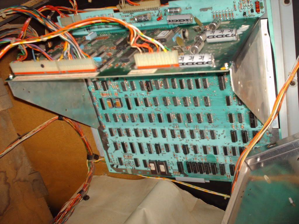

Got and installed my brackets for the set tonight thanks to a local buddy. So this scrap set is finally complete again after who knows how many years, and at least three techs working to get it going again. Omegaman did the heavy lifting by finding all the bad chips. The original tech tried to save it with new sockets but gave up and stripped the set after a trip through the dishwasher destroyed the mask. I made it complete from scrap boards, replaced broken parts (broken pots, yanked out components), paid the repair bill, and troubleshot it a bit. Now I just need to find a cocktail for it to live in and another game will have been saved from being trashed. Good feelings.
