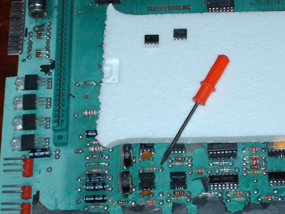

I was thinking on this and I'm going to do what I've always done in this situation: move socketed chips from the bad set to the good set until I find the bad chips. I am convinced something went very wrong during that minute this repaired board was plugged in my machine.
I have complete confidence both sound boards are okay, I've swapped them between sets and they work perfectly. My issue is with this repaired main board.
Now, let's have some fun*
Okay, so I lowered the voltage back to 4.7V at the board for my working set. Check.
I have video and can play a pefect game. Check.
I pick my first victims, these tiny eight pin chips near the two pots I was adjusting. Check.
* This is not fun.
