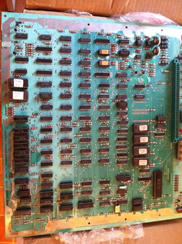

Ok I have another set arrive today that has been sent over for repair by IFKZ

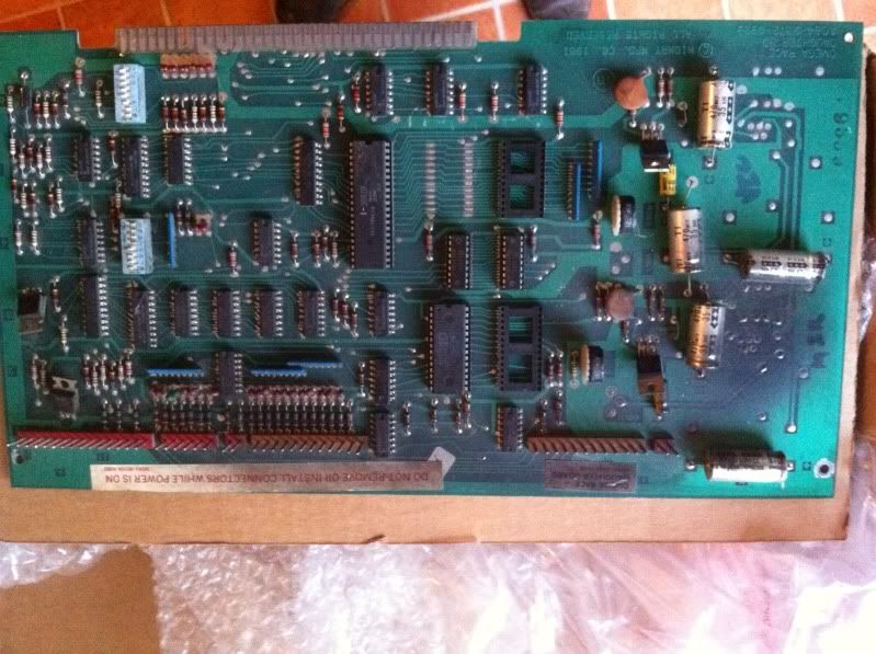

The main board looks very clean, the sound board looks like its been in a fire :)

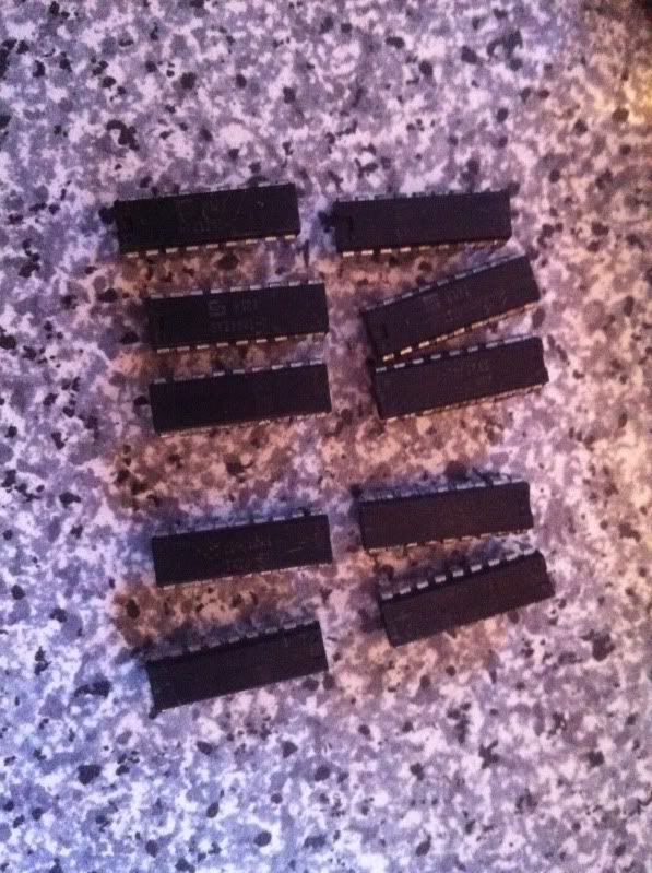

I pulled all the chips that were in sockets, 10 of the Ram were dead

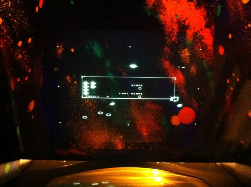

I installed new Ram and Rom and powered it up using a spare sound board. It passes self test now but the picture on my scope showed a flat line across the screen. One of the 4016's in the vector output stage had been changed...I swapped it out and got a full screen........of garbage. You can play a game and there is movement but it is very corrupt. Swapped the Dac's ...no change so it looks like something wrong pre DAC but not far enough back to trip the watchdog.
I will have a prod around the board later and check a few chips, then time to clean up the old sound PCB.
I saved this from a lset of Omega Race PCBs I bought many years ago when my original sound board blew out. Of all of them, the main board seemed like the most repairable, it was actually very nice aside from the mask lift. I made it as complete as possible using scraps from the other sets. When I got it, it was missing the pots, crystal, DACS, all of the RAM, etc.
I remember being a little unsure if the top socketed chip by the battery was correct at the time, the part number was very faint.
I am very grateful for omegaman's efforts. I never found anyone that was even willing to look at it before he started his repair logs here. It was worth sending it out just to finally answer the question...is it repairable?
If this goes well, I may be on the lookout for a cocktail Omega Race to adopt :)
And please keep the soundboard, it is yours, I figured it would help with voltage checks if anything. It did not cost anything extra to include in the package.

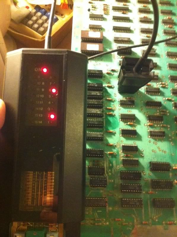

I had a prod around and found some odd looking signals on K2 (7442) the logic comparator reported this IC was good so I checked the next IC back, a 7483 at J2. The comparator reported this IC had a problem. see image below.
note the led's lit for bad outputs.

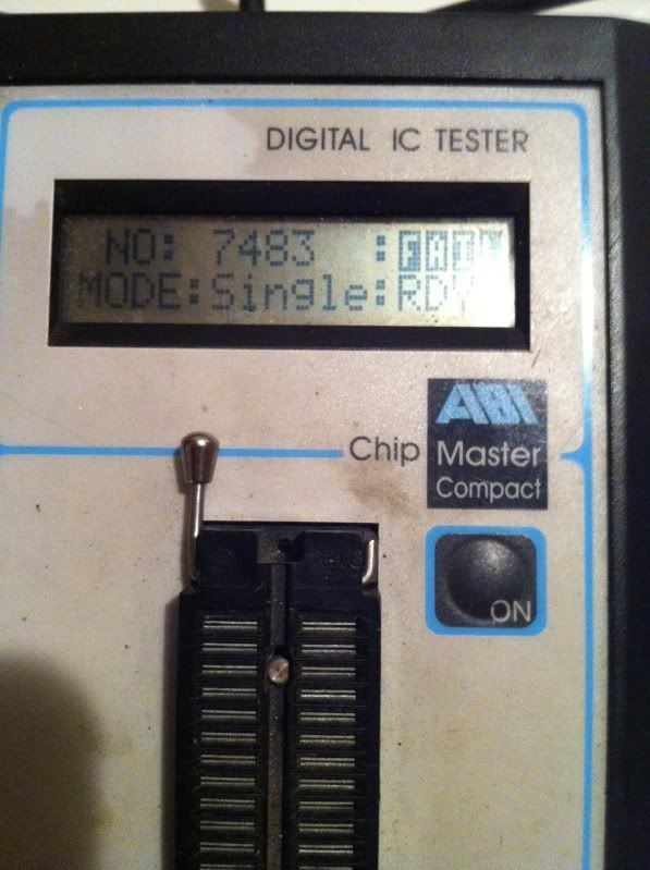

I removed the IC and checked it in my IC tester.
Sure enough it was bad. I fitted a socket and another 7483. Powered it up and it plays perfect!!!
Having played the game for a while now I've noticed it runs faster than normal.....probably twice as fast. Being similar to Asteroids I'm guessing its a problem with a 74161 so will check it out. It's like the 2x speed up mod on asteroids.

I don't know if everyone here sees how cosmetically bad that board looks. Look at the green mask, it is flaking off almost everywhere. It had a lot of prior work done to it with ten or so new sockets. I had no way to check if this work was good or not. If you flip it over there are a lot of soldered areas. That more chips were not bad is amazing.
The board was sent through the dishwasher and left in through the heat cycle as near as I can figure.
