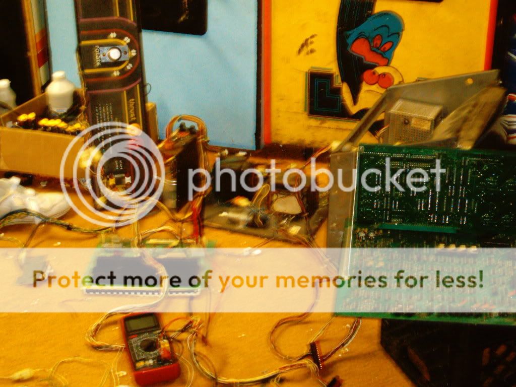

Can someone help me out by taking pictures of the interior of their Omega Race Cocktail? I have one but all the boards are gone Just wanted to see what everything looks like when its together. This will give me a better Idea of where stuff goes and what the PCB's look like when I go to find them.

i will go ahead an put my .02 into this, but here is a photo of everything in a omega race laid out on my floor minus the marquee, flourecent lights and the art glass. here ya go, this is what you are missing.
whole setup

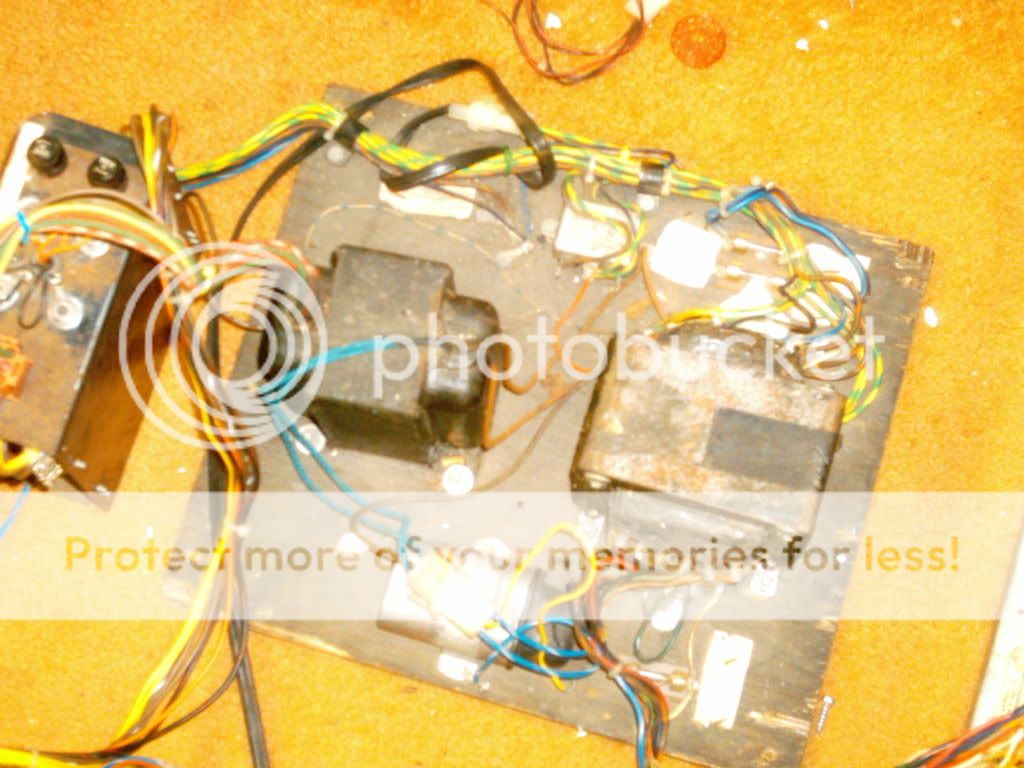

off the xformer taps i see, 18 v h, 18v center tap, 18v low <-going to board 3 pin connector, 3.16v,0, 3.16v going to ps board, 6.3v,0, 6.3 heater voltage?? 30v, 0, 30v <--- going to monitor
the big MT89A that plugs into the filter assy has 9VAC and 15VAC i think comming out of it unreg.
caps in filter assy are 100,000mfd/uf 30vdc and 55,000 mfd/uf 25vdc
3 pin connector voltages are the one with 3.16v... im guessing the battery charger circuit???

I need some more pictures of the wiring I have two brown wires coming off the one transformer the one with the wire harness coming out of it that plugs into the filter block. These brown wires where cut not sure where they go. Plus any other pictures of the wiring would be much appreciated. I just made some major headway with this project today. I finished off the monitor rebuild for the most part 2 of my caps where wrong. Now I'm in reassembly stage.
