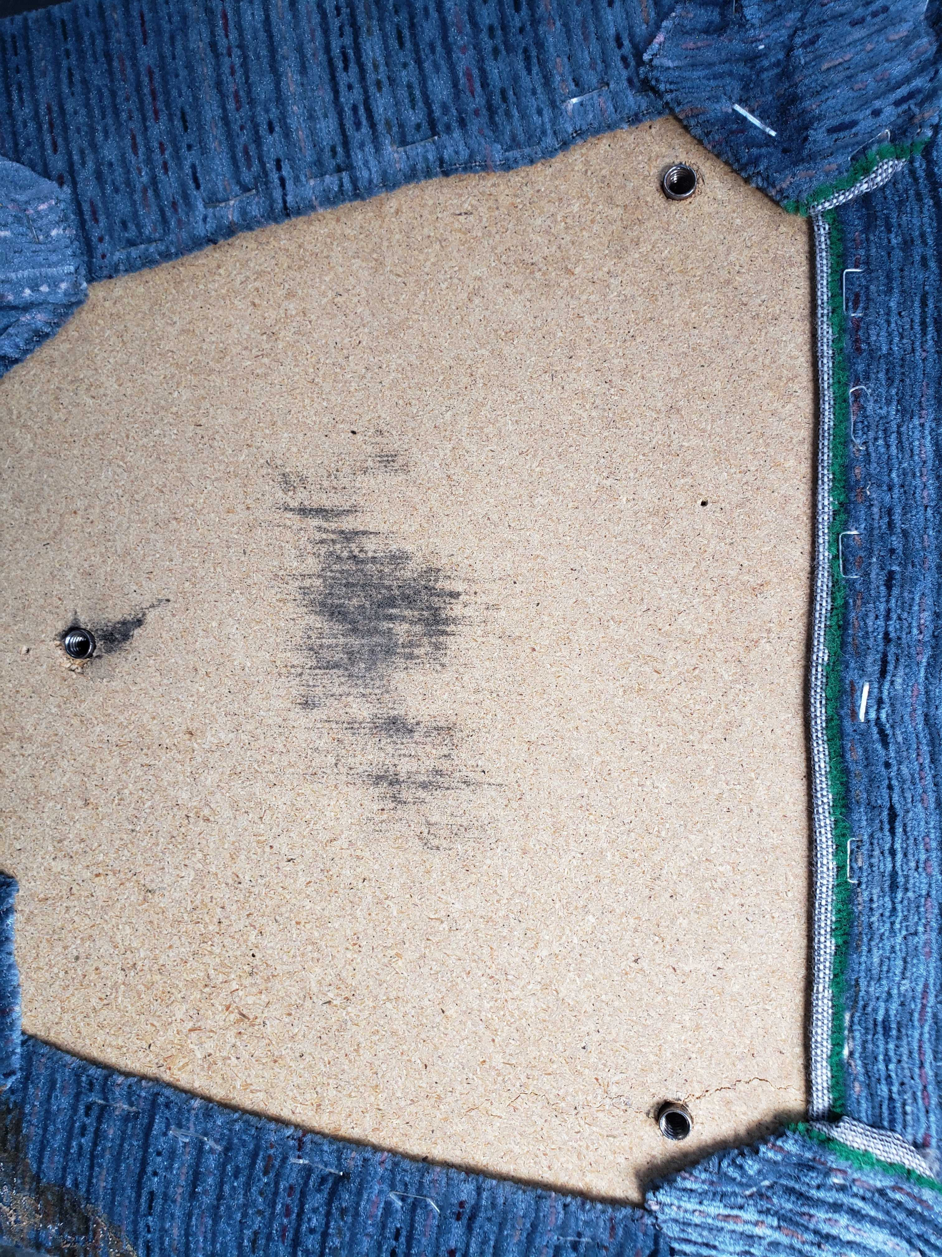

Does anyone out there know how to remove the cushion seat in the Omega Race cockpit?
I'm working with a friend to restore his recently-acquired cockpit and we're pretty close to having it ready with the plan being to bring it to CAX, but the seat cushion is split down the middle and needs to be repaired and/or replaced.
We briefly looked it over on Saturday while we were working on the cabinet and couldn't see how to remove it.
I know the cockpit is pretty uncommon, but if anyone knows more about how to remove it, please let me know.
If nothing else, we can just buy some foam to shove in the split area and shape it and then tape it over, but it would be nicer to be able to have it repaired correctly of course ;) .

Look up through the coin door and, if I remember correctly, there is a bolt to remove (at the front/center underside of the seat).
Then shift the seat one way or the other.

Given what I recall of OR construction, it would be that, or screws into each corner accessed through the coin door.

Update - there are three bolts. One at each front corner and that other one in the middle (as shown above).
And, yes, we reupholstered the seat cushions with a different softer fabric (in a compatible Omega color, IMHO). :)

PICTURED: Seat (not backrest) - accessed from coin door
NOTE TO SELF: Today took the seat off and added washers. Getting the bolts back into the seat PEMs was a PITA. (trying to LOL)

Nope, easier to get to from the coindoor. Especially spill protector is still stapled underneath the seat.
I ran into 2 issues.
The numb-nutz that played with it before didn't use washers so two bolts were screwed in damn near till they were flush with the wood.
And the must have lost a bolt since the third bolt was screwed in but the head was still 1/2 away from the seat so it wasn't doing anything. It was easy to get wrench on it though.

After getting the 3 bolts out, the seat was still firmly attached to the base. I started using a screwdriver to go around the seat to try to pry it up. It gradually started coming up. It was a slow process to get all the way around it. Turns out the vinyl edge around the seat on the bottom of the cushion had itself adhered to the base and had to break that vinyl seal. We were afraid a previous owner had glued it down.
