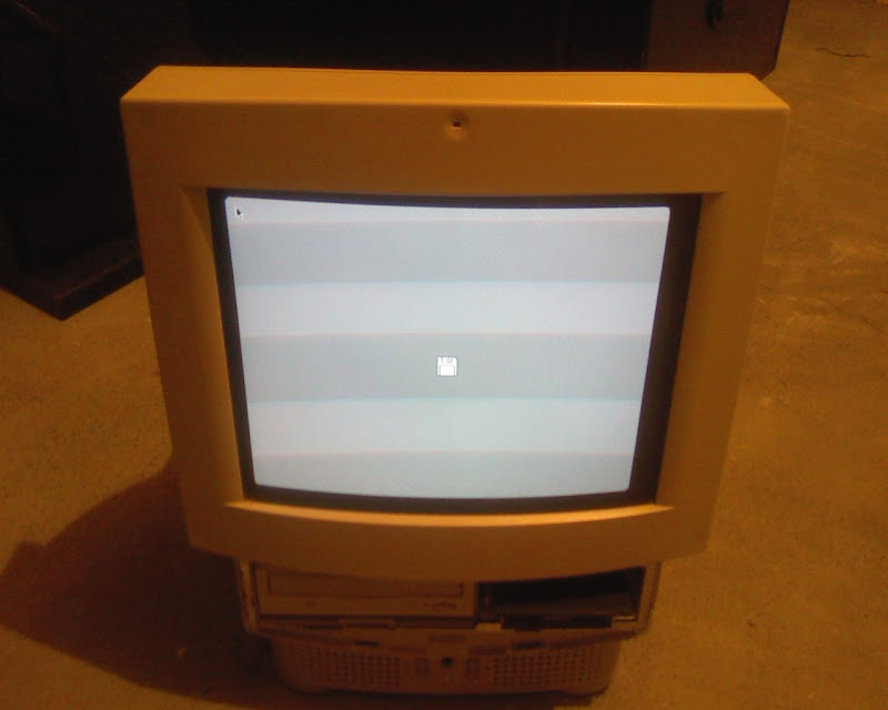

I have an old Mac Perfroma 550 I picked up out of a trash bin with a prefect 14" monitor, has any one tried to use one of these sonys in a cabinet? Will it run at 15khz? It has a Apple ][ card in it so I thought it might.
http://www.everymac.com/systems/apple/mac_performa/stats/mac_performa_550.html
Here is a pic:
Nope. That's a fixed frequency computer monitor. Might be dual frequency... but in any case, it's not going to support the 15.75khz sync rate that an arcade monitor will. It's intended for the Macintosh 832x768 resolution, at something like a 75hz frame rate (don't remember the sync rate off the top of my head).
The way the Apple IIe card in those machines works is to produce the Apple II video in a window on the desktop - so the video goes through the Macintosh framebuffer first. The monitor doesn't change modes to use it.
The error that the Mac is giving you means that it can't find the system software. This is either because the hard drive has died, or somehow become corrupt. There's nothing special about the hard drives used in Macs, so if you want to replace it, you can use a drive from an old PC. You can download Macintosh System 7.5 from Apple (among other places), and install it.

Thanks Ian, I was hoping it might support 15 Khz. Thanks for the info about the hard drive, I actually had it out, it works fine. The thing I am most fustrated with that Mac is that I want to play Apple ][ games on it, but I don't have any way of getting disk images on it. Everything I have is on 5.25 floppies. Any advice there?

The Apple II emulator card works like a complete Apple II on a card. It has a funny high density connector on the back for which you need a breakout cable. The breakout cable goes to a 19 pin connector for the Apple II 5 1/4" floppy drives and a 9 pin connector for Apple II joysticks.
The card works with a special program in the Mac system software to allow it to display stuff on the screen, share the floppy drive, use the mouse, etc.
The Macintosh can read and write PC floppies, and Linux can read and write Mac floppies, so data transfer should be cake. The only caveat is that a PC is incapable of writing or reading 800k Mac floppies. You must use 1.44mb high density disks. What version of the System Software is running on the Mac?
