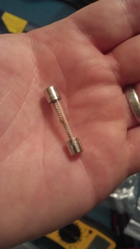

thanks for the tips, fellas. moved the flipper manually and it wasn't bound in any way. popped the top and took a look at the plunger thingy and it looked fine.
looks like we found the problem....or at least one of them, as i don't have a new fuse to replace it with right this second:

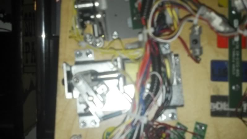

and fwiw, there's a fuse right there at the upper left flipper...just for future reference:
That pic is too blurry so I can't see where the fuse would go. That is good to know there are fuses down there.
yeah....i tried two and it wouldn't focus so i just said eff it. LOL.
it's directly across from the red insert.

OK I see the fuse holder now. Thanks.

A common Stern issue is bad flipper Transistor..... When the fuse is blowing, need to know the reason why -
Hopefully you replace it and it doesnt blow again (3 amp slo blo).
If its still blowing (or even now, before you chance another fuse), check the power (larger) board in the head, test transistors Q15, and the surrounding ones (Q15 controls the left flipper - forgot which one drives the right).
