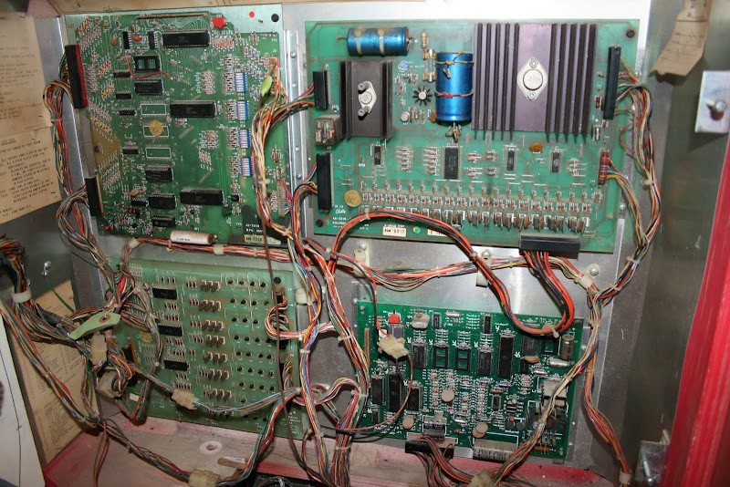

Anyone remember this pic?
Pay special attention to the MPU connectors, you'll notice a stray brown wire with some green electrical tape splicing it in.
Well, that's actually masking tape.
And after removing it, I found that it's not capped, soldered, or even twisted properly. The wire was just wrapped once around an inline splice. A quick bit of solder fixed this up.

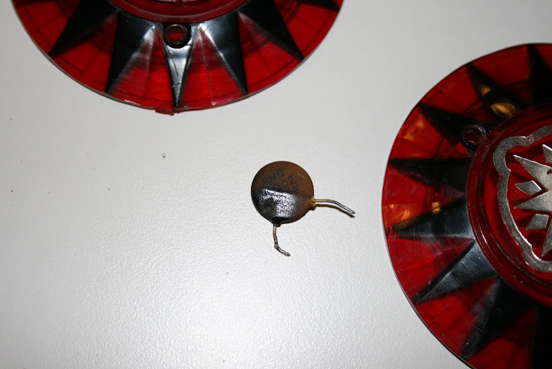

A quick inspection of the solenoid board indicated a blown cap. I replaced it, but it covered the transistor for the 'Match' knocker. Which was firing fine. Replaced it anyway. The #3 solenoid (downward kicker) doesn't fire, even with the ground shorting trick (which was really handy after I replaced that cap and the solenoid fuse came lose under the PF at the same time... I thought I shorted something!). I did a quick cont test and confirmed the wire was connecting. The pin also seemed to be connecting, though there was 4 ohms or so of resistance between the diode and pin.)
Turns out the replacement DMM I'm using has a different way of indicating units than my old one. The resistance over that coil isn't the 14 ohms I thought.. it's 1.41 megaohms.
I'm guessing that's why it's not firing.
Update: Found a hairline crack in the solenoid's winding. There's no slack to try to repair it, and it looks a bit worn anyway, so I'll just replace it.
Unwound the coil a bit and soldered it back where it's not cracked, resistance is now down to 43 ohms or so. Solenoid still didn't fire, so I replaced this perfectly fine looking capacitor...
and it fires now.
Getting there...

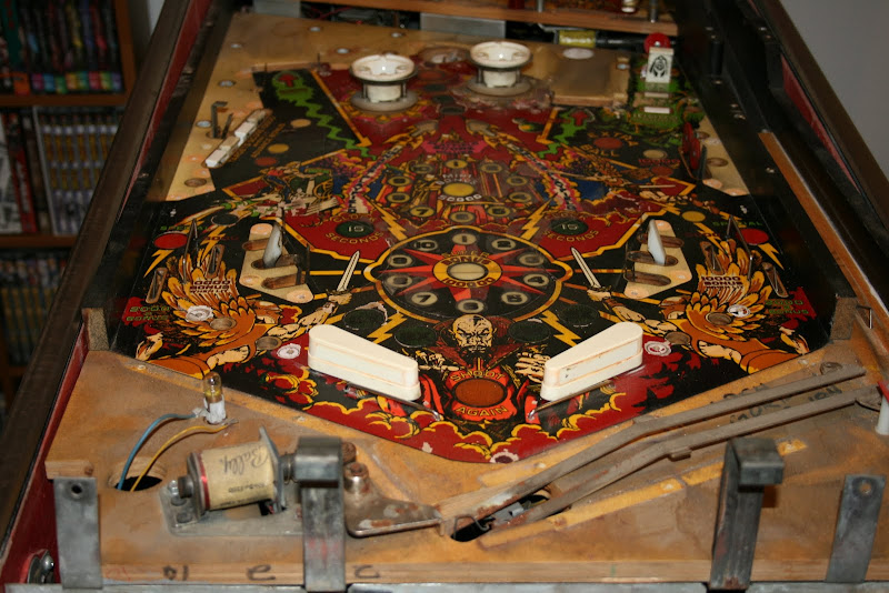

Update: new discovery, some of the feature lights aren't turning off fully. They don't stay solid, but become dimmer and flicker while off. Some more than others. It's worst during play, but is still somewhat evident during the light test.
Sealed the backglass. The bottom edge has some damage that may be beyond repair, but the majority of the glass looks fine now. I might try that trick with plastic wrap to help adhere the remaining bottom bits better, but it already looks significantly better. I need to clean up the score edges a bit, but I think it turned out pretty well.
Reassembled the first target assembly with new targets. The drop springs are kind of weak, I might need to order new ones. Especially since the replacement rings are a bit thicker, and rub against the targets slightly. I don't think bally could have designed a more annoying assembly to house their fragile drop targets.
Clipped off the old battery, need to find some nicads to put in the new 3xAA holder. Replaced the missing post in front of the spinner drop arm.
Finding LOTS of dead sockets under the PF. Combination of rust and corrosion. I might try cleaning them up a bit, but most don't want to even release their current bad bulbs.

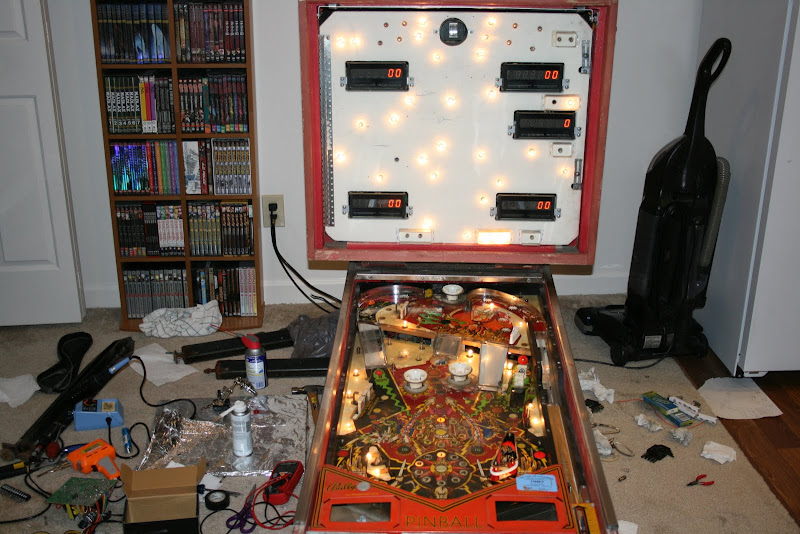

That mess looks like my basement right now, I'm working on 2 pins plus zekes peak. I got shit everywhere..although I do have some tables and shit so it's a little more organized..but not by much :)
Went over the rest of the PF and replaced every bad bulb that I could, leaving me with just the bad sockets. It seems the bad sockets are concentrated around the front of the machine near the coin door. Most are rusted out pretty bad and/or corroded. I might be able to salvage some, but others will probably need to be replaced. However, oddly, once I replaced the bulb under the skirt, the issue with switched lights flickering dimly while off has gone away.
Replaced the spinner switch. The replacement is close to the original, so installation wasn't too bad, but getting it gapped properly is becoming a chore.
All drop target assemblies have been disassembled, with bad targets/missing springs replaced. All work now EXCEPT the third inline target. This target keeps hopping off the track and getting stuck. The guide bar that normally keeps it in check has broken, and will need to be replaced. I might try bending the trigger back a bit so it stays slotted when the solenoid kicks, but I'm not sure that will help.
Installed a battery pack to replace the time bomb nicad that was still there. I bought NIMH batteries, but the pack ended up having a diode in it. might cut it out, or might just use the NIMHs elsewhere and install some normal AAs.
The electrical tape on the PF came up with some freeze spray, though some of the paint came up with it... especially near the top where the paint was already weak. However, this is still a massive improvement over just pulling the tape off.
Solenoids are still acting kind of weird (Sometimes the wrong one will fire, or an extra one will fire at the same time), but it looks like that'll be fun to diagnose, so I'm not particularly motivated to fix it at the moment.
Your always on lamps and possibly some of your coil issues sound like grounding issues. Make sure all you have good grounds on all of your boards. I'm not incredibly familiar with that boardset, but Gottlieb boards of that era have the grounding issues that can cause those problems.
you are lucky about the mpu not bieng corroded. i thought that was standard lol. remove that battery... NOW
and dude, for just getting into this your at it like an old pro!! too bad your not closer to me man.
on basically every ss bally i get i run jumper grounds in between at least one screw on each board. WHy? i had a freedom that acted all kinds of goofy (rendomn rebooting, not kicking thr ball, weited lights, stuff firing on its own) due to grounding issues between the boards. Theres prolly a bad molex pin somewhere or something like that but this fix makes it much more bulletproof, imho. I made some nice jumpers with eyelets, screwed them down, and voila. eveything was happy.

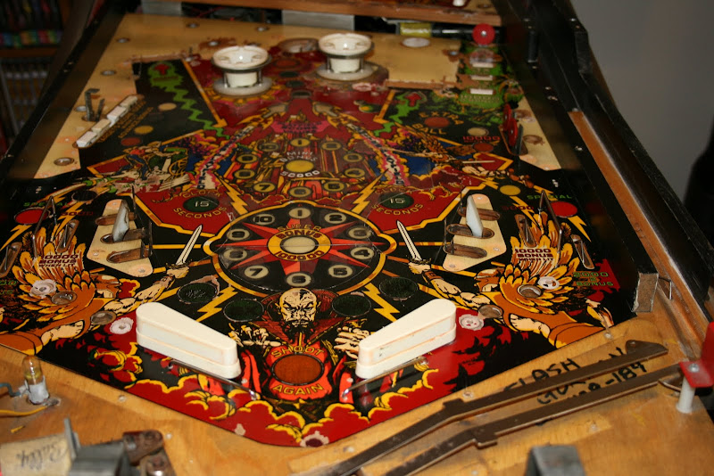

Tonight was fun.
Stripped the playfield...
Waxed it...
Reassembled...
Played a quick "victory" round, and right on the first hit on the first ball, and I chip the flipper.
I really think this machine doesn't like me.
