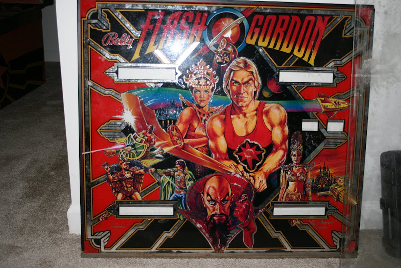

So, on a whim, I went to check out a local ad for a pin "for parts or repair", listed at an absurdly low price.
It's now sitting in my apartment, in pieces. Not sure if I should be proud of my find or start crying. I love messing around with electronics, but this is a pretty big jump from the small kits I've messed with in the past.
Anyway, it's a 1981 Bally Flash Gordon. Lets start with the good:
Backglass looks good for it's age. At worst case, I can ebay the backglass for more than I paid for the machine. probably.

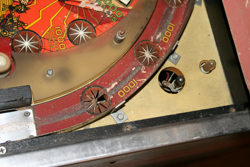

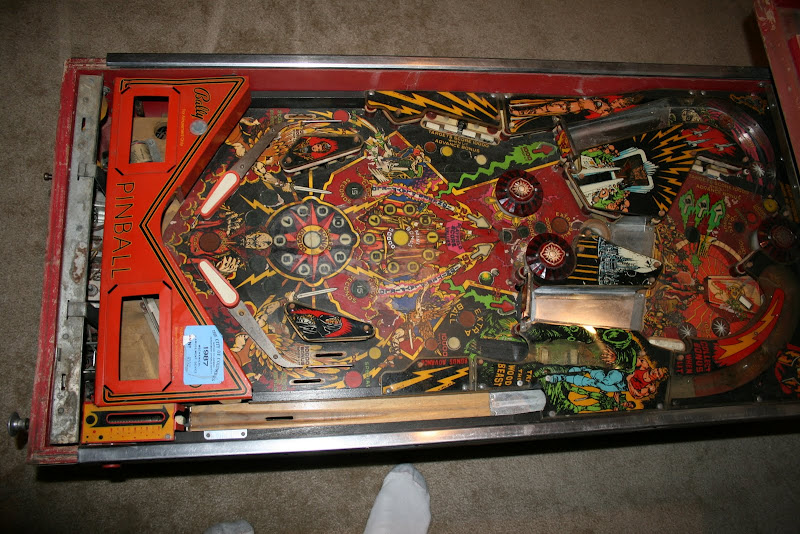

Playfield is uneven... looks like decals were placed in various spots to cover up chipping. Due to this, there are several seams in the field. Not entirely sure how to attack these yet.

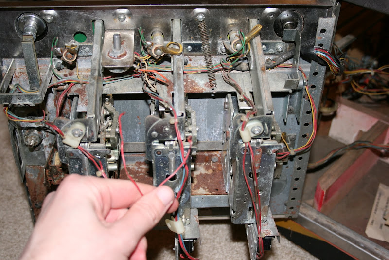

SBA coin op mech is a bit rusted and doesn't work. So the op was kind enough to snip this wire instead of just pulling the bulb

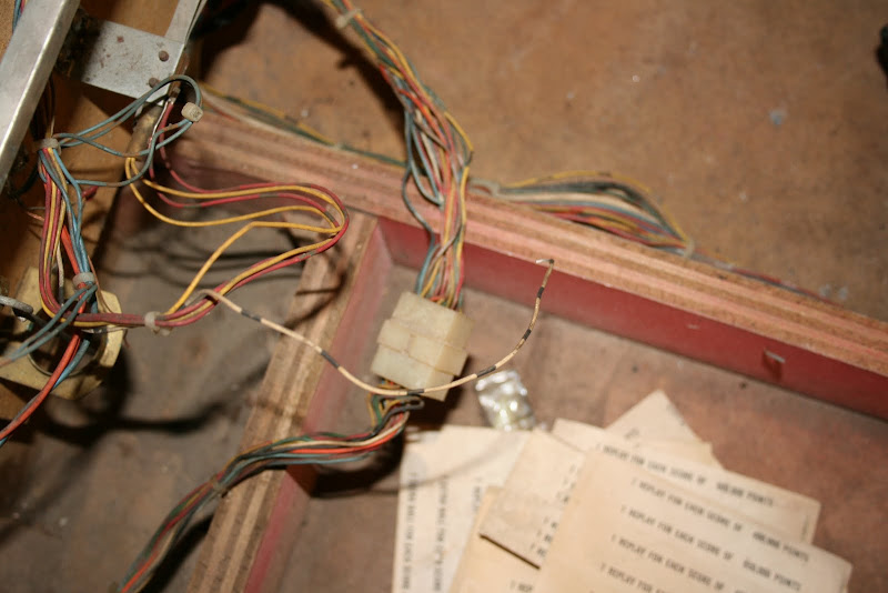

Slam tilt sensor was just too much of a hassle

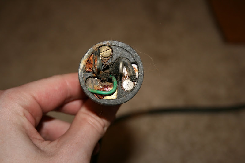

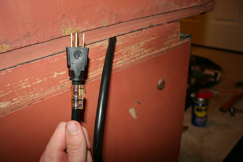

Op just couldn't spring for a grounded plug.

Congrats on the find and welcome to the group! The playfield is actually in very good shape for a FG. Most are worn down to bare wood right above the flippers. I believe that the "seams" that you feel are the edges of mylar that have been applied to help protect it. You are on the right road by replacing the power cord and rebuilding the power supply first. Good luck and keep us informed of your progress.
yeah, this makes sense with what I'm seeing.
The edges of a few of these are starting to lift up, is there a good approach to resealing them? Also a one of the light covers between the jet bumpers has sunk a bit, is there a way to repair this?

That dinky old cord has been replaced. It's a bit overkill, but it fits.

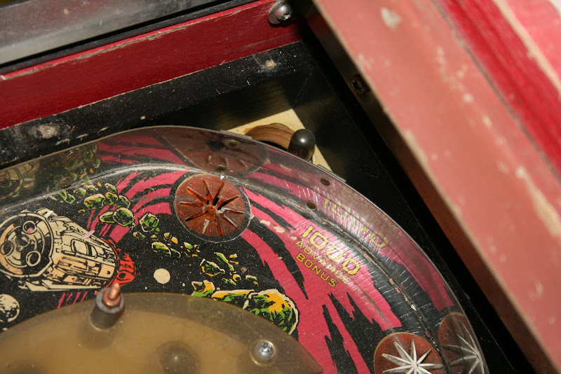

Rollovers have seen some serious abuse. Not sure if these can be properly fixed.

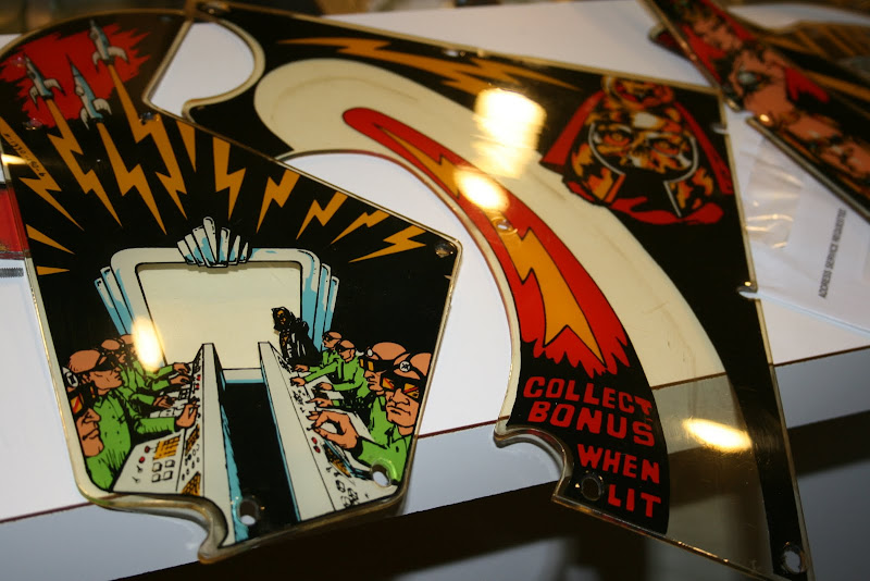

Plastics are yellowed a bit, but otherwise cleaned up nicely. It's interesting to note that a majority of the dirt was on the underside. Probably due to dirt being carried off the playfield due to the heat.
the playfield is also cleaning up decently, and should look ok after a wax.

A few spots have paint coming off while i clean it (using novus 1 and a soft cloth atm) so I suspect water or heat damage. So far only one section like this is on a playfield area though: the upper right corner, mostly centered around he bulb under the plastic. Most of the loose paint has already come up, but I'm hesitant to clean the tracks now that I know more paint could come up.

You can buy replacement rollover inserts from the Pinball Resource. Since, originally they were glued in, then the entire playfield was ran through a sander before art being applied - you may end up having to flip the new insert over on sandpaper and take some thickness off, then glue in. Not a hard fix at all.
