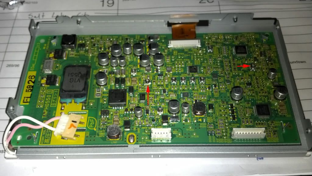

Opened one up (there goes my waranty :)), surprisingly there is a lager 3 pin connector inside. There are also 2 additional pots that aren't accessable with the back cover on. No clue what they do. VR852 and VR901
Ok I see the pots but where's the large 3 pin connector? I see the one at the top which is maybe a 40 pin ribbon which should go to the screen matrix or what ever you call it and the large plug on the left with 2 wires should be the power for the CF back light and should be Hi voltage. What am I missing?:rolleyes:

VR852 adjusts power supply voltage.
VR903 is vertical position.
You can thank Channelmanic for the updated info. He came over and helped me attack the insides on these.
