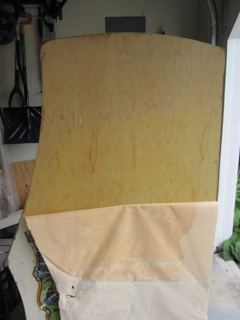

The vinyl is peeling back at the top on mine. Was the vinyl installed on the plywood and then screened? Could have been. It's still vinyl glued to the outside of plywood though. I could peel mine off in one sheet. I believe Nutballchamp installed Rich's repro artwork and it looked great.

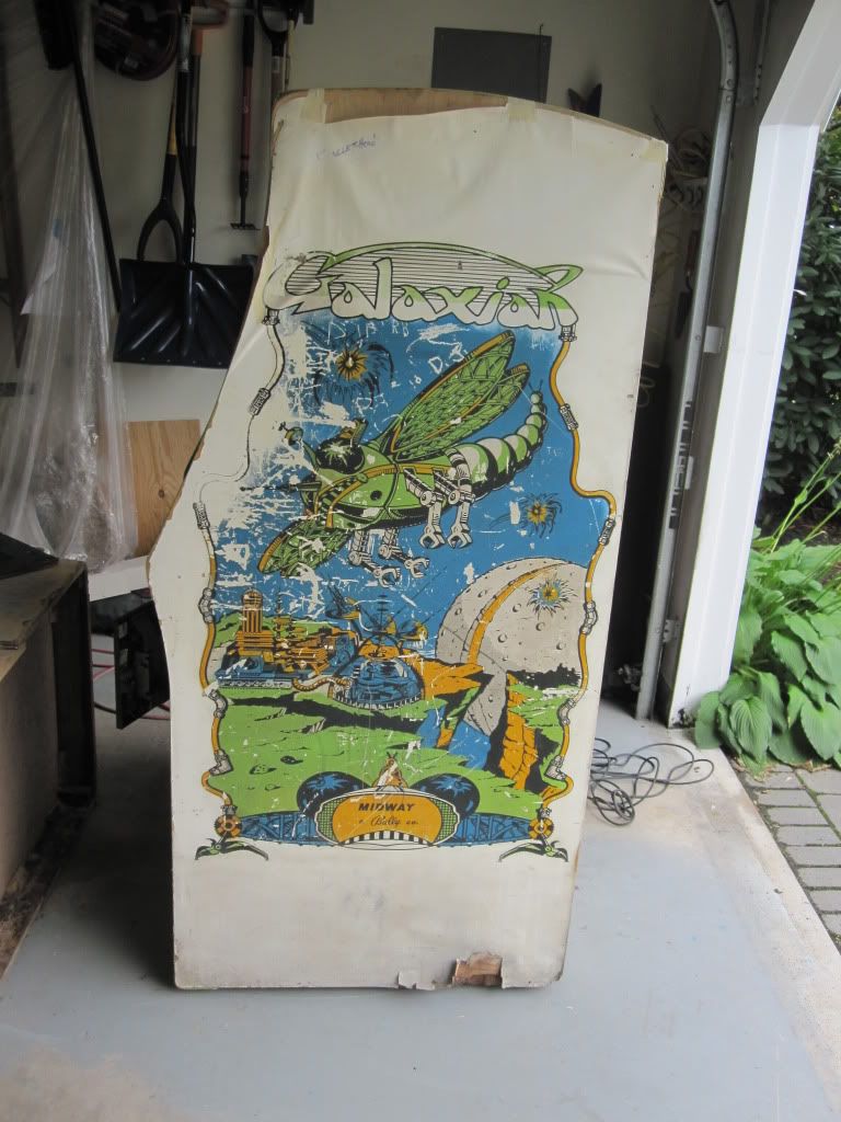

Post us some pictures of it if you can. I am in the middle of restoring a Galaxian myself. It was converted to Ms. Pac and someone thought it would be a good idea to paint over the original artwork. The vinyl peeled right off and left nice wood underneath. I would like to what exactly you have.
Yes, you can peel it off, but it's on there pretty good (use a heat gun). Nobody at Midway applied the vinyl... the cabs were built from vinyl covered plywood.

Here is mine

bumping this thread to ask what is the best way to prep an original cab for repro side art? i assume the original vinyl has be stripped off first (then bondo, sand, etc)?
Yes, you'll need to remove the vinyl. Bondo any areas that need it and sand smooth. Then put a coat of white primer on it. Give the primer coat a light sanding before the artwork goes on.
