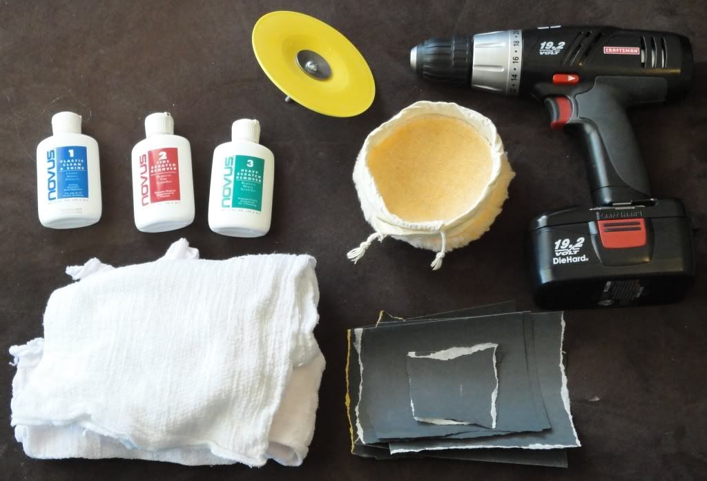

I use NOVUS a lot and it works great for me, but there are things that need to be done to prep surfaces to get good results. If you have any scratches that you can feel they need to be reduced. I use fine sandpaper to do it. Here's an example...
The only part to focus on in this example is the clear instruction card window. There are scratches and cig burns that are visible in there that make the CPO ugly. I used a damp rag to clean the area, then used different grit sandpapers to get the major blemishes out. After I was done, it was very hazy. See...
Then I went to town with the NOVUS. I cheat a little by using a cordless drill with a 5" buffing pad attachment. I think the heat generated and the fast rotations are what produce the results.
When it is done you'll see that the window is clear and looks a million times better. Also, you see that all of the haziness from sanding is completely gone.
Here's the other part which tends to scare people off. Total time spent on this CPO: 4.5 hours.

I do the sanding by hand and use the drill for the polishing.

I use NOVUS all the time. I actually think it works great. And Nerdtendo id 100% correct that if you have deep scratches or cig burns you need to sand it with fine sandpaper.
I use a Dewalt orbital sander with the buffer pad on it and it works fantastic.
I never took pics but I had a bunch of Williams "QUARTERS" plexi inserts for the stainless Defender style coin doors and I sanded them down with 220 grit paper and then NOVUS #3'd them to get the majority of the scratches and then NOVUS #2'd them to a nice smooth shine. All with my orbital sander.
Good luck!

Abrasives is a very slippery slope of death. Listen up, padawan. I'll try to give you the ADHD version.
Start with the most coarse grit you can bear to work with. Just remember, the lower the grit you start with, the looooonger the process will take.
For a plexi marquee or overlay, I use these:
1. 600 grit on a variable air-fed rotation sander, on the lowest setting possible.
2. 1000 grit to pull up the scrapings, at a medium rotation setting on the air sander. Keep it medium - you don't want heat at this stage, just cutting up from 600
3. 2000 grit, misting with water while sanding. Pick up the speed a bit more on this now, heat can help you. But don't burnish it. It's a fine line. Keep the mist going to keep the heat in check.
4. Move up to a higher grit, if you can. (optional step - makes the next step easier)
Now get off the air sander and move to a buffing wheel. Start with a foam sponge. Use a polishing compound. You can start to spool up pretty fast here. You're going for a combination of abrasive AND heat. It takes finesse.
At this point, you should be at a near mirror finish. You'll see microscopic swirls when viewed in bright light at an angle.
Lastly, get out the Novus. Put on a cotton bonnet on the buffer. Polish for about an eon.
That should do it.
Remember, if you fuck up any step, you gotta start all over again at the beginning. You cannot fix a bad cut, you gotta start over.
