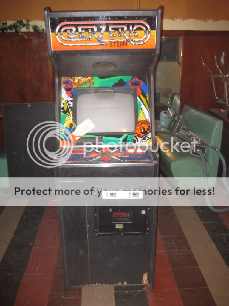

About three weeks to a month ago I was bored at work so I did my usual lunchtime Searchtempest scan around the area. I see a Berzerk in Grand Rapids, MI, so since it's a slow day I email about it. He's was asking $400 and said it didn't work. I said $400 is too much for a non working game and good luck, etc. So I totally forgot about it since I had two drill weekends in a row. Last week I get an email saying he needed it gone and come get it for $100. Before my next breath was out I replied 'Sold!'. Berzerk was one of the last of my most wanted games since I played it back in the day, and luckily didn't drop dead from a heart attack from what I've read.
So I made the trip leaving Cleveland around 0530 and got back around 1500. They guy was really nice and said he had to dump it because he lost his house. I felt bad and promised him if I ever sold it I'd call him first, but I told him his ass would come out to Cleveland to get it. He said he had the game since the 80s and that monitor went out and then the game stopped playing blind. He didn't seem to know too much about the game itself, so I didn't ask too many questions.

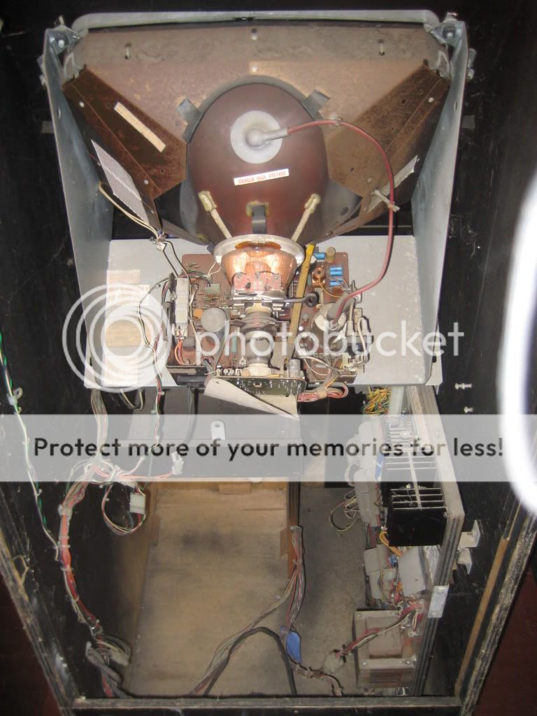

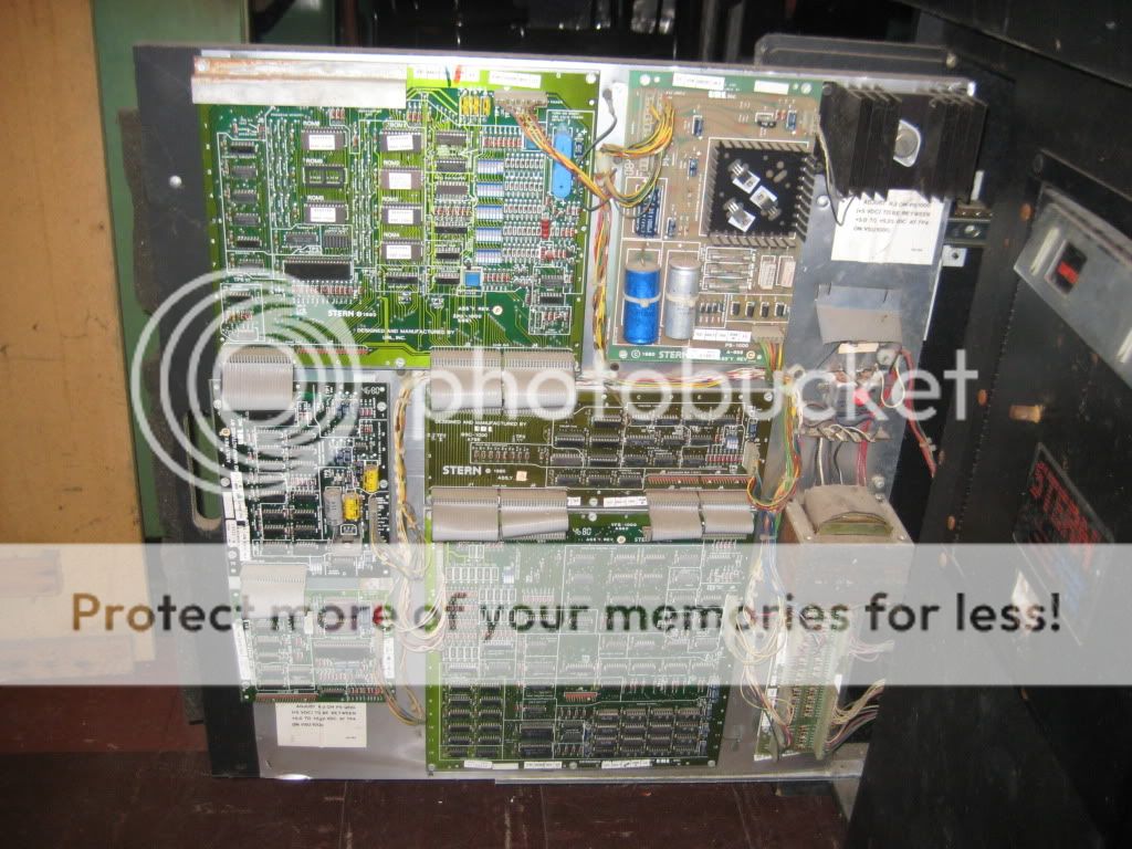

I dropped it off at my bar and gave it a good basic cleaning and a good looking over. Nothing appears broke or missing, but I hear these games are a pain in the ass. I fired it up and the bezel and coin door lit up, but nothing else really. The LED on the ZPU lights up, there is a loud beep followed by two quieter beeps, and the LED goes out. The monitor doesn't work and there is no neck glow at all. I'll check the manual out later. As the pictures show the inside is not so bad. And now the pics:
Once I get a good look at it and scan the manual I'll post all of the issues in the appropriate section.
That looks pretty clean for a 1-bill cab, nice job! ;) Hopefully it's just a fuse or something. Hehehe.
Awesome game, I picked my non-working Berzerk up a few weeks back and got it going just the other night 100% thanks to seinologist. Love that game. Nice work sir.
I just worked on one of these and got it running. I believe getting 3 beeps means the Zpu is good. It's failing on the VFB tests.
First thing I would do is remove that battery before it starts leaking.
Next clean all the pins on each board, and reseat all the interconnect cables. Be careful when removing them. Support the front, and back side of the cable. Those IDC connectors will break wires like crazy if you aren't careful.
The manual has a pretty decent TS guide, pointing you to the areas of most likely problem chips.
Sounds like the problem is in the VFB, like I said most likely those cables.
