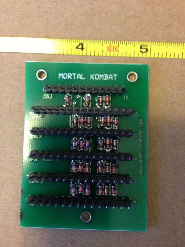

If you've got two boards in the machine and only one of them is "ON" the one thats off will drag all of the switch signals down (basically acting as though the buttons are pressed) on the other board. It wont damage anything but the inputs wont work. A simple way to isolate the inputs from each other is to use diodes but if both boards are powered up you dont need to worry about it.

I sell a PCB to do this
Woah, awesome! How does it work? I assume there's one slot that goes to the buttons and the others are just relay slots? Is this CPS2 compatible? Also, I take it that you need run the kick harness into a molex connector of sorts? I think I might explode with joy...
