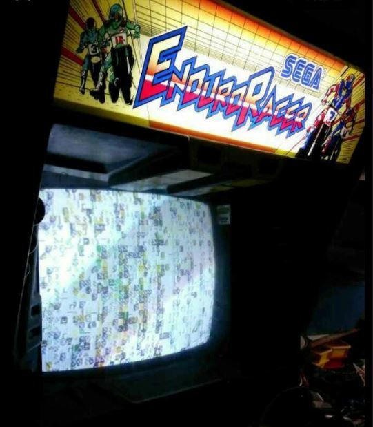

I have a lead on a non working Sega Enduro Racer. The cab looks to be solid but in rough shape. Seller is asking $150. Looks like there may be some PCB issues as well. Any suggestions if that's worth it?

Well, It's probably got a 4900 in there... looks to be working good too. These pcb's have a battery back up 68000 cpu, not to different in theory to the CPS2 hardware.. The battery probably died and wiped the security info. Just burn some unencrypted Roms and replace with a standard 68000. Then trouble shoot from there.
