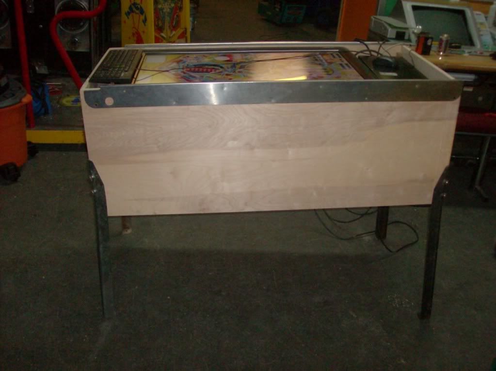

i have been messing with future pinball and vpinball on my pc for some time
i have been using it to test a pinball before i went to go purchase one
well i finaly got bolth programs to work right and configured them with a front end
so yesterday i see a 37 inch lcd pop up on cl for 150 $
now here is where i sit
i used my genie as a template to build the body (so i can use a wide body gottlieb lock down bar for the front)
whats left
drill and install flipper buttons
cut a hole for the coin door and install one
drill holes for the legs ,paint the legs i have , and install them
wire up a keywiz ,and speakers
build a back box and wire up a 27 inch lcd in it
then paint and enjoy lol
i know most of the pin heads will boo and bash but hey for a spare time project im having fun
pin heads

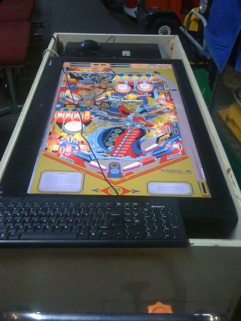

If I may make a suggestion. Decase that LCD. Build a support underneath for it to just lay on top of. I'm sure that weighs quite a bit and I wouldn't worry about it moving around.If the LCD goes bad, it's not locked down and easily replaced.
Very cool - keep going!
really not shure on what finish im going to give the cab i was thinking of doing some sort of stencil but stain kinda sounds cool as well
its more like a coffin lol
while i was building the box sitting inside it screwing in the support rails i was thinking man a few inches longer and i could be in a coffin lol
ps you going to be downtown tommorow if so swing by with that sound card i pluged mine in after rebuilding it just to see if the chip was bad and it was lol lots of magic smoke
its a floating setup right now
i removed the back shell and its sitting on rails so t can slide in and out (works just llike a original playfield lft up the front and it slides twards you )
i was going to remove the front plastic as well but the way the lcd is made the metal shroud that the brains are attached to are actuall screwed into the front plastic peice

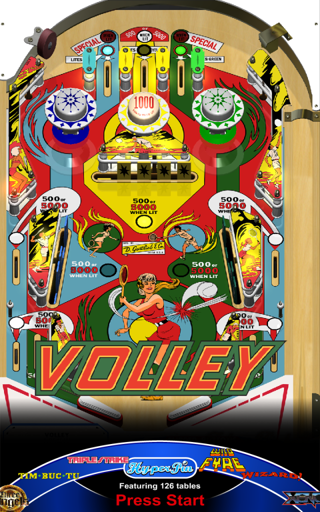

here is a shot of the game select menu
its a sob to configure but it looks awsome

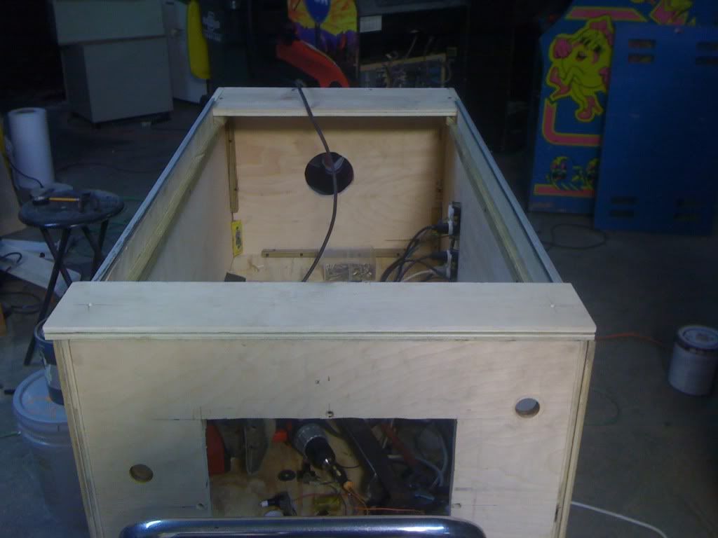

well getting closer

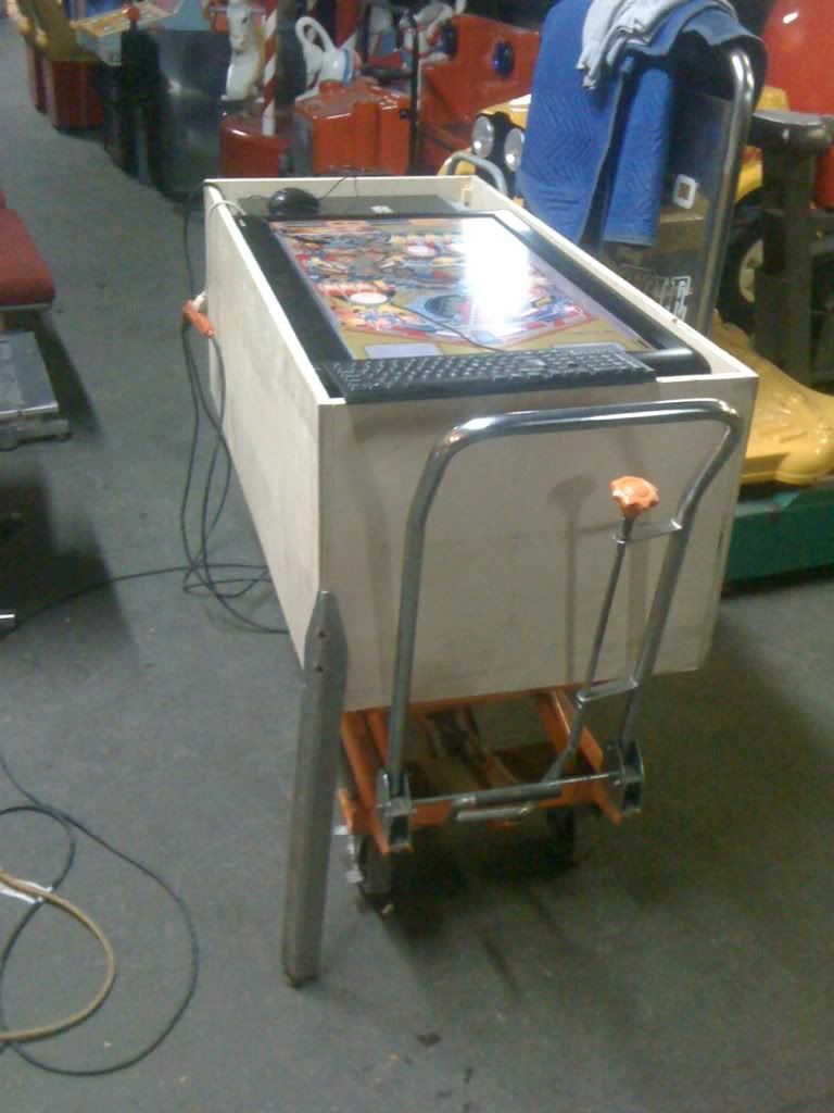

she now stands on her own with no assist from a pinball dolly
got the side rails and glass tracks installed and routed out the front for tmoulding while i was at it
installed a mid 90's willams coin door
just a few more steps and its all done
