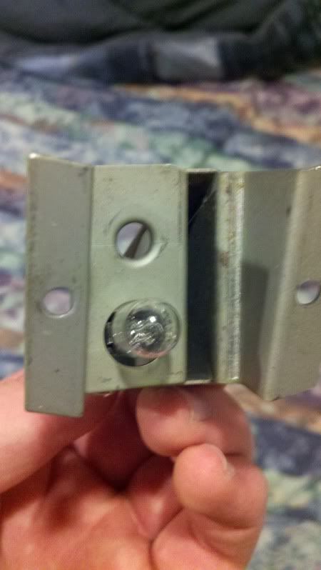

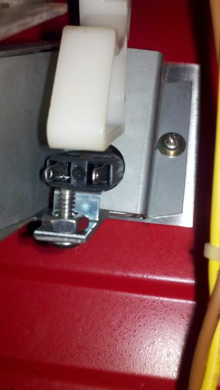

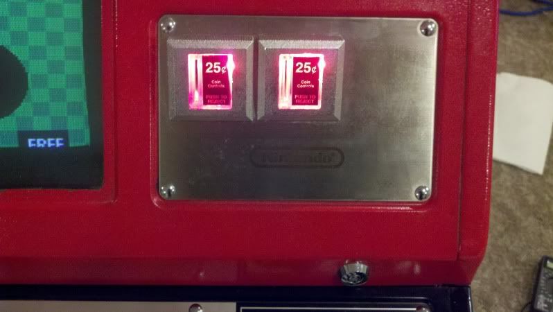

So I just picked up my first red tent and I'm stoked to get it all cleaned up, when it hits me, why doesn't this thing have credit lights? I checked a couple videos, and from what I see none of these machines have credit lights, checked the schematics (thanks blkdog7) no hookups/wiring for credit lights, and as far as I can tell I haven't seen anyone do this mod before so am I just crazy or am the only one to think of this?
Got one side done and gonna work on the next soon, but quick question if anyone knows, I'm adding 20 watts between the 4 bulbs, is this gonna stress out the power supply as far as wattage goes or does this have a little to spare? Cause I would think the upright VS cabs have credit lights and I would assume they would use the same power supply but I'm not sure...
Your assumption is reasonable. I think your power supply will be fine and nothign will be affected by adding the bulbs. They look good. Well done.
