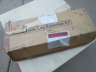

Also, I just got a red tend leg extension kit from eBay and can't wait to try it out!

Leg extension kit is cool, but you can't use the leg extension kit AND the playchoice kit on the same machine. There is just no room to do so.

Thanks for the clarification! Looks like I'm in the market for an extra Red Tent power supply :)

First...you say you bought a leg extension kit on ebay. There was an INCOMPLETE kit on ebay recently sold...it will not work on your machine as it is incomplete. Hopefully that is not the one you bought. It is missing part MDS-10-21 X2 (the actual leg extensions...)
