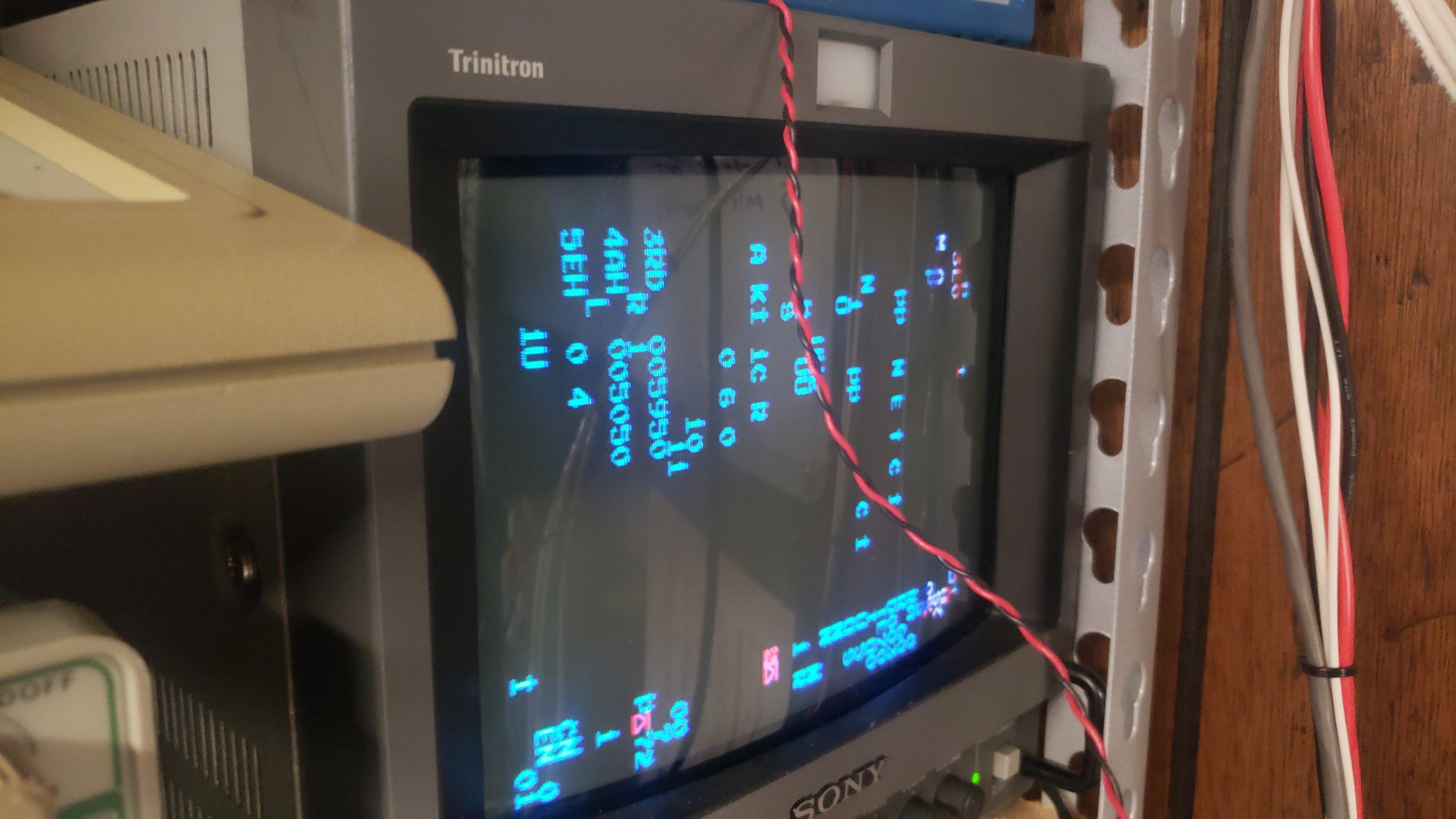

Up until this point the board had multiple chip failures.. This failure started as twitching and progressively got worse. I spent some time looking for it but the symptoms kept changing.. Twitching, resetting, RAM errors, ROM errors, etc. Finally I let it run overnight until it was completely jammed up and would not boot at all.
Here I reconnected to the FPGA Catbox and ran RAM and ROM tests.. Both failed.. Interesting. I immediately went to the PLA@6F.
It is a 74LS367 and I had already replaced the one @6H. This corrected the booting and stability issue. So yes.. I watched that chip die over the course of a couple of days. During this - the character ROM on the video board failed - ROM 5N
Look real close and the numbers have extra pixels. Doing a compare of the ROM to MAME, one of the bits failed across half of the ROM.
Last issue is that after resting for a couple of days - first power up has jumbled graphics that self correct inside of a minute. Seems like a RAM issue - but finding it has been problematic. Freeze spray has not helped. I'm running the board though various power cycles to see if I can get the chip to complete failing.

The first time around this game started this but locked up due to the 74LS367@6F. This issue was seemingly unrelated.. It seemed like a RAM issue and the RAM in this area was controlling the background (as far as I could tell by probing)
But all of them seemed like they were working correctly - I checked supporting chips, etc. The issue would change too - sometime the jitters would just stop - sometimes they seemed to be unstoppable. I decided to work backwards to the CPU board and check the chips feeding these RAM. All seemed good. The only RAM left was the CPU RAM I had replaced initially because of the failed RAM@7H. Usually CPU RAM when it fails causes crashing vs. background image instability.. But I don't know Nintendo and how they used the RAM. I swapped out the RAM with the fastest one I have and it seems to have corrected the instability issues. I'll test more .. however..
During some burn in testing.. Some of the sprites decided to scramble.. Going backwards.. However I was able to locate a bad RAM@U1 on the video board. That corrected the sprites and also fixed the jitters. Borderline RAM that FINALLY died!
