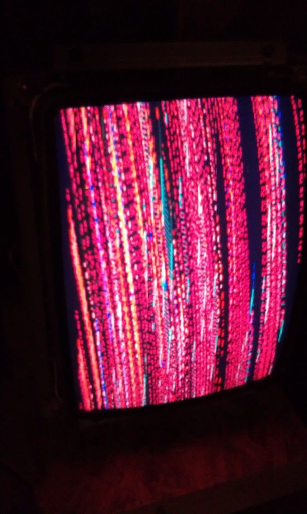

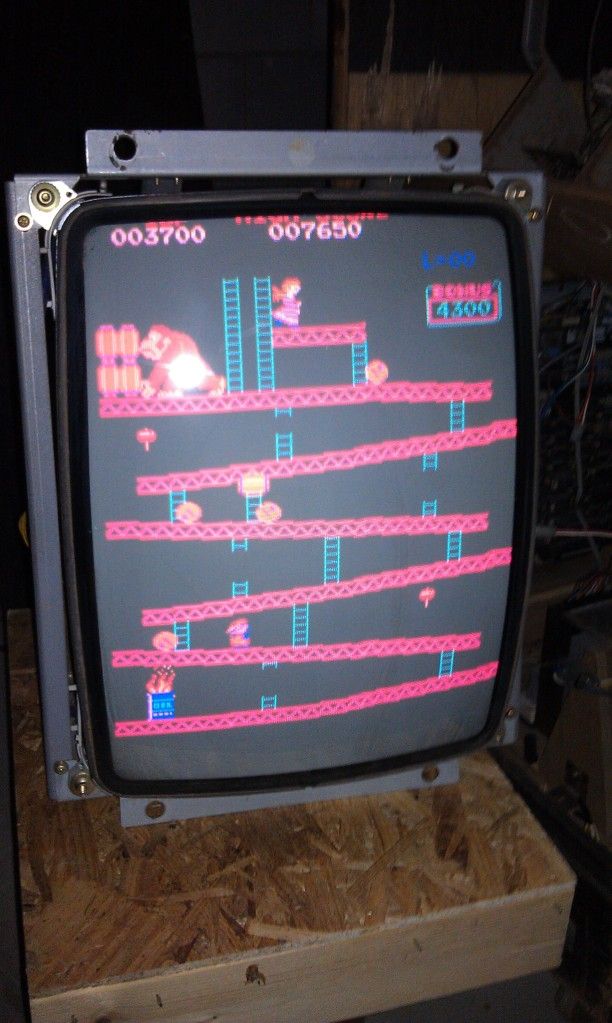

I have an all original Nintendo Sanyo 20EZ... Has great colors etc...
When I power the game on, everything looks great seen here:
After 5 minutes or so, the screen does this:
If I power it off and then back on, its fine, but 5 minutes later its back to the lines.
Any ideas what the problem is?
Yep, looks like H-Hold. Sometimes the pots on the gameboard will give you some issues a little like that too.
