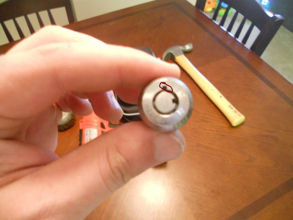

So I got into the coin box on my Red Tent today and lo and behold found this
Awesome, but even though I know it's the right key I can't get it to fit, I took the lock off to show you this
I'm assuming it's something simple and I'm being retarded. Help me out here
yup file off the little tab off on the key and then the key will fit lol
someone had used a key with the tab filed off so the key could be removed from the lock while it was unlockd so your lock is in the unlocked pos
you need to file off the tab so you can insert the key into that lock
i only had one key for my red tent so i had to file the tab so i could unlock bolth locks to open the machine
yea the tab that wold fit into that grove on the lock the one that spreventing the key from going into the lock while its in the unlocked pos
the tap that would fit into this notch
