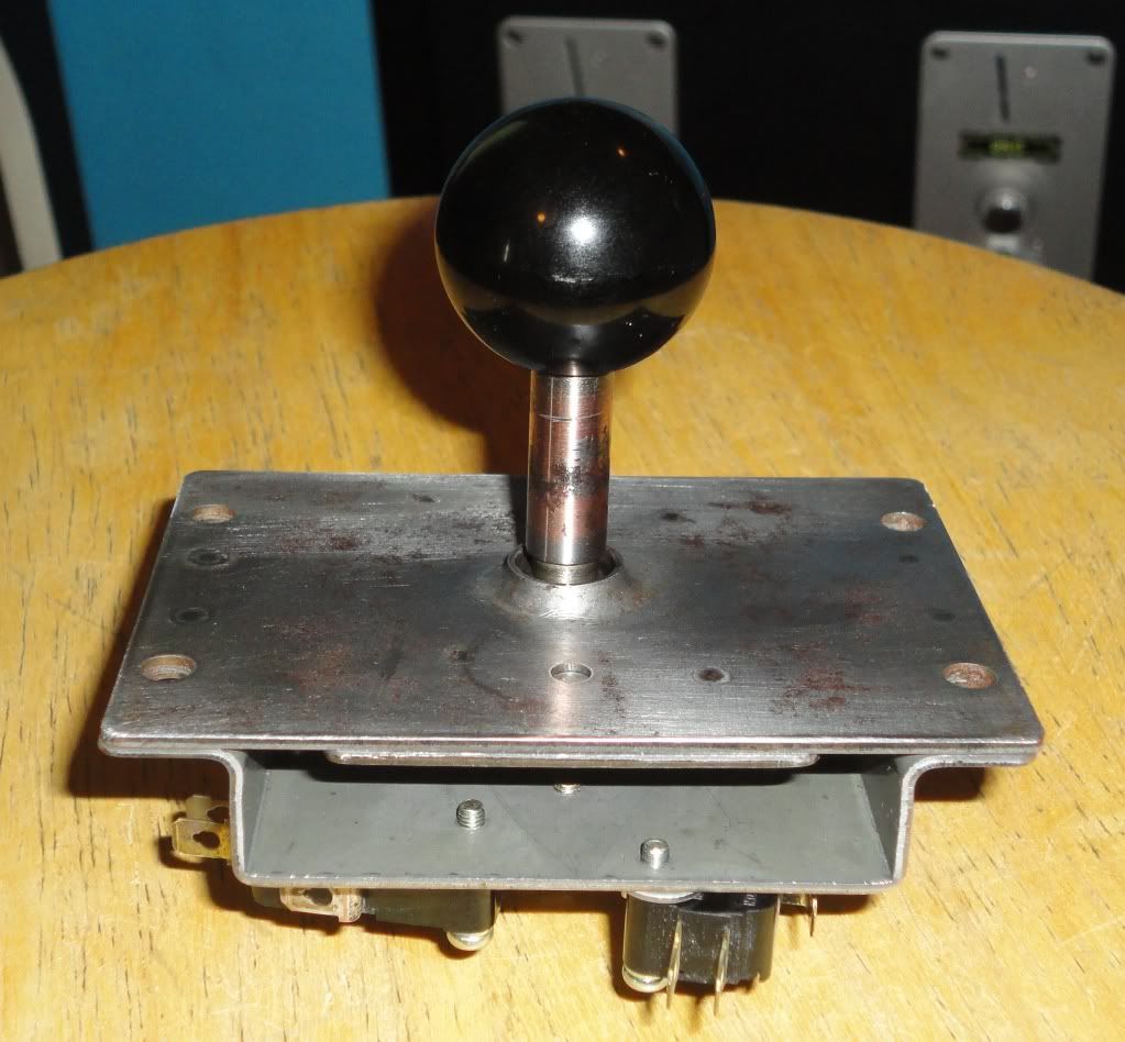

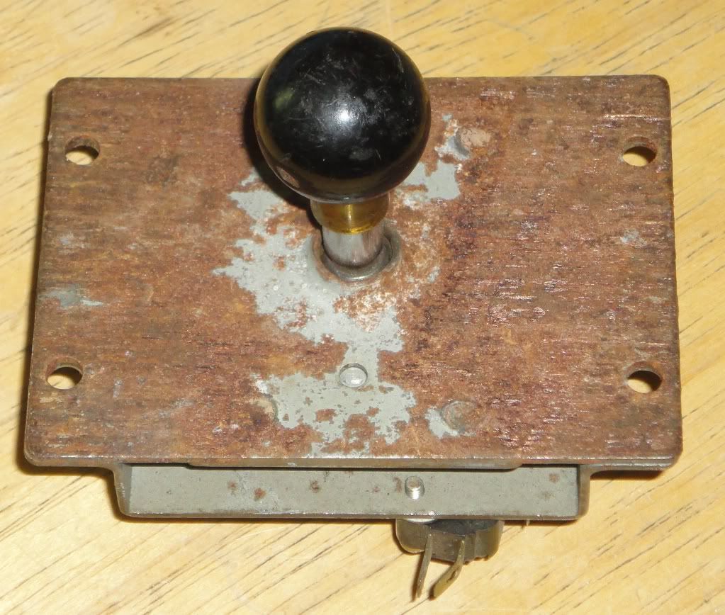

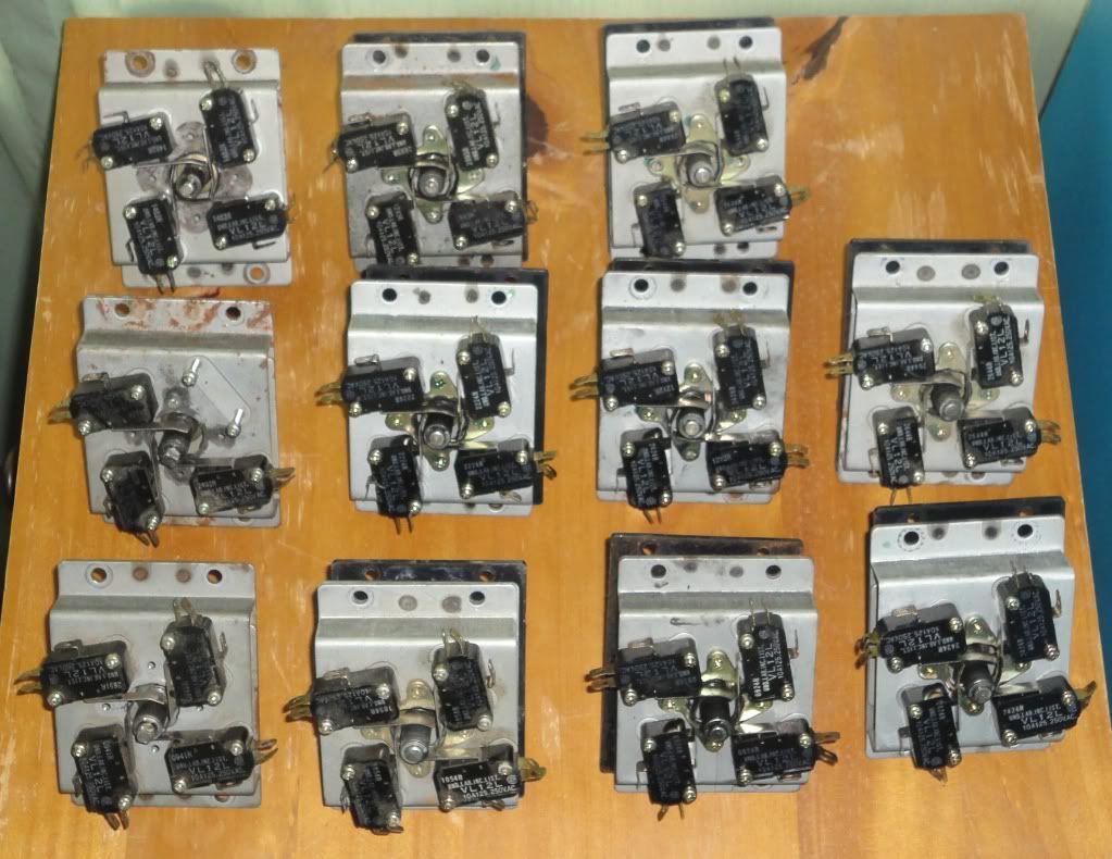

I decided to take on a new project when freeplayinc listed a bunch of Nintendo joysticks for sale. I cleaned up one of my joysticks I had in my parts drawer and it turned out pretty nice. I had a couple people ask me to post the steps I took to clean and rebuild these joysticks. Saturday the joysticks from freeplayinc came in the mail so I figured I would document of few of the rebuilds from that lot on here for others to see. Here are two pictures of what came in the mail...
Top...
and Bottom...
There were a couple of decent joys in there, but for the most part they were pretty trashed. I expected this (that is why I got a good deal on the lot). Most of the joysticks are 8 ways for VS, PlayChoice, Punch-Out!, etc., but there are a few DK joysticks in there. I pan to rebuild these and then sell them off giving people the choice of what joystick they want (i.e. 2-way, 4-way, 8-way, and 25mm, 28mm, and 30mm balltop with appropriate shaft). Some of the joys barely move and they don't return to center when let go of. Some are missing parts. All in all, this lot should keep me busy for a little while.

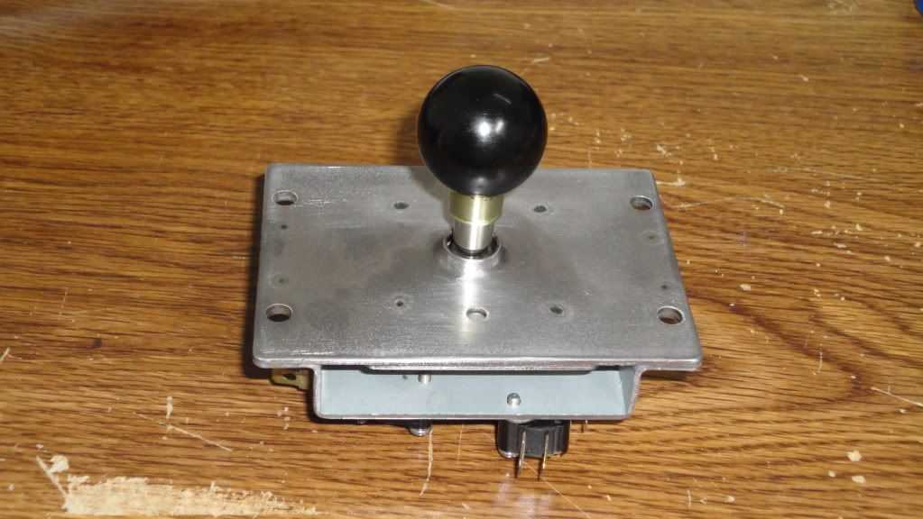

The first joystick that am I rebuilding is a 4-way joystick with the 25mm balltop that is used on Nintendo cocktail games like DK, DKJR, and POPEYE. Here are detailed before shots of the joystick...

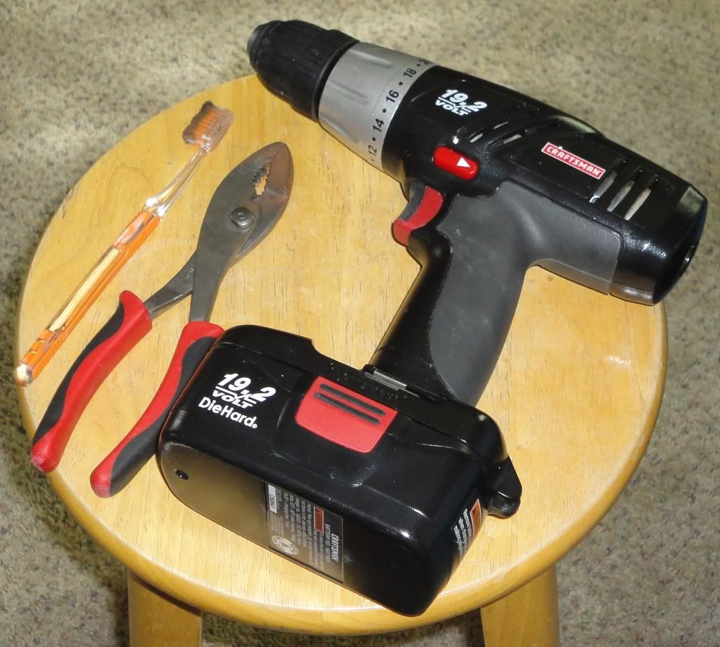

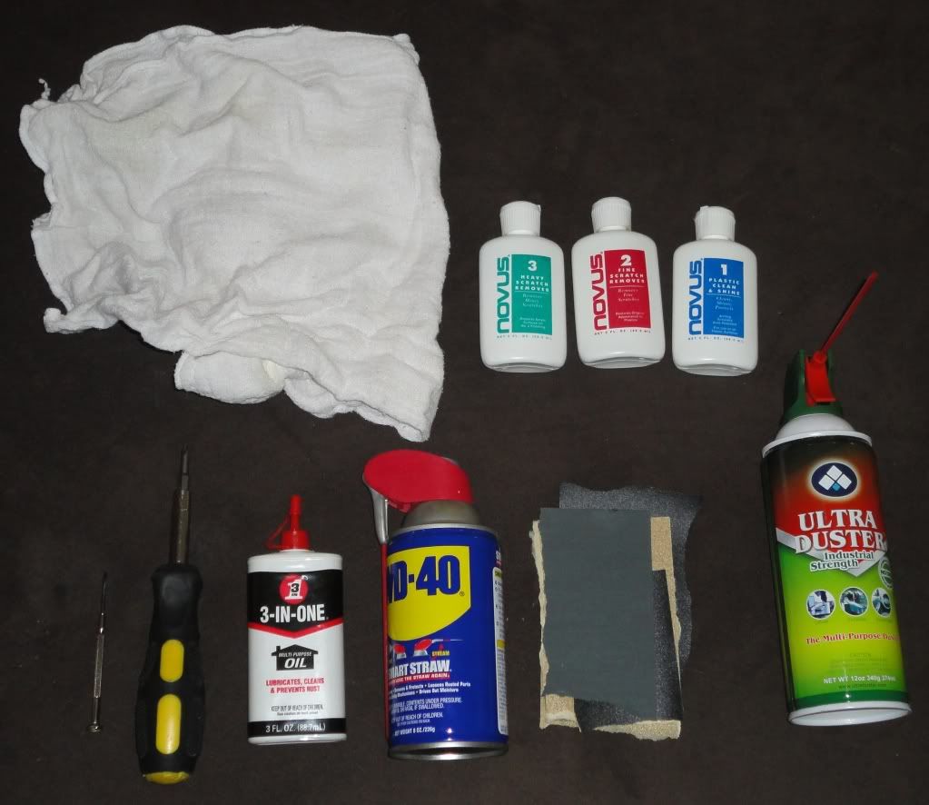

Here is a list of the materials I use...
Drill
Sandpaper (100, 320 and 1500 grit)
NOVUS 1, 2, & 3
Damp work rags
3-IN-1 Multi-Purpose Lubricating Oil
WD-40
Cans of compressed air
6-in-1 tool
Small flathead screwdriver
Pliers
Toothbrush
A lot of the materials I used can be replaced with other products. These are just the materials I use.

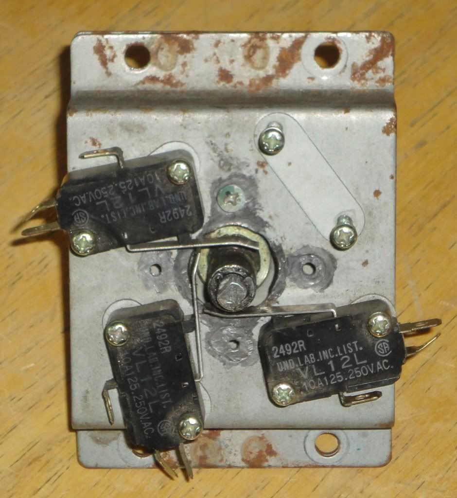

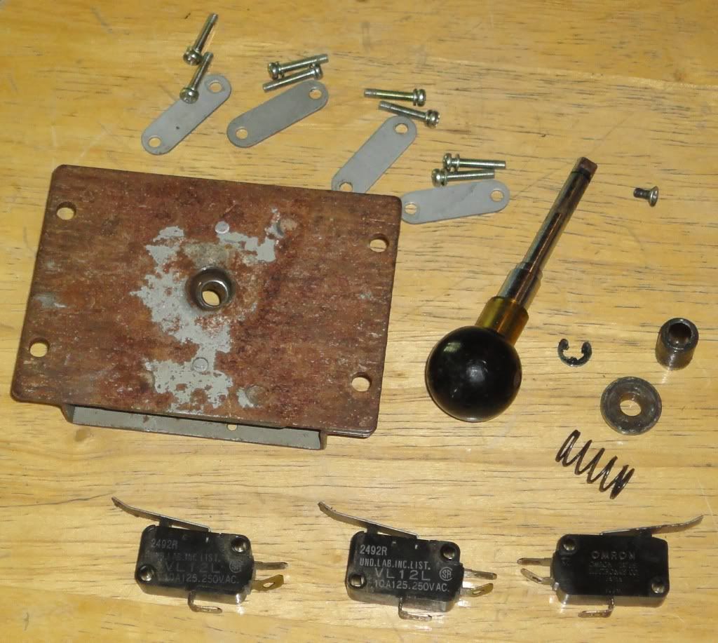

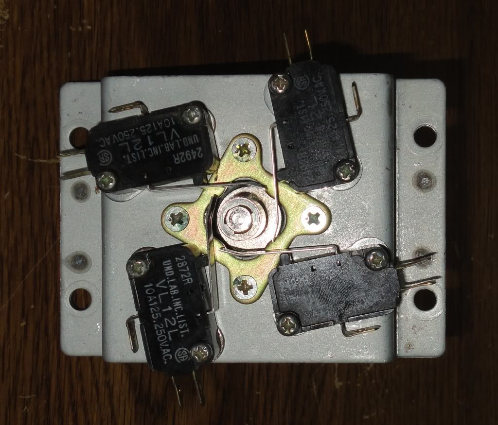

First thing I did was disassemble the joystick and see what I was going to need to do.
As you can see there are parts missing. I need another microswitch, a restrictor plate and 3 of the 4 mounting screws. I have those parts in a drawer and I plan to fix up the balltop/shaft. I decided to replace all of the microswitches with better ones.

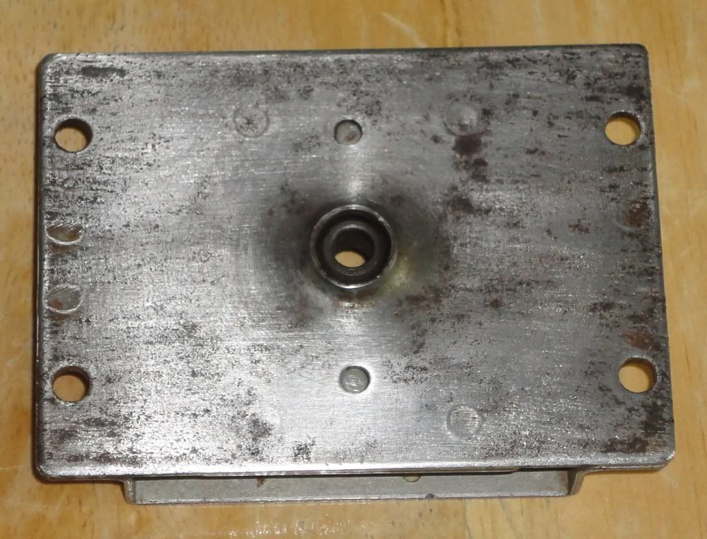

First thing I worked on was the base. It was very dirty and had lots of rust. I used the sandpaper to remove as much rust as possible. I then used the WD-40 to free up the ball bearing in the center. After the initil cleaning with the WD-40, I cleaned the base with soap and warm water. I dried the base off with a rag and used the compressed air to make sure all the water got out. I relubricated the ball bearing with 3-IN-1 multipurpose oil. Now the base functions perfectly and looks much better.

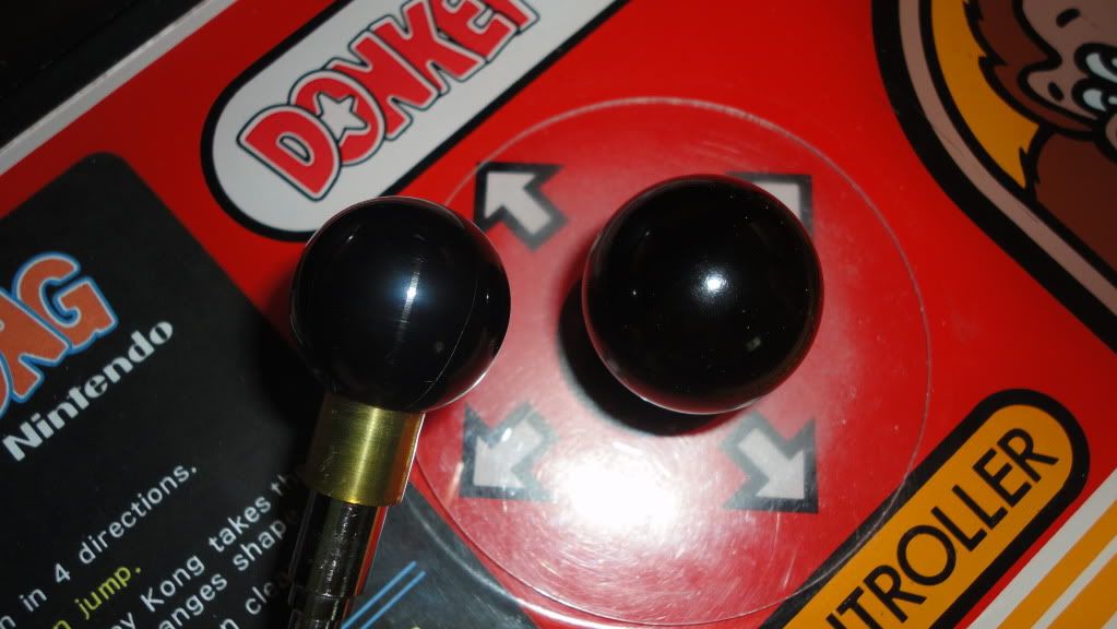

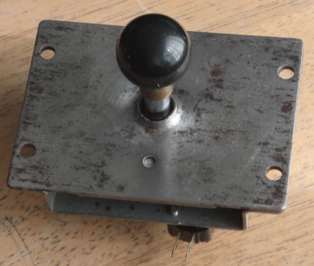

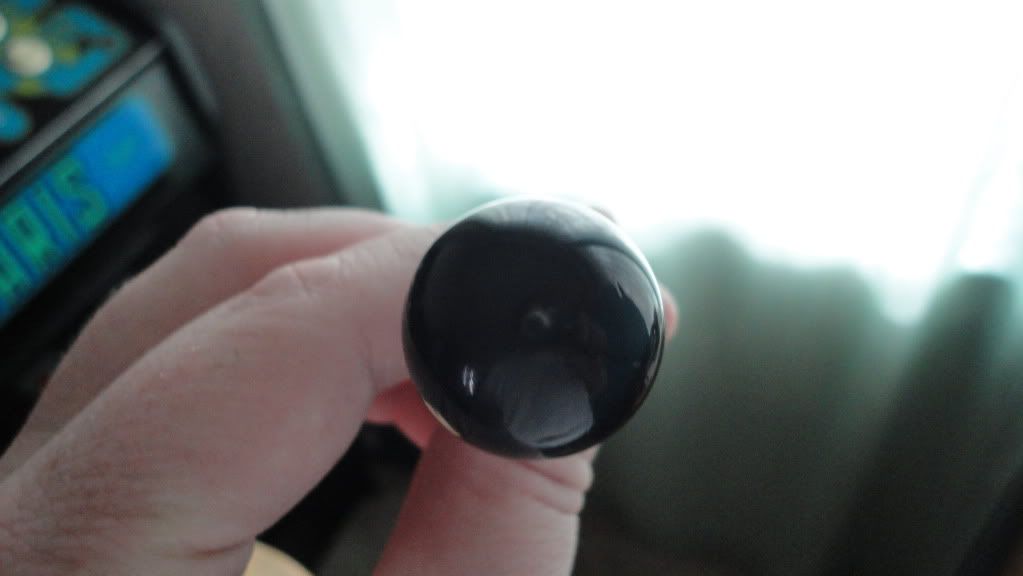

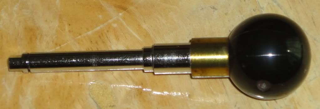

The next part I focus on is the balltop and shaft. I lock the jostick into my drill and clean it by rotating it in a damp rag. I then use he 1500 grit sandpaper to remove as much of the dings and pittings as I can. I then use the Novus 3, then 2, then 1 to polish the balltop back to sparkly...
Comparison of polished balltop to NEW REPRO balltop...

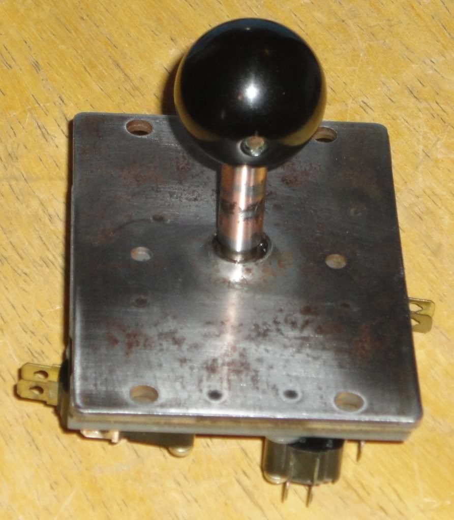

Lastly I clean the microswitches and reassemble the joystick. Here is the finished product...
I'm going to post more joystick rebuilds as I get to them, but I'll just be posting before & after shots.

I didn't have before shots of the first one I did, but here are the after shots...
...This one is a DK upright joystick with the 30mm balltop.
