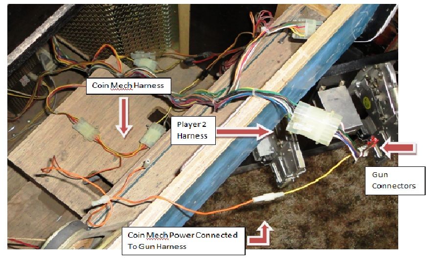

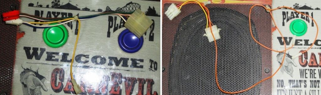

In an attempt to get this game complete, does anyone know what the second 5 volt line is for on a Nintendo gun harness? The schematics I have show only one connection and nothing for the second line. I have tried two different board sets and three different guns. I did the cap mod and have the blackness to where I think it should be.
It's been a while. I remember 1 under the control panel and the other was a long wire that pugged in around the board cage area. I think it was the alarm wire.
Rob
The power on the VS gun comes directly from the coin power...both 5V lines...
I have a quick write-up I did for someone a while back. It provides a lot of info as well as detailed photos of the connections and some other info. It's in a word document and it won't let me upload the file to the site. If you PM me with your email, I will send you the file.
This is a picture of a full VS Gun harness and a picture of it hooked up in a VS UniSystem. It's the same basic set up for the Red Tent just the coin mech is on the right and not below.
