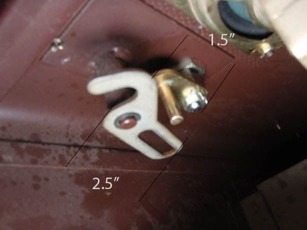

I have never actually seen the part that attaches to the lock to lock the top down.
Anyone have pictures? (or a couple for sale?)
here is a pic, that someone posted today, that shows the lock mechanism.
user oregonarcade has a bunch of old nintendo ct's he is parting out. he may have the parts you need.
Stealing my pics!! :p
shilmover let me know if you want a better picture of how the mech works
I would.
From what I gather, it looks like the regular lock cam with a pin that fits into the "hook" slot? would you mind measuring it too?
Those hooks and cams are pretty easy to make. I needed a pair for a Taito cab I was working on and made a set in about 45 min.
Just take a couple of the long pawls, drill a hole in them, and put a machine screw through them with a nut on the back side.
Works like a chanp, costs about $0.30 for the pair.
