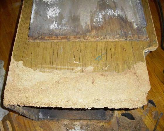

I need to perform some major surgery on a Nintendo cabinet and I wanted to get some feedback from the experts. The bottom 2 feet of the cabinet is water damaged and the Plywood is swelled from the very inside out. It is also chipped and flacking from being dragged around the floor with a missing base.
I want to cut off the offending wood and replace it with new but was concerned about some major issues:
1) How to reinforce the inside without getting too invasive and getting it back to as much factory original appearance as possible. I do not want the top and bottom pieces to seperate or crack the bondo filler if the cabinet is pushed or pulled to roughly. (My concern is that this game is toted around to conventions quite a bit and I need it to be able to handle being pushed and dragged several times a year by volunteers who are not as concerned about the cabinet as me.)

Hm, two feet of material is fairly large section to have to replace. I would likely consider cutting new sides if I had a cab that needed that much replaced, particularly if it had a dual monitor setup.
I had to perform surgery like this to replace the lower 6.5 inches on my Frogger cabinet; one thing the Frogger had going for it is that the design has reinforcements on the inside, so I was able to:
1. Cut out the bad section (chose to make both sides identical, for ease of making the patch panels
2. Install new wood to mimic the factory reinforcement
3. Use wood hardener in the section immediately before the location of the patch (the "good" wood still sucked up a bit of hardener)
4. Put about 10 dowels in each patch panel and make corresponding holes in the original side.
5. Put gorilla glue on the reinforcement, dowels, and the mating surface and slide together.
6. Add nails to further join the reinforcement with the repaired area.

Of course dowels duh. I have a doweling jig and for some reason it never crossed my mind. Sometimes I have a tendency to over engineer things; probably the engineer in me. This will most likely be the path I move forward with unless I decide not to do it and instead to live witht he current state of the cab.
