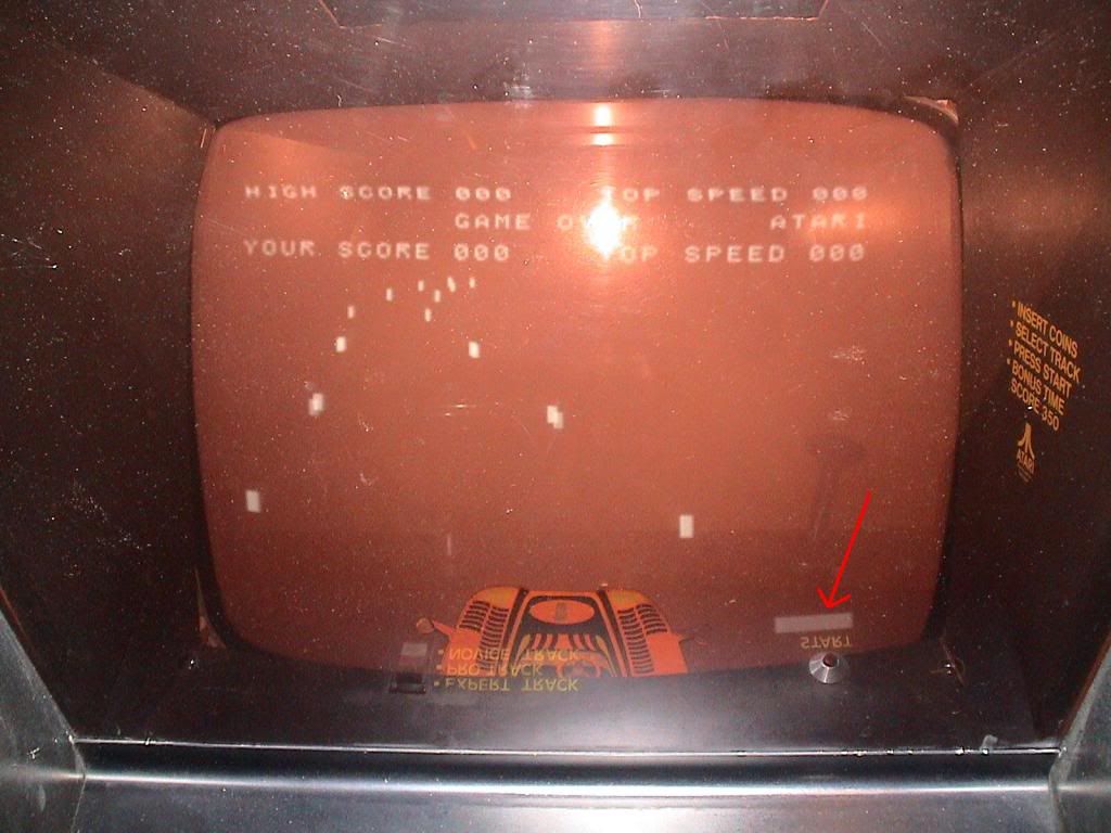

Here are the pic's,
The first is a pic of the screen with the working board plugged in...not a good pic...but as you can see, it's good.
This next pic is from the spare board I just got, you can't see, but the guide posts are very faint in the background...also top and sides of game are cut off.
Interestingly, the backlight is not being drawn under the car(to light the car decal up) ...that's it to the right (arrowed) and it's a lot smaller than it should be.....this is the same on both boards ??
I did also just notice that one of the 3 LEDs isn't lighting up on the bad board.

Oh, the images on the monitor, I see. My game does not have anything that displays behind the car decal. I do have a rectangular box on the lower right of the screen. It's there to illuminate a clear piece of tape that says 1976 Atari and is useful for adjusting the screen to the right height and width.

There should be three pots on the game pcb, the first is volume and the other two are to change the engine sound. One is for pitch and the other is for modulation (effect).
John, two of the leds flash on and off when you turn the steering wheel, you can ignore those if your steering works.
With a faint picture like that I'd have guessed something on the video line is sad, but the edges chopped off, I dont know..
Someone said the uv light washed out their screen? It's supposed to, you adjust the cardboard flap so that the washed out section starts where the track disappears.. Its supposed to be a night time horizon.

I'm also keen for information on the white box (aka backlight in the manual) as johns machine used to be mine and that was one of the final two details left to do in my restoration of it which never got finished.
My friend and I managed to resize the box and move it around, even create multiple boxes.. But we never got it to fit nicely behind the car decal.

I would agree with "ifkz" about the white bar in the lower right of the screen. My sitdown Night Driver still has that clear tape decal that says "Atari 1976" on it and the box lines up behind it.
I guess the pcb wasnt broken at all:/
thats very strange that they decided to illuminate the branding rather than the car.. especially since their documentation says the car should be illuminated by the box.
when I restored the pcb to the original traces (having the box in the bottom right is a factory modification using a heap of wire and lifted pins) the box was behind the car but too skinny and way too long. My guess is that the factory schematic was wrong and this is what they decided to use it for.
moving the box to fit behind the car decal looks like it will need extra logic gates, the size you need is kindof between two increments. I'd say this way was cheaper without wasting the whole backlight section of the pcb.
