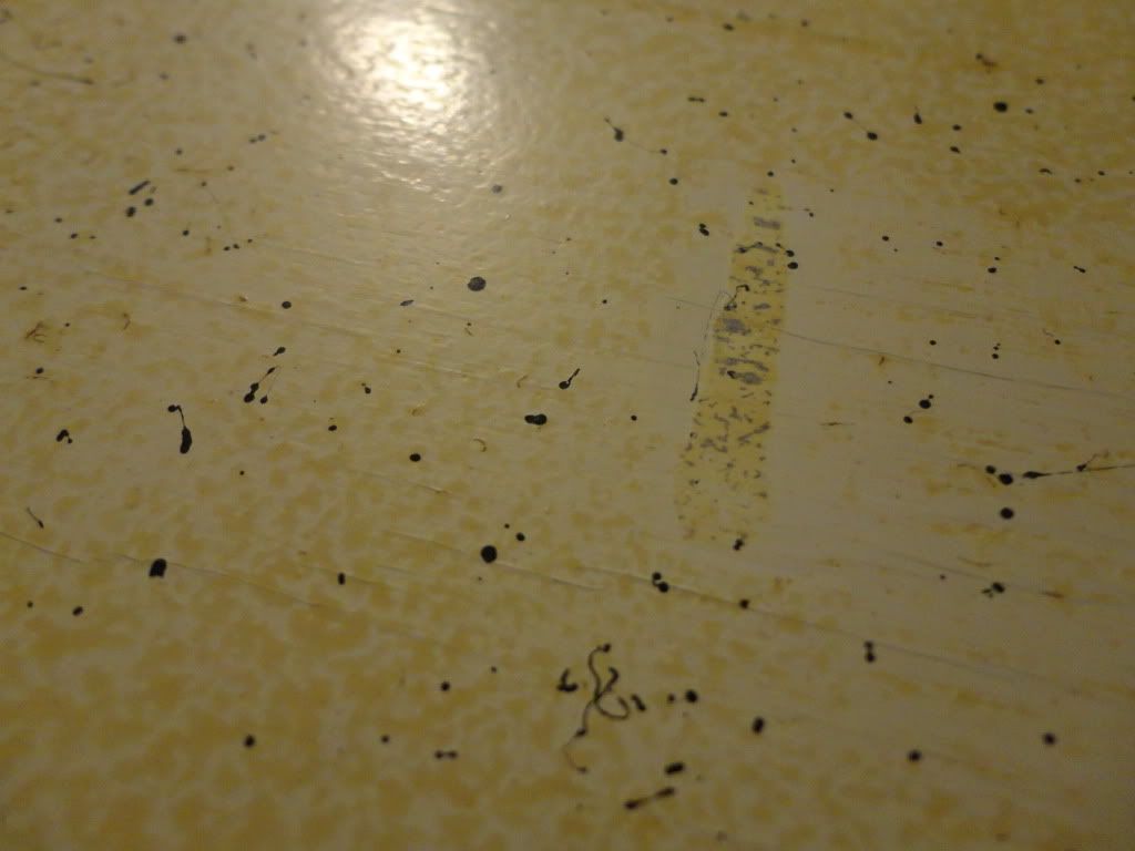

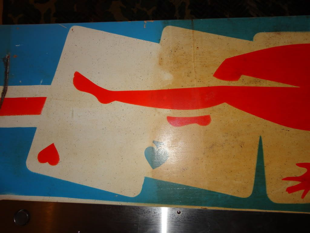

I am trying to remove cigarette stains from my next pinball restore and I am having a hard time. After searching here and on Google I have tried about everything. I have been using Westley's because that is the only thing so far that will even touch it. I saw someone trying white vinegar, has anyone tried that? The first layer will wipe right off with Westley's but wont do much after that. I figured out that if I wet it down and let it sit for about 5 minutes then scrub like hell with the back side of a scrubber sponge I can get a little more off. Here is a couple pictures after about an hour and a half of work. At this rate it will take a week to get it to a place where I am good with it. I thought about wet sanding with VERY fine sandpaper like you use on car paint and Westley's. The top of the back box is almost black.
If you look close you can still see that nasty crap even after scrubbing like hell.
No, this is not a lighting trick, thats how bad it is. This machine must have been in one nasty bar.
Any other ideas?
Thanks

The cabinet and paint is in great shape if I can get the crap off. I would rather have original paint with a little "character" than a new repaint. I just cant take black where it is supposed to be white. I used all the Westley's I had yesterday so I will have to get more and will get some vinegar and try that also. I tried 91% alcohol and it just laughed in it's face. I also tried Windex, 409, A light rubbing compound for the car and about everything else I had under the sink. So far no joy in nicotineville.

Try Magic Eraser (melamine foam) and rubbing alcohol. Works wonders for playfields and is usually gentle, unless you go too far. I would 'just' rub until you remove the staining then stop, or you'll burn through the finish. That lacquer paint probably isn't very thick.
I had one like that, I used Mean Green degreaser, $1.00 a spray bottle at the dollar store, smells like a combination of chew spit and gypsy tears but it drilled it when simple green would not, I used a magic eraser. When it was difficult in an area, I would let a rag soaked in it sit for about 30 seconds, came right off with the magic eraser... then went back over it with simple green to take of the dookie smell.:D
