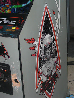

Earlier this week, I won an ebay auction for a "XX Mission" jamma game. I bought it solely because it was in a Midway Mini cabinet . I have a fondness for that cabinet style, and wanted one with a vertical monitor - possibly for a 60-in-1. I could tell by the bezel and control panel in the auction pics that this cab had originally been a Solar Fox.
Well, finally made the two hour round trip this morning to pick it up. When I got home, I found that it had definitely been a Solar Fox mini. The cabinet tag was still stapled inside, "SFX-MINI No. 0272". Still has the original K4800 13" monitor (works, but needs a cap kit). JAMMA conversion was fairly well done - by Operator standards, that is. It needs some help to bring it up to my standards. Original AC harness is pretty much still all there. MCR harness is completely gone as is the big transformer and original power supply.
The nice surprise was when I started looking at the control panel and marquee. To convert this game, the Op had just taken cheap marble-pattern contact paper and stuck it over the cp and marquee. It pulled right off and didn't even leave any adhesive residue. What was underneath? The original cpo and marquee! The marquee is gorgeous, the bezel is in fantastic condition. The cpo is in decent condition other than missing material across the front corner.
The attached pics show what it looked like when I got it home, and what it looked like after removing the contact paper and doing a little cleaning.
Now, just what should I do with it...

I toyed with the idea of unconverting this cabinet back to Solar Fox. Sellers seem to think that Solar Fox board sets are gold-plated or something! However, I picked up an untested "Kick" board set for next to nothing ($10). It would only be an eprom swap away from becoming Solar Fox. I was still lacking transformer, filter, power supply, wiring harness... So this project sat in the garage.
Then, I played Solar Fox at CAX. Meh. Just didn't enthuse me. So, about ten days ago, I decided to tackle this project and follow my original plan of a minor cosmetic restoration and installation of a 60-in-1 board that I had on hand.
External work was fairly minimal. Clean it up, new t-molding, new leg levelers, fill a few holes. Since it was in decent shape, I decided to leave things original and not repaint the coin door, marquee brackets, and such.
Internally, the AC wiring and power distribution wasn't up to my standards, so I tore it all out and redid it. The JAMMA harness was fairly well done. I did rewire the coin door and the speakers. Only one speaker was connected, so I wired both in series for an 8 ohm load. I ran power to the coin door and marquee lights and replaced the marquee bulbs with LEDs. The monitor got a cleaning and a cap kit.
I completely disassembled the control panel, rebuilt the original joystick with a new centering grommet, and put in new leaf switch buttons. I did make one modification - two small player start buttons above the joystick. I used the same style buttons that Midway did on cocktail and some mini games so that they'd look appropriate. I did trim away the battered overlay at the front bend and around the joystick and painted those areas.
Anyway, here it is. It'll look right at home in my row of Midway mini cabinets.
