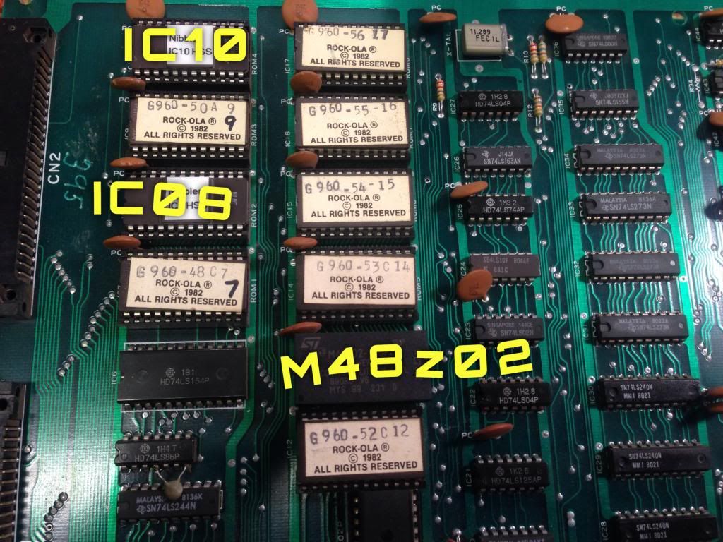

Finding the hooks for doing a high score save kit was pretty trivial... Mine will be a CPU module to eliminate all the ROMs, and use a serial EPROM to save scores rather than relying on a DS1220.

For a "kit" consisting of a NVRAM and two custom-programmed EPROMs: $25, plus $4 for shipping in the US (any other shipping TBD). This will be "plug and play" if your IC13 is already socketed.
For those wishing to supply their own 2kB NVRAM and program their own EPROMs: $10 code fee for the ROM files.

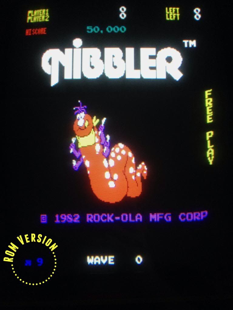

Thing is, there are three different documented (in MAME) versions of Roco-ola Nibbler: 6, 8 and 9. The code is at different places in different versions, so there are actually 3 different kits.
I really have to know the version in order to be able to program EPROMs that'll work with a specific version of the game. Same goes for providing the ROM files for the DIY option.
There are two known ways to determine your version, both mentioned earlier in this thread:
-pull your IC12, read it, and use a romident tool to see which version it is from (IC12 is different in all versions of the game)
-hold the joystick down during attract mode and watch the lower left corner of the title screen for a jumber beside the "JU".

Forgot to post these pics. They were edited on my phone so I didn't have much to work with.
Here's where you see the ROM version (in the circle at the lower left). If you hold the joystick down in attract mode when the "grid" dissapears to reveal the Nibbler, it will show a number after the JU. In my picture below, I have version 9.
Here's the IC's you will need to replace. Two 2732 EPROM's at IC08 and IC10, and the 4118 at IC13 gets replaced with the M48Z02 nvRAM.

There are three different known versions of Roco-ola Nibbler: 6, 8 and 9. So there are actually 3 different kits. You need to determine which version you have/need/want in order for me to give you the right thing for your board.
There are two ways to determine your version:
-hold the joystick down during attract mode and watch the lower left corner of the title screen for a jumber beside the "JU" (see photo a few posts ago)
