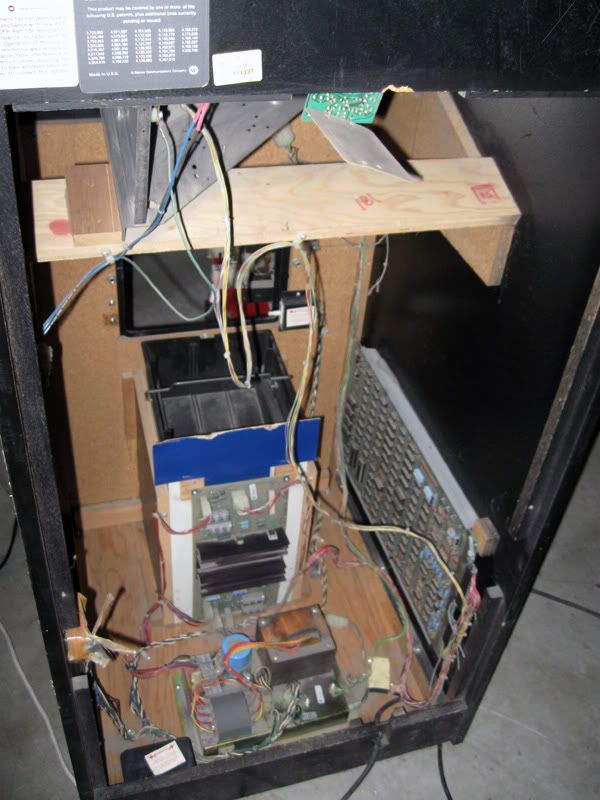

The next Centipede is a non-working `pede... this particular cab was inaccessible until yesterday evening. I'd not even plugged it in. It was with great trepidation that I plugged her in... and amazingly enough, this cab has all 3 prongs on the power cord. Well, the machine fired up... mostly. I got the coin door click... upon coin up I got flashing Atari LED lights... and when I pressed P1 start I got... CENTIPEDE NOISE! Woot! It appears the machine is playing blind! After pulling the back off I noticed immediately that the machine was MUCH MUCH MUCH cleaner than the other `pede. I also noticed there is an Electrohome monitor in it. After checking for AC, sure enough, the monitor is getting power.... but not powering up. My guess: blown fuse on the chassis... likely the smaller one in the middle...the one on the back side looked fine from what I can "see". This is certainly nothing a Bob Roberts kit couldn't fix... I am going with the deluxe kit and replacing the flyback I think... just in case.
Well... to be sure the PCB was operating correctly, I pulled it from the non-working cab and dropped it in the working cab... it worked! NICE! High scores are all still saved too... the PCB from the working cab has a high score of around 350,000 while the PCB from the non-working cab has a high score of around 56,000. My guess is that Centipede was one of the first to "die" and get stuffed back in the "garage" of the place I picked it up from. To do: Fix the monitor chassis... replace the CPO... clean her up a bit. Everything else looks great!
EDIT: Here are some photos...
She cleaned up pretty nicely inside. It's sure nice not having to deal with mouse piss or crap...

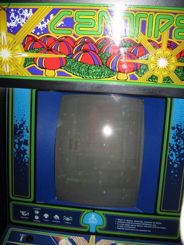

The monitor looks good in semi-dark to dark lighting and on. If you put the monitor in direct light you can see the semi-substantial burn. I can make out Centipede and what MIGHT be Rampage?? I am not sure...
Here is the control panel... it obviously needs replacing. Since this one I am selling, I am not sure what I am going to do. I doubt I'll get $50 more than I would otherwise if I do replace it. I am considering offering it up for $400.00 as-is ... and offering the option for me to install a new CPO for $60.00 and/or a new monitor for $225.00... of course KLOVians would get a "cheap bastard" discount on all those rates.

...in any case, I pulled the monitor from the non-working `pede and both fuses meter fine in-circuit. I will have to desolder them to determine their out of circuit condition. What else would cause "nothing" with full AC power to the chassis?
Definitely agree about the cpo - don't bother unless they pay extra for it, you won't recoup the cost especially in these times.
is the blind pede as clean as that one, frizz? i'd say that's a good deal for $400. you could always offer it both ways, as is or with a new cpo/monitor/rebuilt trackball, etc.

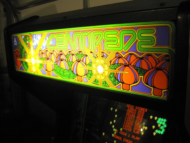

Now back to the `pede... here is how the marquee looks lit up. Beautiful!

I pulled the chassis and the small fuse is blown...which means I have a bad HOT, or fly or something I am guessing. Luckily, I have a known working G07 chassis to replace it with (after rebuild of course).
Nope...when I said nothing, I meant nothing... no crackle at start up... nothing.
Yeah, and if that small fuse is blown, that large cap almost certainly has a charge. :) Man I discharged it one time with a screwdriver and it scared the crap out of me. The loud pop and giant ass sparks were quite the surprise. I think I would use an HV probe next time for less drama.
