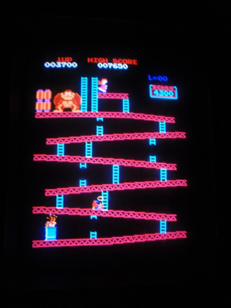

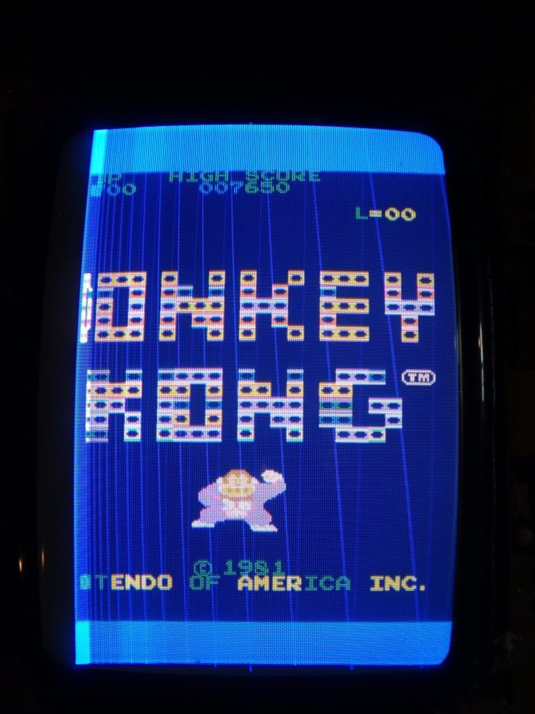

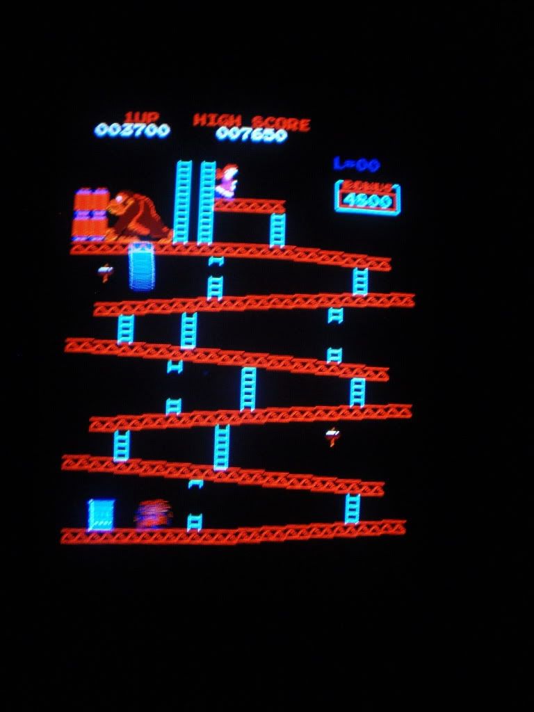

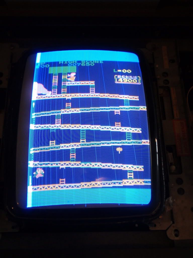

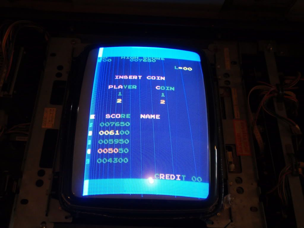

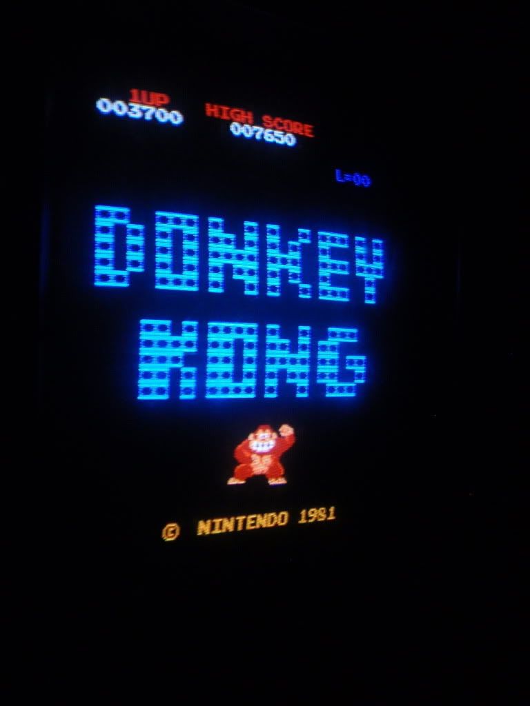

OK I took today to clean the inside of the cabinet and cap the monitor. Capping helped the fade and lines, but didn't help the colors, so I swapped in a new board, but I couldn't get it to sync. Took the CPU off the original boardstack and paired it with the second boardstack and Success!! Went from this:
to this:
from this:
to this:
And from this:
to this:
Now of course I noted the title screen difference, so did I upgrade away from the ladder cheat, or revert back to it by swapping the CPU's? Also, neither board was in cocktail mode. Which dip switch corrects that on the 4 board stack?

Neither. The CPU had nothing to do with it. The "cheat" code is in the 4 main program roms on the cpu board. Basically one of your boards has it, the other does not. The one you currently have the CPU in has the ladder "cheat," the other board you pulled it from has late revision roms (no "cheat").
Huh? If the 4 program ROMs on the CPU board contain the cheat, and I swapped out the original CPU with the one from my extra board stack, how does the CPU being swapped have nothing to do with it? Seems it has everything to do with it.
By "CPU" I literally mean the CPU chip itself, not the CPU pcb (1/4 of the stack). If you swapped the z80A alone (which is how I interpret it), then apply my statement. If you actually swapped the CPU pcb, then you have up/downgraded TO the "cheat" by doing so.
Again, it's in the 4 main program roms (2532's), so it should be pretty easy to figure out what you've done, regardless of my interpretation of your swapping efforts.
This, and that's what I thought. I meant the entire CPU PCB. The colors were wrong on the original, and the xtra stack wouldn't sync. I essentially made one stack from 2, and in the process, downgraded to the ladder cheat. Sweet. Now I'll send the other stack out for repair. Now which dip controls cocktail mode? Anyone know?
