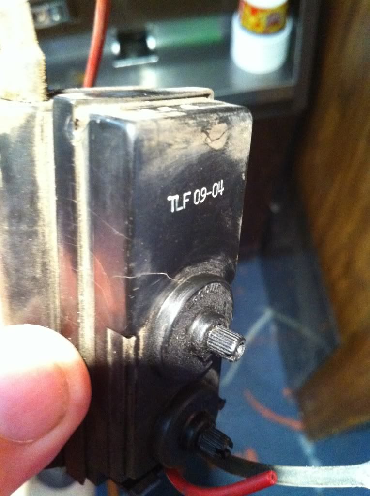

The white know flybacks are prone to cracking and the resulting arc can damage anything including someone adjusting the pic. I always replace old K7000 flybacks.

Is it worth installing a used fly? In many ways I hate taking a working one out, but everyone is pretty consistent in saying these white knob ones fail in a spectacular and destructive manner. My BR order arrives tomorrow, hopefully the Q2 & Q3 are bad, easier fix than the IC1. :D
I have seen the black knob flybacks fail as well. It is really only a matter of time, from what I have seen they appear to overheat with use, causing the casing to get brittle and then it cracks. Once the insulation cracks then the fireworks begin. Personally, I would just install a new flyback but depending on use the old fly could suffice.

for $30, its cheap insurance to just replace the damn thing. DO it, get it over with, dont worry about it for another 20-30 years.

If the old flyback works and shows NO cracks around the knobs, then go ahead and use it. If you see even a tiny crack, replace it...
Uh, yea, you nailed that one. One wipe of a rag and no doubt it won't work. I feel a lot better about replacing it now!!!
