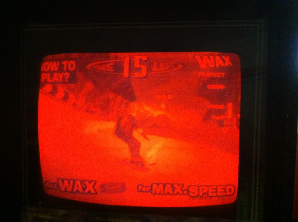

I finally got around to working on the chassis.
I did the shotgun approach, not happy about the rectifier diodes as they all turned out good and are 5A vs the 1N4007's 1amp rating.
Would anyone reinstall the old, or go ahead with the new lower current replacements? This is a 25 inch K7000 (2A main fuse)
I replaced the flyback, VR, HOT, and installed a cap kit.
Trying to get everything while the chassis is out.
Not sure what in the heck I was thinking, newb move as you gave me the answer.
Plugged it in, fuse popped and the new HOT is gone.
NOW, I read closer and follow your advice on C38, shorted.... dammit, answer was right in front of me!

Well, back to the issue.
Monitor now fires up to a red tinted screen, no pot adjustments on the neckboard help.
So at least the fuse blowing has ceased, HOT was bad and cap C38 was shorted.
Made it to the last step in the flowchart.
Anyone know what the "Substitute 1C1" means?
Any pointers on the next step will help, do I replace all 6 transistors?
(or just red, or just blue/green?)
Thanks again!!!
Substitute IC1 means replace it, preferrably with a known good IC from another chassis.
Have you tested the tube yet? One color overwhelming the others is often a tube problem, and can usually be fixed with a rejuvenator.
Other things I have seen cause a color to appear shorted are the wrong parts (transistors specificly) installed previously and a shorted component in the color circuitry. Luckily, when troubleshooting color problems there are two almost identical circuits to compare your results. Swapping parts from one circuit to another is a good way to see if the problem follows, just make sure and swap one component at a time...

Don't suppose you've got another 25" K7xxx chassis you can borrow a neckboard from? That will rule out the neckboard as part of the problem.
To rule out the chassis as the problem, swap the neckboard from your 25" chassis to your 19" chassis and plug it into your monitor. Sure your image will be tiny on your 25" tube, but if the red problem goes away, then you know the problem isn't the neckboard, it's the 25" chassis.
To narrow even further, place your 25" chassis on the 25" tube with another 25" neckboard. If the issue goes away, then it's your 25" neckboard.
If the issue persists through both experiments, then it's likely a short in your tube's red gun. Get ahold of a rejuvenator and see if you can recalibrate the CRT guns.
If you have another working chassis of this type, swap the neckboards to verify the issue is on the neckboard. Then swap the red drive transistor with the blue one to see if the image changes to all blue. If so, replace it. If not, then report back.
BTW - if you unplug the 5-pin blue/white wire connector near the flyback that connects to the neckboard, does the red go away?

No retrace lines on that pic that I can see....I don't think it's tube related. My best guess is the neckboard.

I read somewhere that color that extended outside the raster field is typically an H-K short, and the screen shot certainly seems to be edge-edge. Pull the neckboard and check for an H-K short.
Actually, a chassis short can cause that too, as it overdrives the gun...
Lots of good advice from everyone!
The red does go away with the blue/white cable unplugged. It was a black screen with occasional flashes (still had red tint in the flashes).
I swapped 201 and 202 on the neckboard with no change.
I do have another 25" K7000 in my Neo Geo, due for a cap kit anyway, so I'll pull it and try to rule out the tube.
Well, the flashes may indicate a need for rejuvenation, but if the problem was the tube, the red would have stayed when the blue/white connector was unplugged.
Your next step is to check Q1 on the chassis (2N3904's are cheap, so you may just want to replace them). You can always swap it with Q2 if you want to verify it's good or bad (screen changes to all green). After that, replace IC1...

Tube is now confirmed good, I pulled the other monitor and swapped chassis's.
The picture came up normal with it.
OT, my other chassis (dated 1990) has the white knobs on the Flyback.... (see pic)
Never had an issue with it, plan on installing a cap kit while I have it out due to slight curl at the top.
Would anyone change the flyback as I hear the white knob versions are a bad deal.
Only part is, I really don't have a spare fly right now.
Back to the original chassis, I replaced Q1 with no change, but need to replace Q2 & Q3 as I have a sneaky idea that red is actually the only color that IS working (only had one 3904 on hand). I disconnected both green and blue inputs and no change to the picture. I ended up ordering (12) 3904's from Bob Roberts at 25 cents each vs RS's $1.19 each, maybe should have supported them, but I needed some additional cap kits too (extra 3904's are for a WG4600 chassis).
