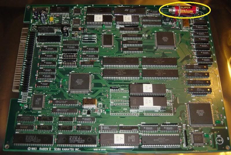

Anyone know if my Raiden II PCB is not saving high scores because it needs a new battery? Can I just replace it with another 3.6v battery or does it need to be a special kind?
Probably. Looks like a Lithium and looks to be soldered. Pull it off, take it with you to a Batteries plus or something like it, and get a new one...
