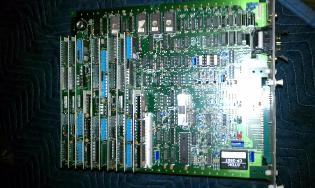

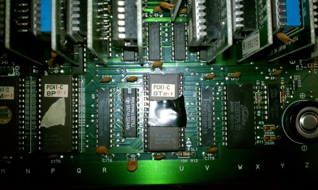

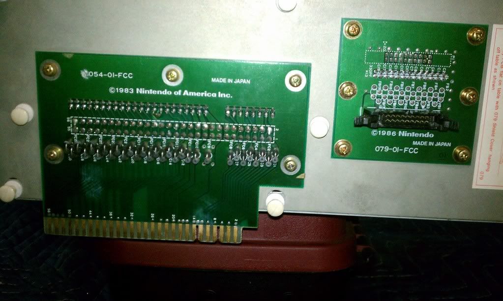

This post I will focus on the motherboard. He is working with a Dual Monitor motherboard. Here are the pix that were supplied...
These pix show that the motherboard is untampered and hooked up correctly. There are no fnacy jumper wires added like in a few PC10 MOBOs that will play a set of 5-in-1 games. He is also running ORIGINAL BIOS (I can explain this assumption better in the next post).

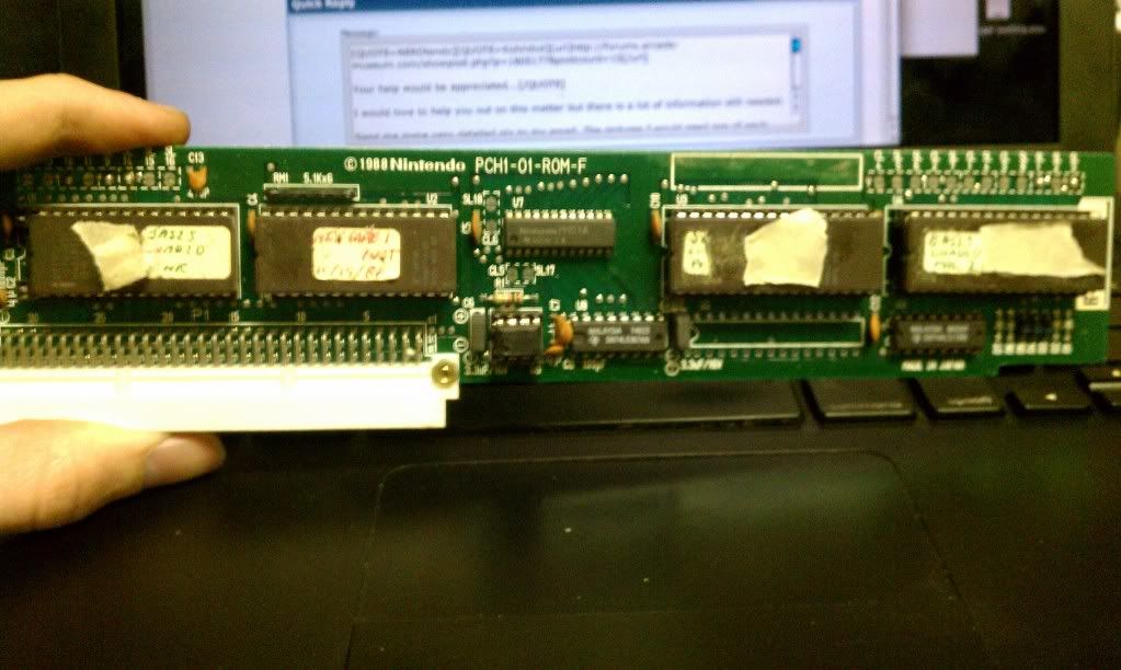

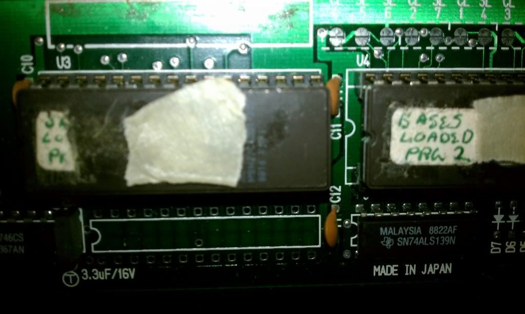

Here are the detailed pictures of the Bases Loaded game PCB...

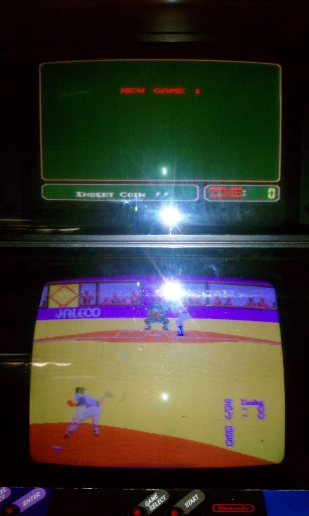

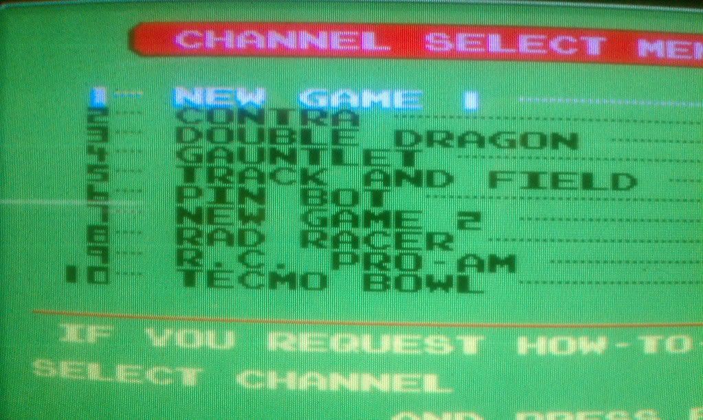

Here are the pix of the Game Select Screen and the Bases Loaded game running...
From these photos you can see that the PC10 he is running them on has an ORIGINAL BIOS because they say "Insert Coin!!" and the timer reads 0. CUSTOM BIOS chips don't allow for coin play as they use the coin door switches in their game name customization functions so it will always say "Free Play". The Bases Loaded game has all of it's chips including the 8 pin security chip which are made specifically for each title. That's why if you have a custom name rom made and run it in a CUSTOM BIOS MOBO you have to pull the security chip for the name to display without having to manually input the title into the Game Select Screen. Also, you cannot modify the instruction screen with CUSTOM BIOS. The instructiions are programmed into the EPROMs and no one has been able to code in custom instructions as of yet.
Based on the pix provided and the information gathered, it looks to be a legitimate PROTOTYPE cart.

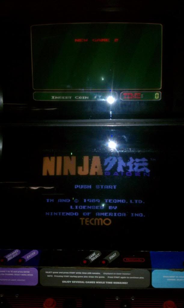

NINJA GAIDEN PROTOTYPE on KLOV...

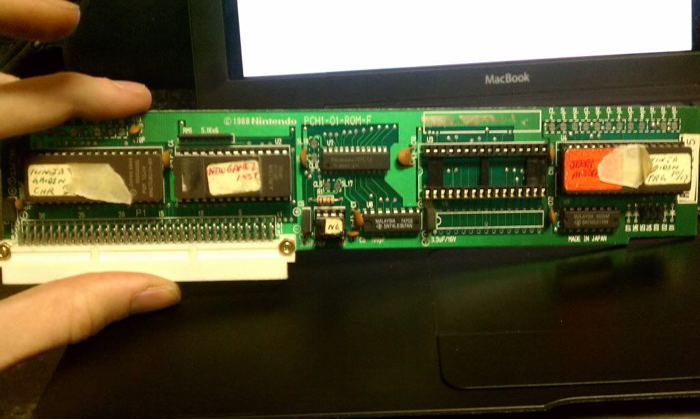

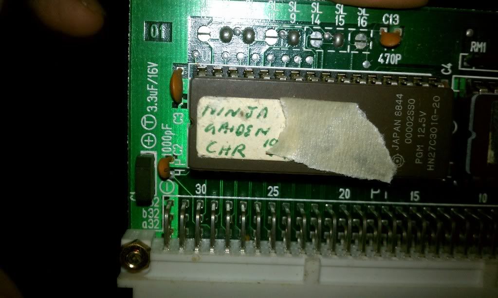

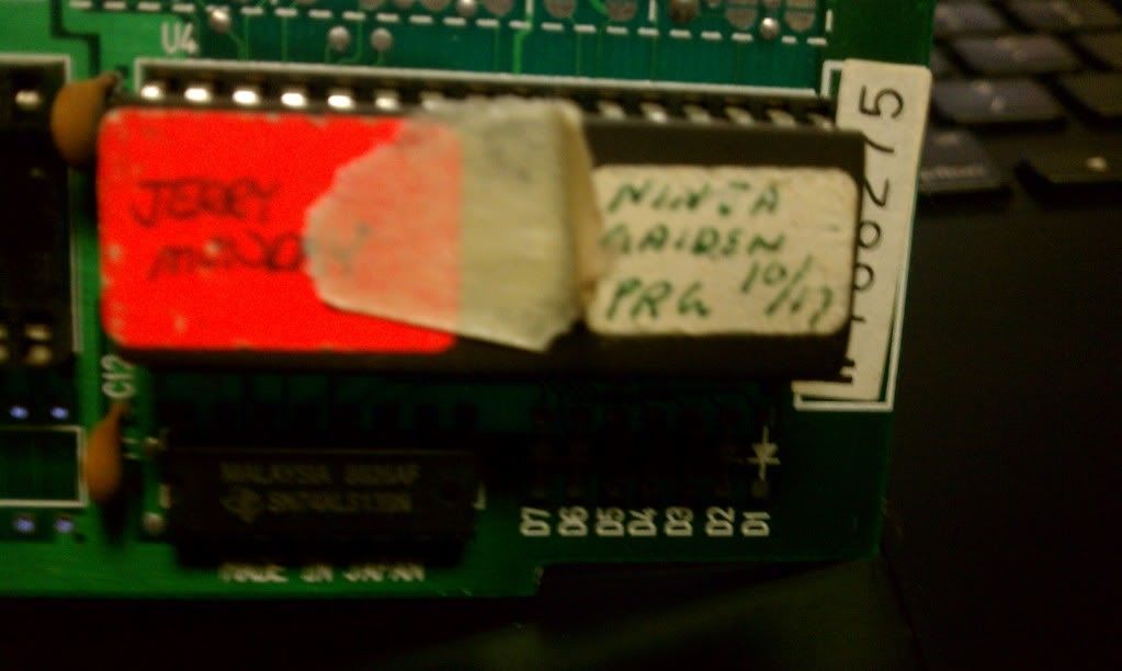

Here are the pix for the Ninja Gaiden cart...
This game displays all of the same characteristics as the Bases Loaded cart. I do believe this to be a legitimate PROTOTYPE game cart as well.
