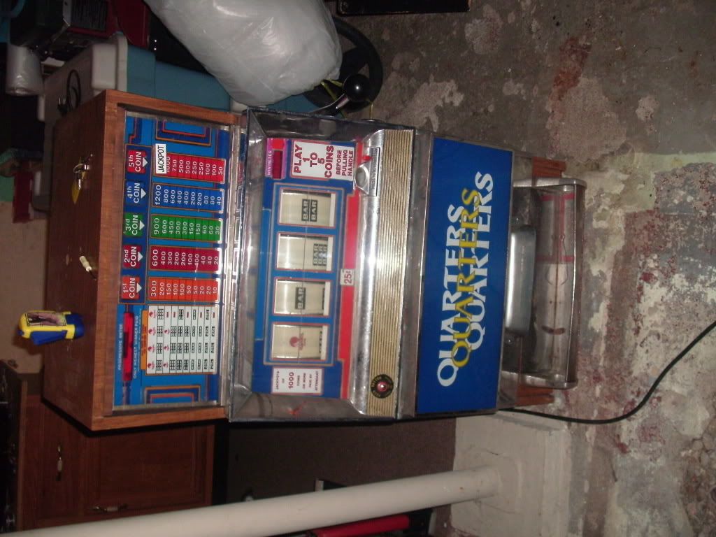

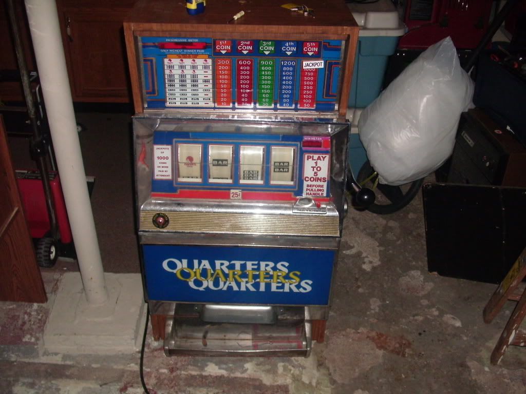

well i just got this all lights up but it says tilt and the rells will not spin. any help
i have all the key here are some pics of it.
Open the door, pull the reel assembly out and make sure everything moves freely. If there is old grease it will gum up and bind parts.
Also, the spring that pulls the reel stops in is probably in need of replacing.
As for the tilt, check the tilt switch 1st and make sure its not stuck. ...Its probably on the back of the door.
thanks for the help reel where not in all the way. tilt light looks like the switch the key uses is not hitting right but i dont know. but i dont like working on pinballs or this type of slot so first 225.00 or 3 working 19 in monters for my projects gets it. you got to pick this up i cant ship it.
thanks mod helped
ok new pain pulled reels hit reset buttons in side reels harden up a buzz sound then insert
coin comes up. i coin up close door spin rolls good firm hits then tilt. any ideas im new to bally slots.
Make sure those reels are set in their properly so they can't move around. Check the pins on the back of them that go into those plugs to make sure none are bent, broken, or dirty...
thanks to all who helped up and running most of the time now. still need to go though this but hey it works what else could you ask for.
