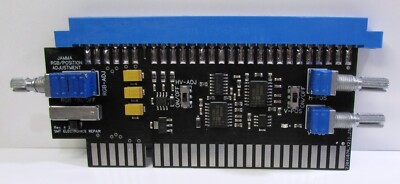

I have have always wondered if this would make switching through PCBs with a switcher more effective.. I've never tried it but for 55 bucks
